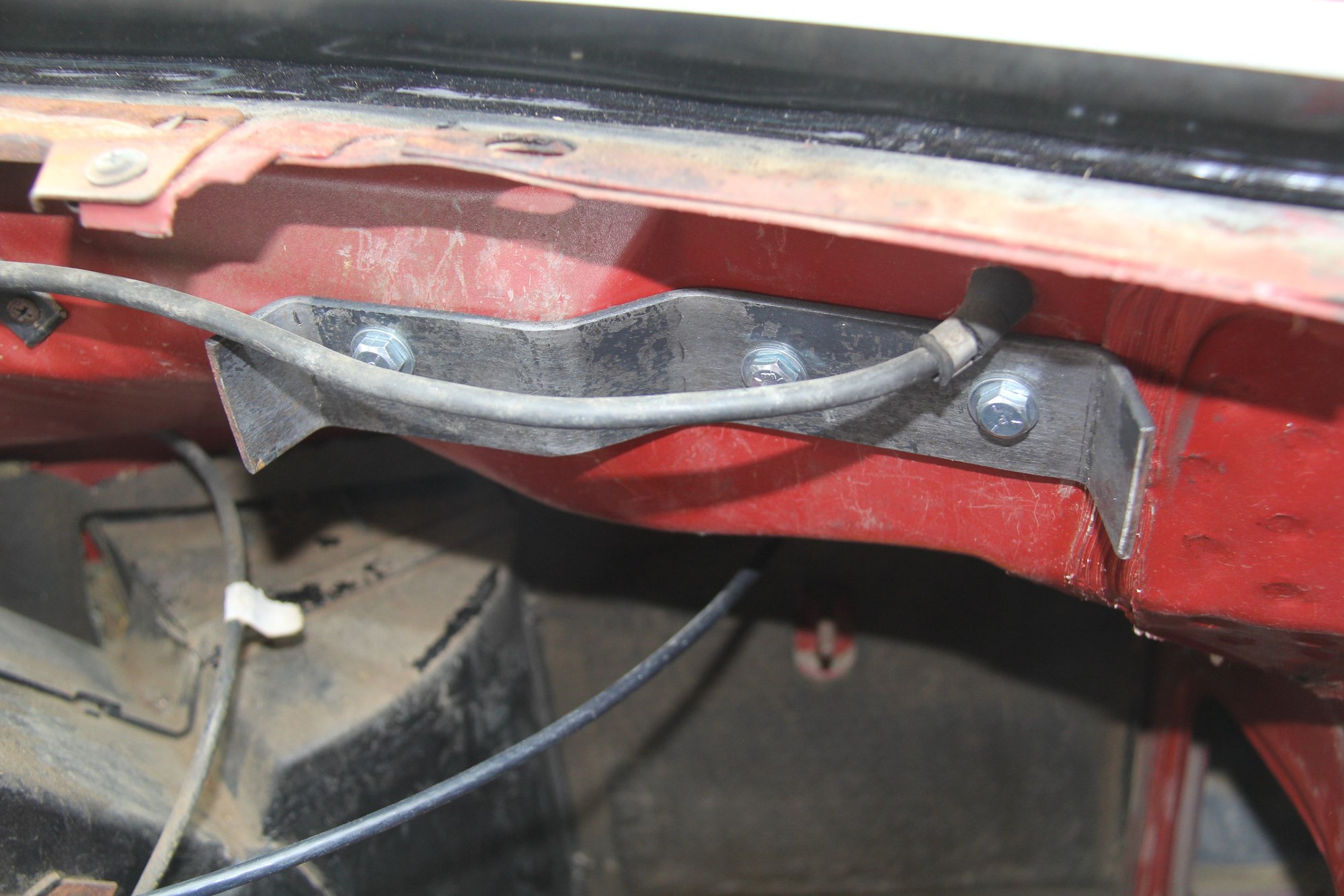

[img alt=" This is the bracket that will attach to the
firewall.."]https://cimg8.ibsrv.net/gimg/www.ford-trucks.com-vbulletin/2000x1333/img_4530_5c50e28893664c5faa80e2380bd35299a2cc03f5. jpg[/img]
This is the bracket that will attach to the firewall..
[img alt="This is the back side of the bracket showing
the countersunk for the head of the rivnuts.."]https://cimg7.ibsrv.net/gimg/www.ford-trucks.com-vbulletin/2000x1333/img_4531_f6272ba1ce935db4367f822c478415a2200bb147. jpg[/img]
This is the back side of the bracket showing the countersunk for the head of the rivnuts..
  Here  it  is  installed  ..  I  used  1/4 - 20 rivnuts..
 Showing some  of  the  magnets  I  used  to  hold the  bracket  while  fitting  it..

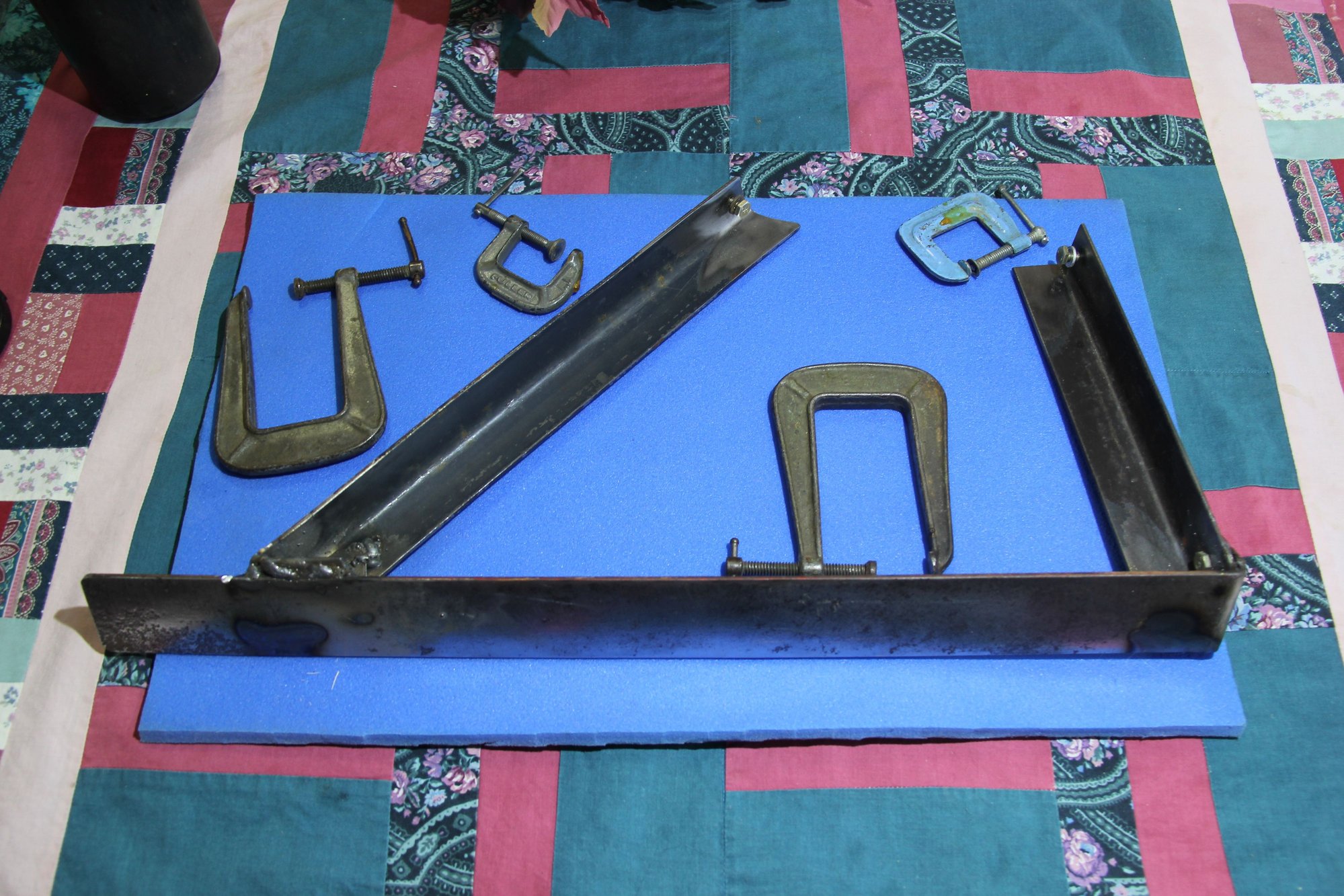

This  is  the  part  that  attaches to  the one  on  the  firewall..  The  welding   isn`t  up  to  Fords  standard  but  to  tack  weld  the two  angles  ,you  can`t  even  see !!  So  put  the  torch  head  in  there  , pray,  and  pull  the  trigger..   The  far  end  gets  bolted  or  you  would  not  be  able  to  install  the  unit..

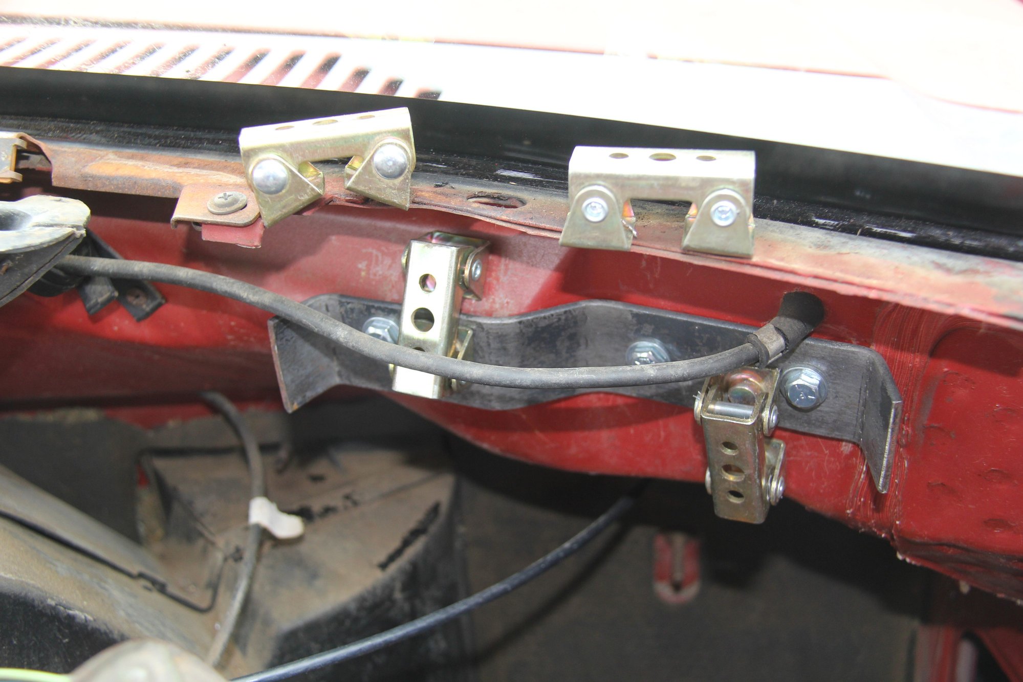

Here  it  is  installed ..  It`s  not  in  the  way  of anything   and  we  hope  to  find  a  grab  handle  like  the  one  in  our  Jeep  wrangler..  The  long  flat  bar  fits  right  behind  red  panel..
