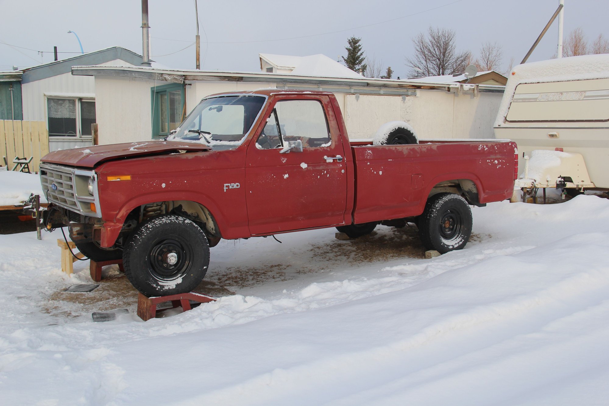

Good Morning Guys ,, Well it`s only 8 deg. below freezing and the sun is sort of out and the wind isn`t to bad yet so I thought I`d try a couple more pictures..
 Here she  is ,  As  you  can  see  I  have  her  up  on  ramps  so  I  can  do some  cleaning  underneath a  lot  easier ..  There  is  still  lots  of  original  undercoating  underneath.. Not  to  bad  for $ 400 dollars.

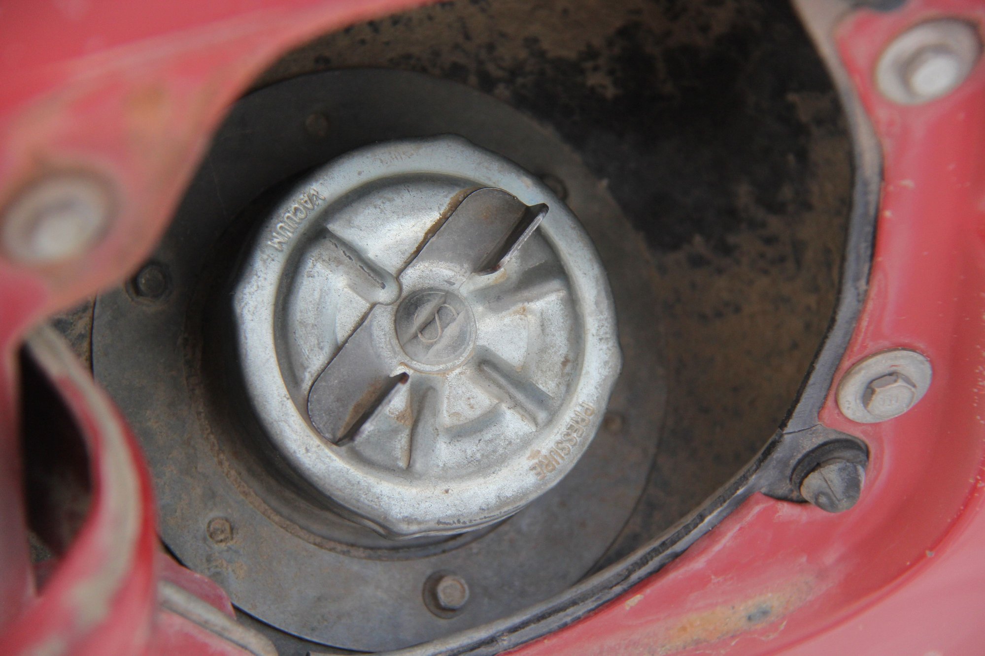

We  don`t  have  a  locking  gas  cap  yet  but  will  be  getting  one..

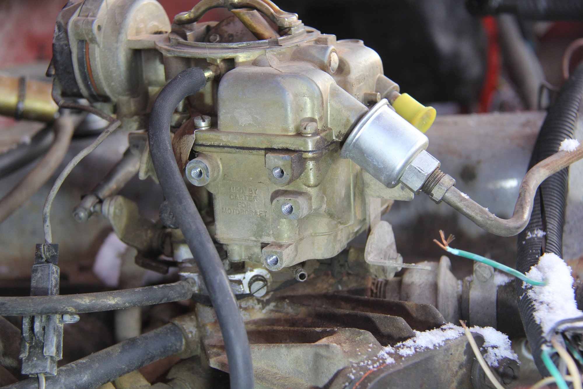

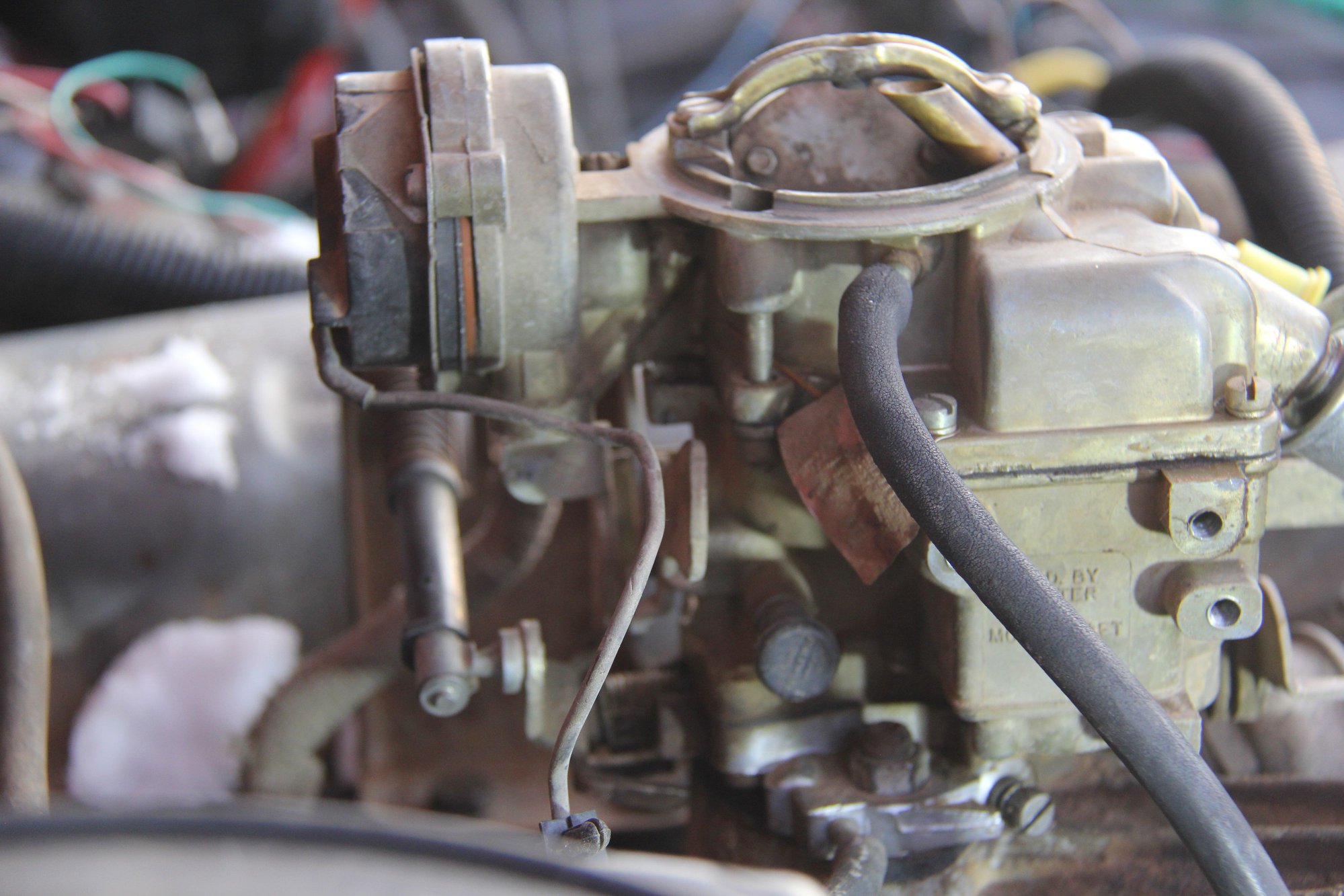

This  is  the  right  side  of  the  carb.  after  I  removed  a  couple  of  things  that   were`nt  doing  anything..  I  also  found  the  tag  on  the  carb. , you  could  not  make  out  the  numbers  so  I  brought  it  in  and  cleaned  it  up..  I  used  the  misses  toothbrush , but  I  don`t  think  we  need to  tell her  that !!!   I noticed  the  vacuum port near the  base  of  the  carb.  There was  no hooked  up  to  this in fact  you could  not  even see  this  port..
Right rear  side of  the  carb.  you  can  see  the choke  heater  wire  that  comes  from  the  alternator ..  I  will  be  replacing that  as  it  has  a  few  cracks  in  the insulation.

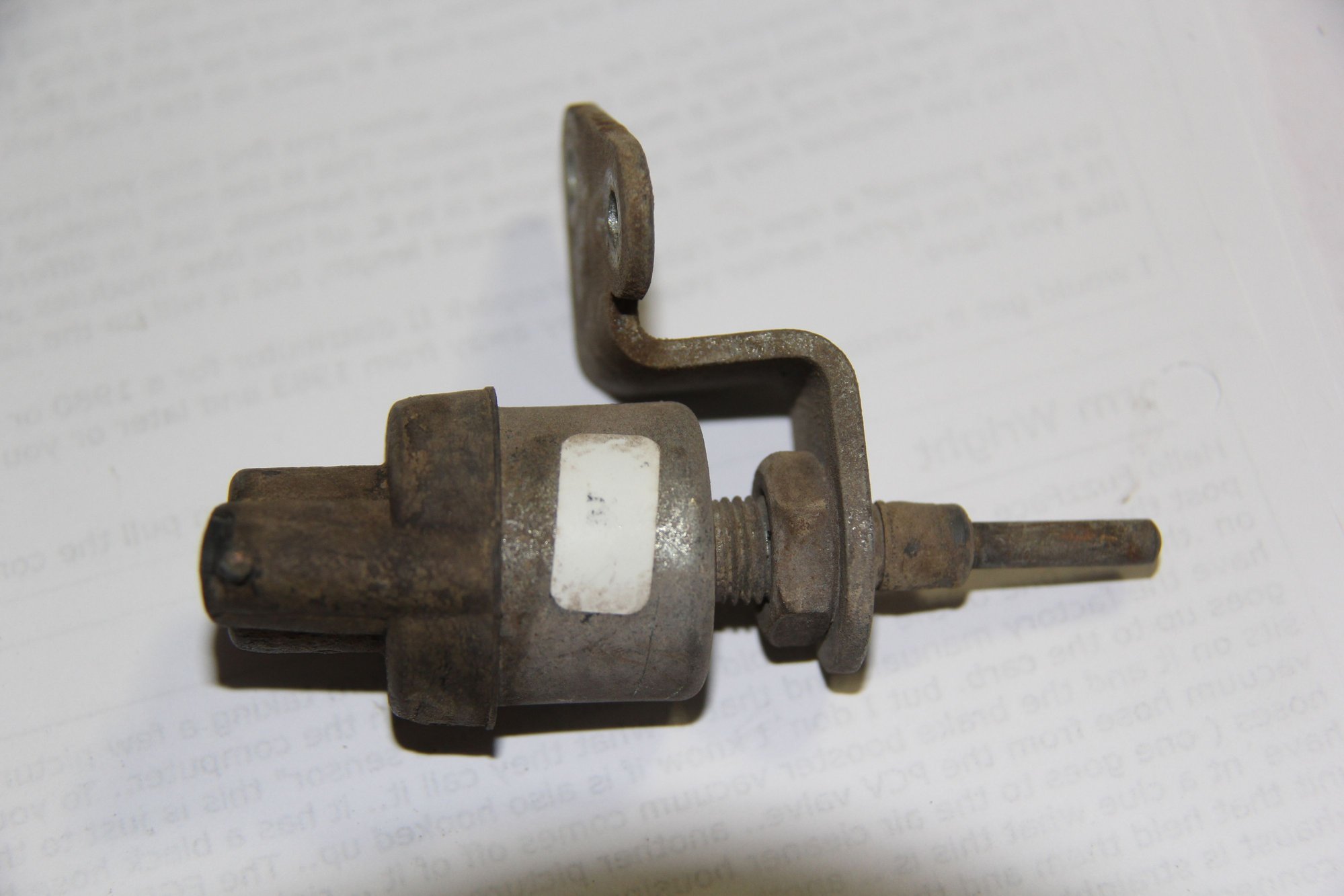

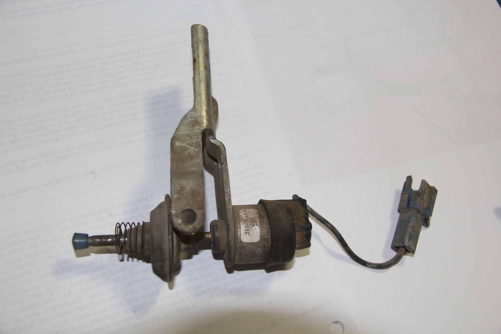

[img alt="These are the 2 items I took off. and there position to each other.. The one on the left was not hooked up to anything and did not seem to do anything.. The one on the right bumps up (sort of ) against
the "]https://cimg9.ibsrv.net/gimg/www.ford-trucks.com-vbulletin/2000x1333/img_4509_3b9f0c4ef3c6a7d6f26baa3f37b5657a905061c5. jpg[/img]
These are the 2 items I took off. and there position to each other.. The one on the left was not hooked up to anything and did not seem to do anything.. The one on the right bumps up (sort of ) against the " mechanical fuel bowl vent lever
 This  is  the one  on  the  left ..  Possibly  it`s  the
This is the one on the left .. Possibly it`s the " fast idle positioner dc motor"
 This  is  the  other  one  that bumps  up  against  the  fuel bowl vent lever.

Truck look good. I paid twice that for my 81 and it was not a 4x4. How bad was mine you ask? Well when I got it home and found the motor would fire all six plug after I installed new ones I started to pull the truck for a 4 year cab off frame rebuild.
That open port is for the vacuum advance on the dist. if you had that type of dist.
For now you can just plug it. I like to use a short vacuum hose with a screw / bolt in it. The cheap cap you get in the parts stores like to split and fall off in a short time.
As for the 2 items you removed dont trash them just yet. I think they were on the feed back carb and moved over to this non-feed back carb and being they were not hooked ou or the computer working then ATM dont see the need for them.
I take it the truck dose not have AC? If it did 1 would kick up the idle when the AC was on. I have AC but no solenoid and dont have any issues.

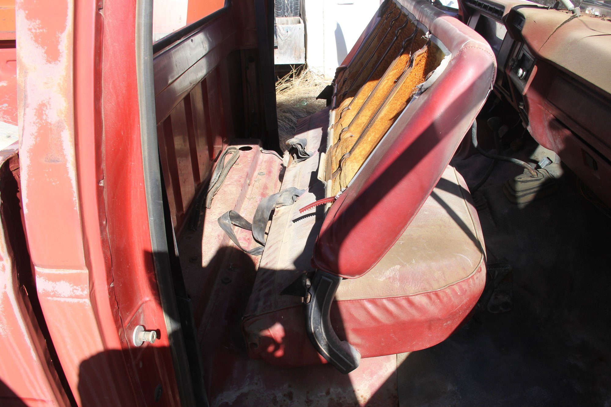

  The  cab  is  in  pretty  good  shape
  Behind  the  seat , the  cab  corners  are  clean, no rust  no  body  rot.

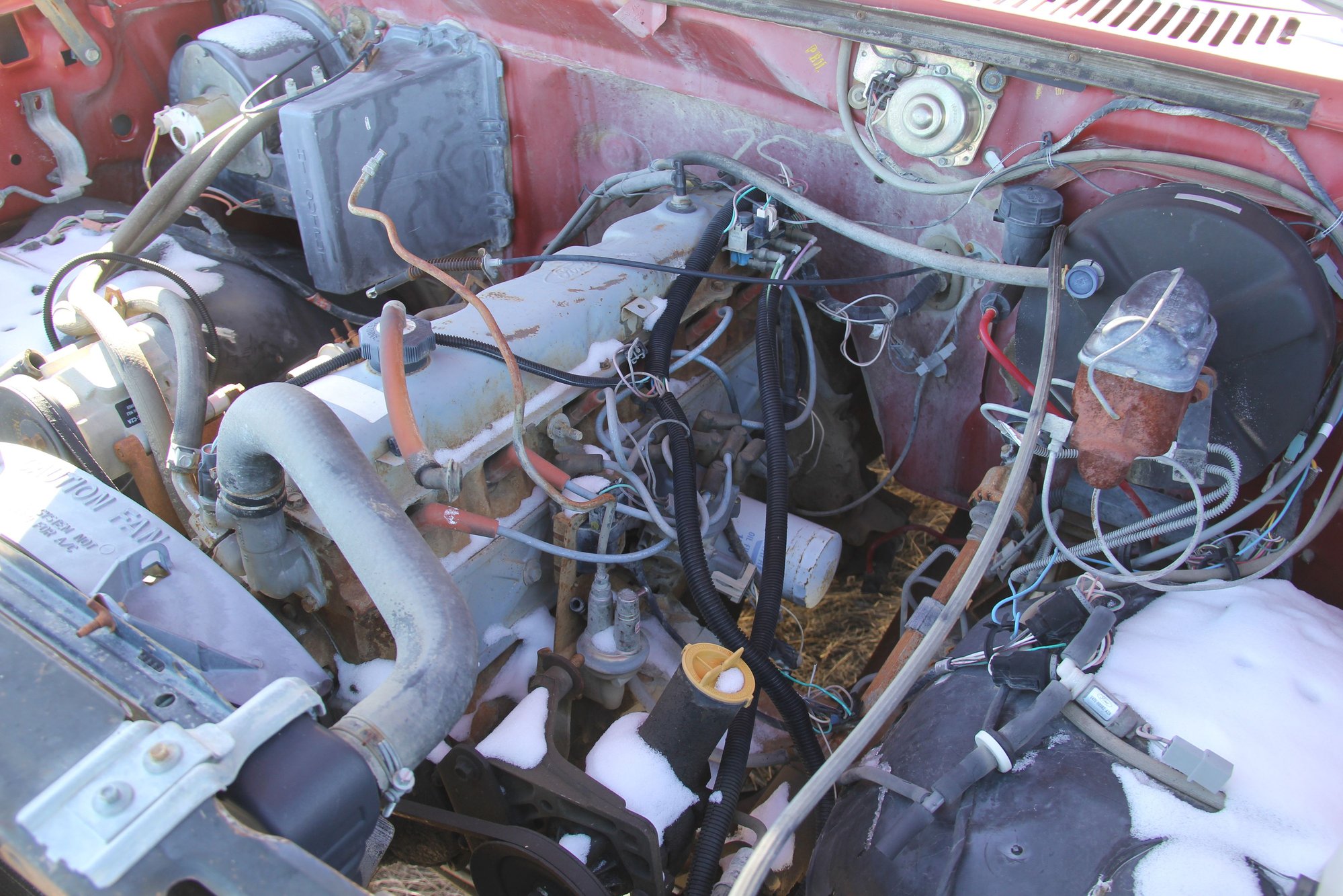

the  engine  minus  the  manifolds, carb.
the  radiator was  still  full  of  antifreeze  when  we first  checked  her  in  Jan. !!    A  really  good  thing  !!

The unit above is not the DC idle control motor. There are not enough wires. You can see in the diagram below the DC control motor has many wires going to it. In one of your pictures you show this engine with no intake, exhaust, or carb on it. It looks like someone has replaced those parts from a earlier engine which did not have computer control. Which is good if you are getting rid of that stuff.
