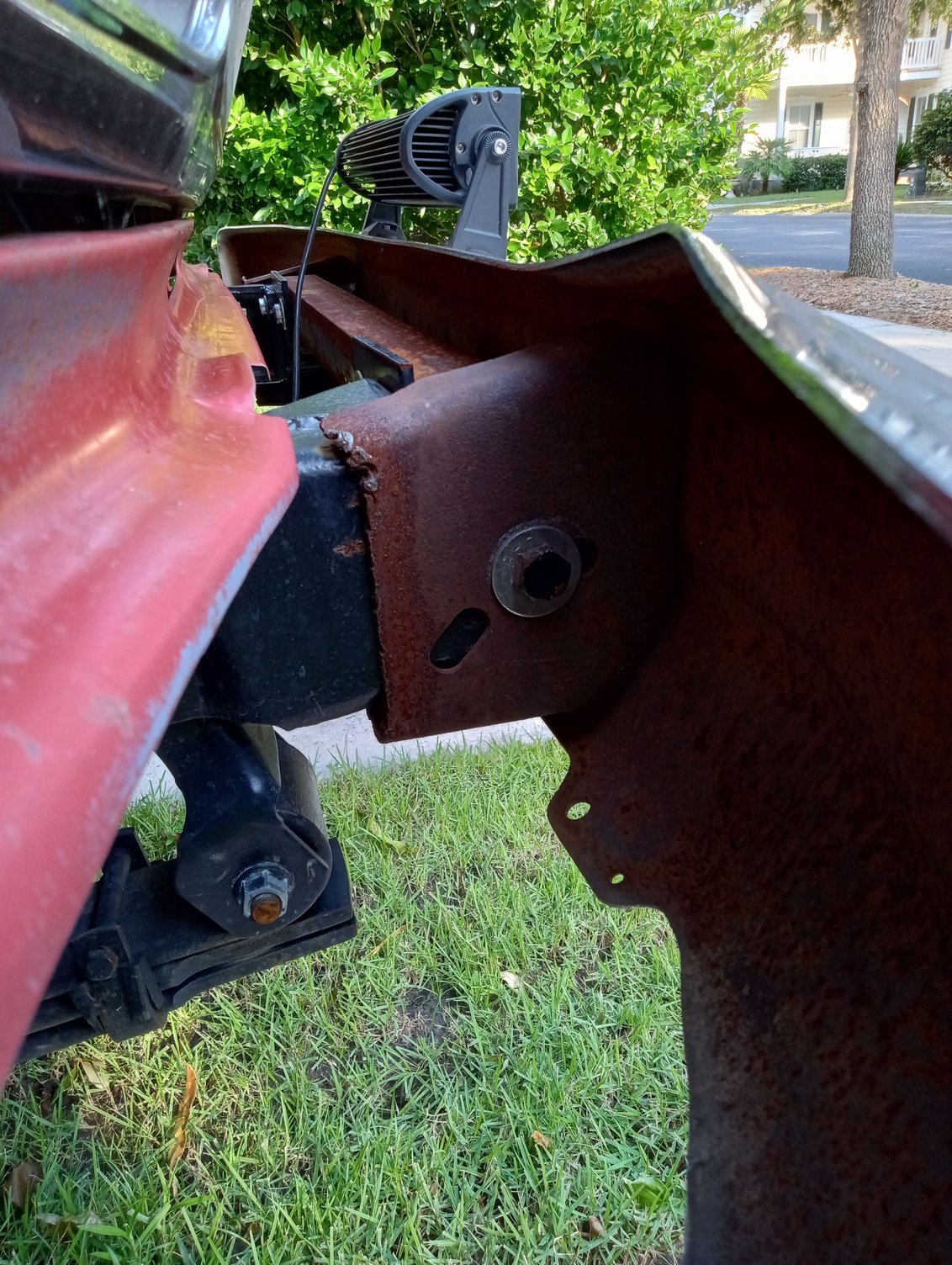

Here's my cheap fix for the bumper horns being different between the 84 and 92:
It makes the bumper stick out a little. May do a winch someday to make this better.
