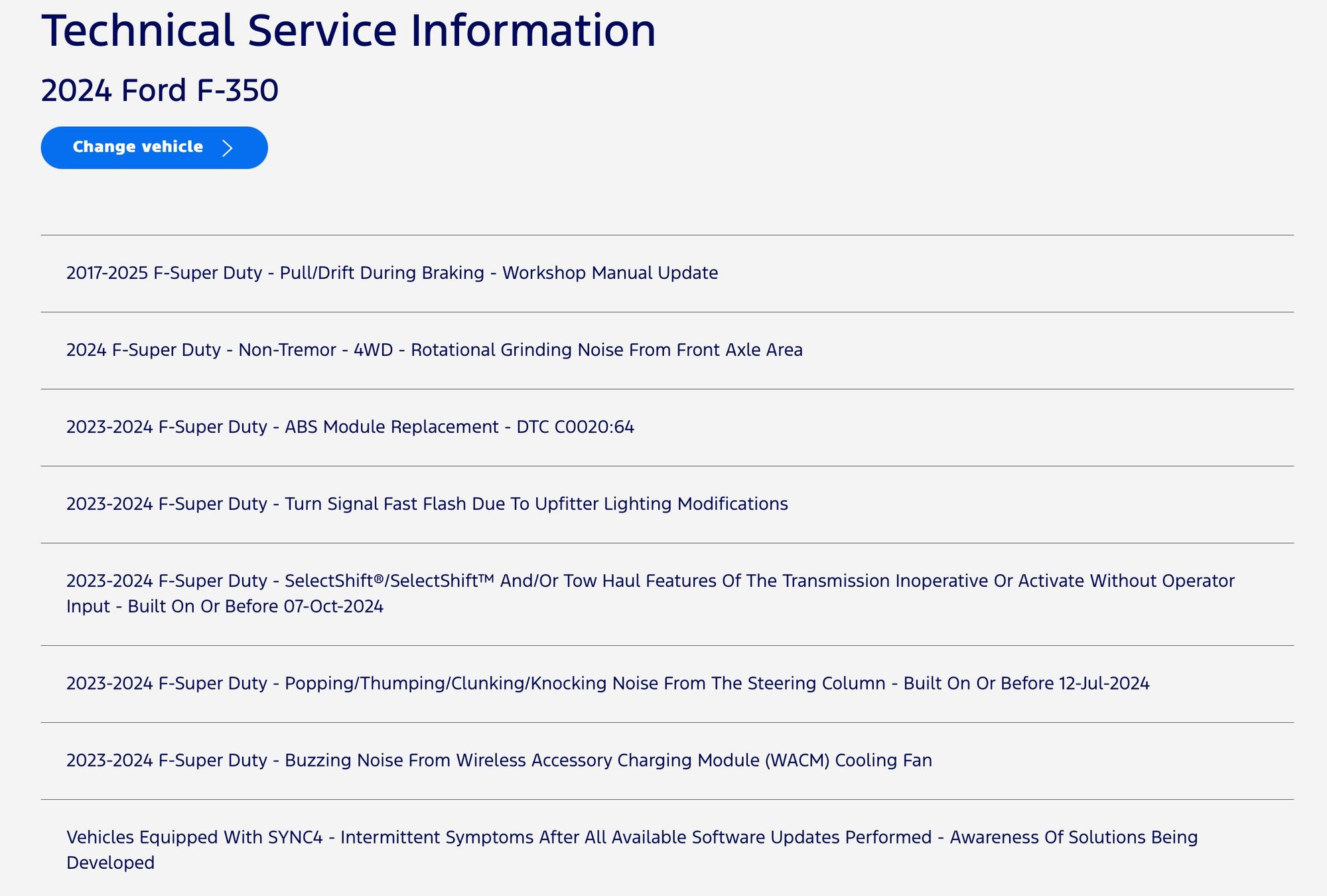

This is on the Ford website.

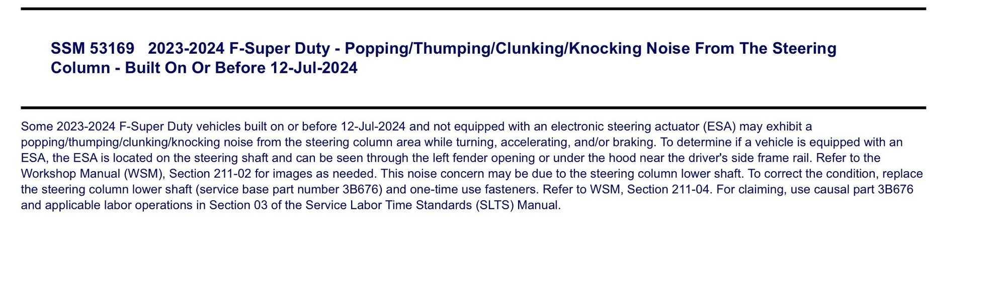

This was fixed under warranty at the dealer.
Any date when this was released?
Very interesting that this is now a known issue.
Curious about why they replace the whole section shaft under warranty when we have been remedying the issue with just lubricating the parts???
Maybe there's more to this than we previously thought?

Zork, I don’t see dates on any of these. But I don’t recall seeing that one when I last looked a couple months ago.
Time. For Ford it is cheaper to replace the part than tear it down, grease, and reassemble it. I believe there is also a seal on the outer shaft that is not replaceable, so if no part is available for the seal, replace the entire unit.

Part number is apparently: PC3Z-3B676-C
Decently cheap at ~$65.00. I might even buy one now and keep it for future installation, should the jolting ever return. Seems cheap enough, and less hassle (to me) than to drive to have it done under warranty.

Walk up price $95, or dealer price if installed, but even so, much less expensive than I thought.
