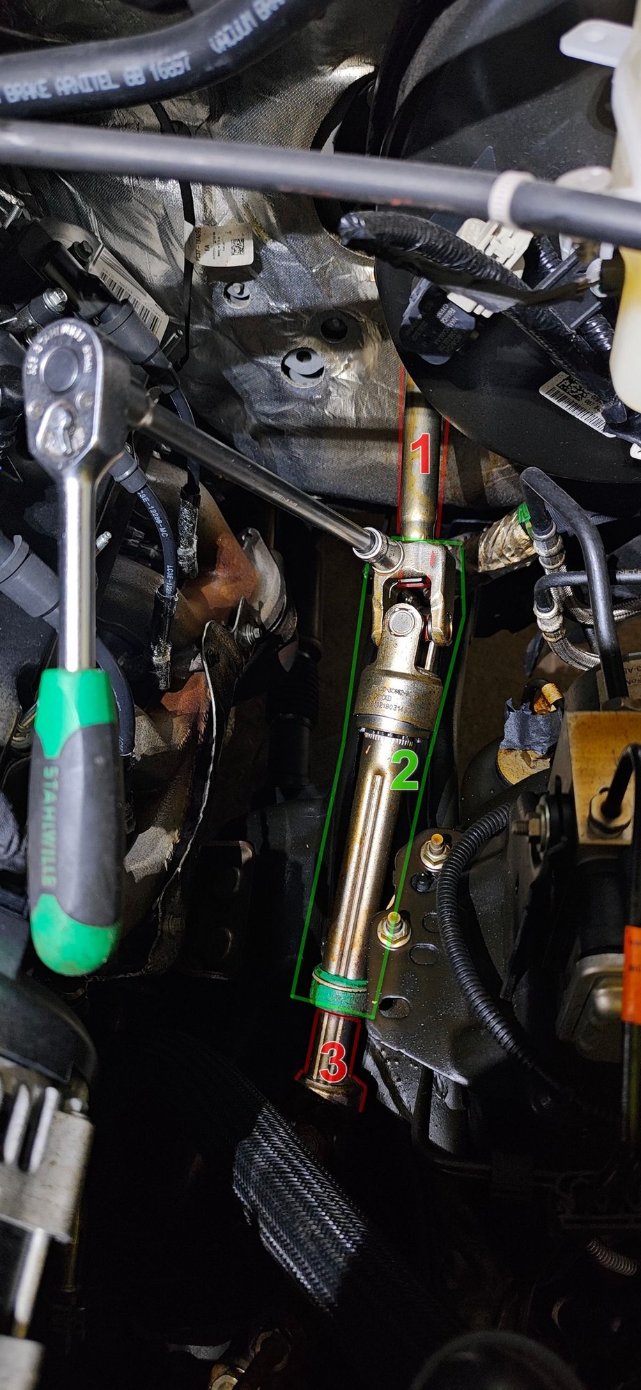

Update:
The problem was fixed a while back. Removed the sector shaft and greased it up, and reassembled it. Did a 600 mile round trip, and no more 'jolting' or 'clunking' through the steering wheel.
Thanks @acdii for the help.
Pic shows the attachment bolt of the sector shaft already removed:

Old Dec 12, 2024 | 12:02 PM
acdii's Avatar
acdii
Joined: Feb 2022
Posts: 7,968
Likes: 4,043
IIRC the shaft is removed at the u-joint, then pulled apart, the section in the pic with the grooves is the two piece shaft, and that is the part that gets greased.

Originally Posted by Norris McCarty
My ‘24 is doing the same.
Did you take the ujoint apart to grease it?
I don’t see a zerk fitting on it.
Originally Posted by SICA526
How and what did you actually grease?
The U-Joint itself isn't greased; that's not the culprit.
Lets try this second picture...I hope I can explain it properly:
Parts 1 and 3 remain attached to the vehicle, part 2 is what is slid off part 1 'downwards' and is then removed by pulling it out of part 3 upwards.
The grease goes onto the now-exposed shaft of part 3.
