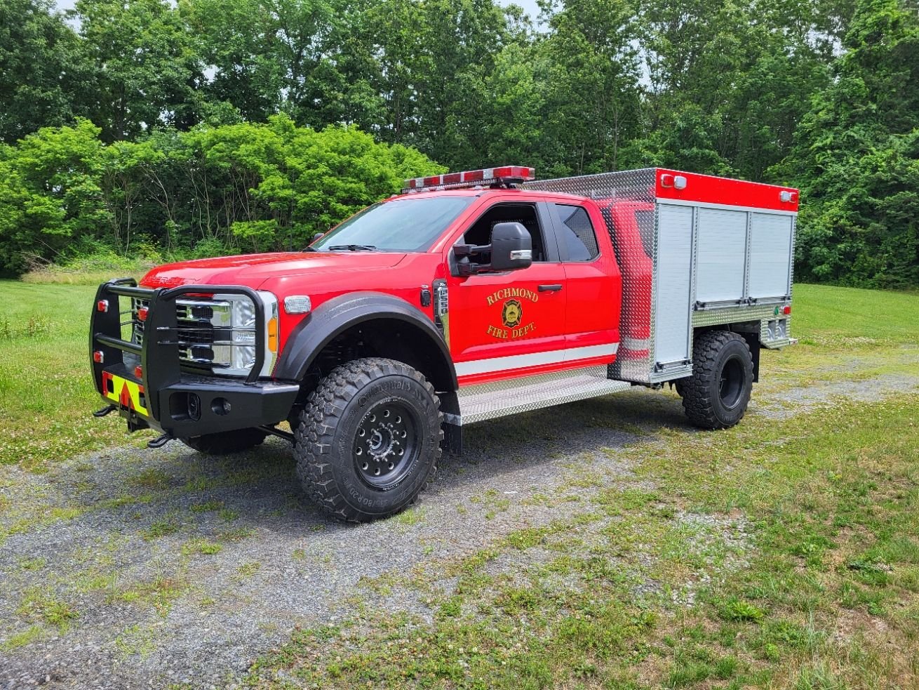

I have a 2023 Ford F550 Cab and Chassis we built into a brush truck. I installed super single Continental 235/80 20R tires (39.5" tall). To calibrate the speedometer we installed the Hypertech module. On hard corners and turns, I get a traction control error and an ABS error. The cruise is disabled, the hill descent quits working, and I get a message that the automatic brake system is disabled. I have the Ford Diagnostic Software, and from what I can tell, the problem is that the truck's roll stability system is seeing the wrong vehicle speed. Does anyone know how to change the tire size in the computer systems? Which module is the tire size stored in? How can I eliminate this problem?

I used forscan to change the tire size on my 24' XL. I have 37" tires and changes the tire value many times without any issues while I used trial and error to find the right setting based on GPS speed comparison. At least for my vehicle this was extremely easy and straight forward following the instructions I found on this site. Let us see pics of this beast!

I second that we need pictures. Sounds like an interesting truck.
