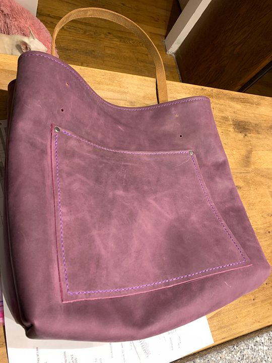

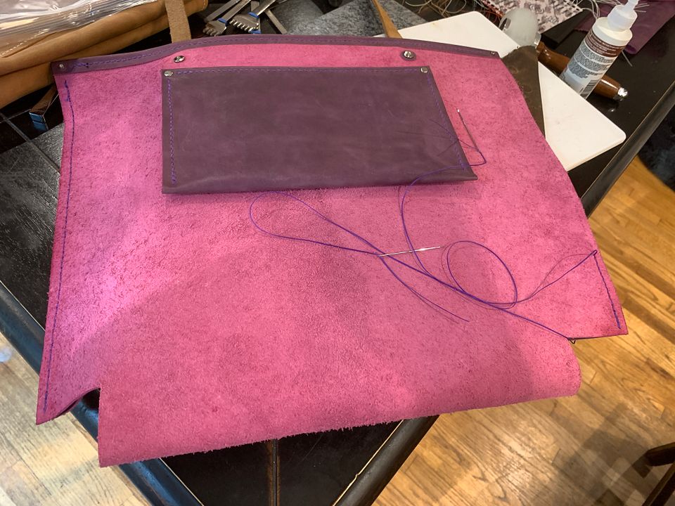

I do quite a bit of leather work. The rivets I use are tubular and I use a press with a splash anvil most often. The splash on the backside keeps the rivet from pulling back out of the leather, but it might not be the way to go for the thin channel that the vent window rivets sit in. The press I use costs more than two new vent window frames would cost...
I just finished this tote for my granddaughter. Grape leather with purple thread. It's her thing.
