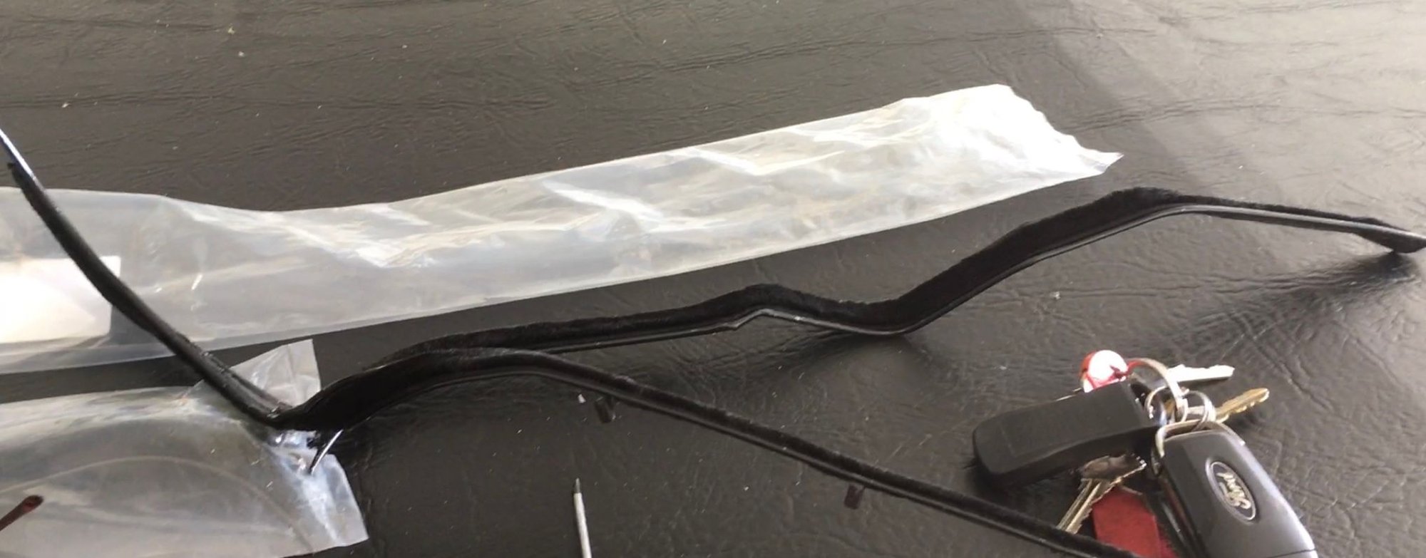

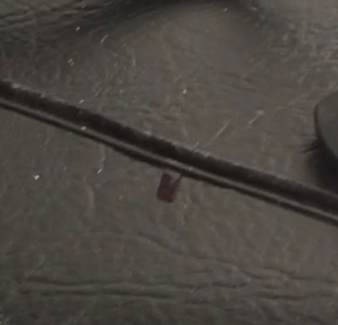

My truck came with all the window weather stripping, seals, fuzzies. The PO was nice to include them.
No maker, manufacturer on the items. I went to install the fuzzies for the window/ door, where your arm rests while driving.
very simple, line up the clips and holes, push till you here a click, installed, so you think. When I rolled up the window, the felts came
up as well, twisting them so nicely, there now trashed.
I feel the clips are undersized and wouldn’t hold. Are all parts really the same or are these just poorly made?
Anyone else have this problem?
