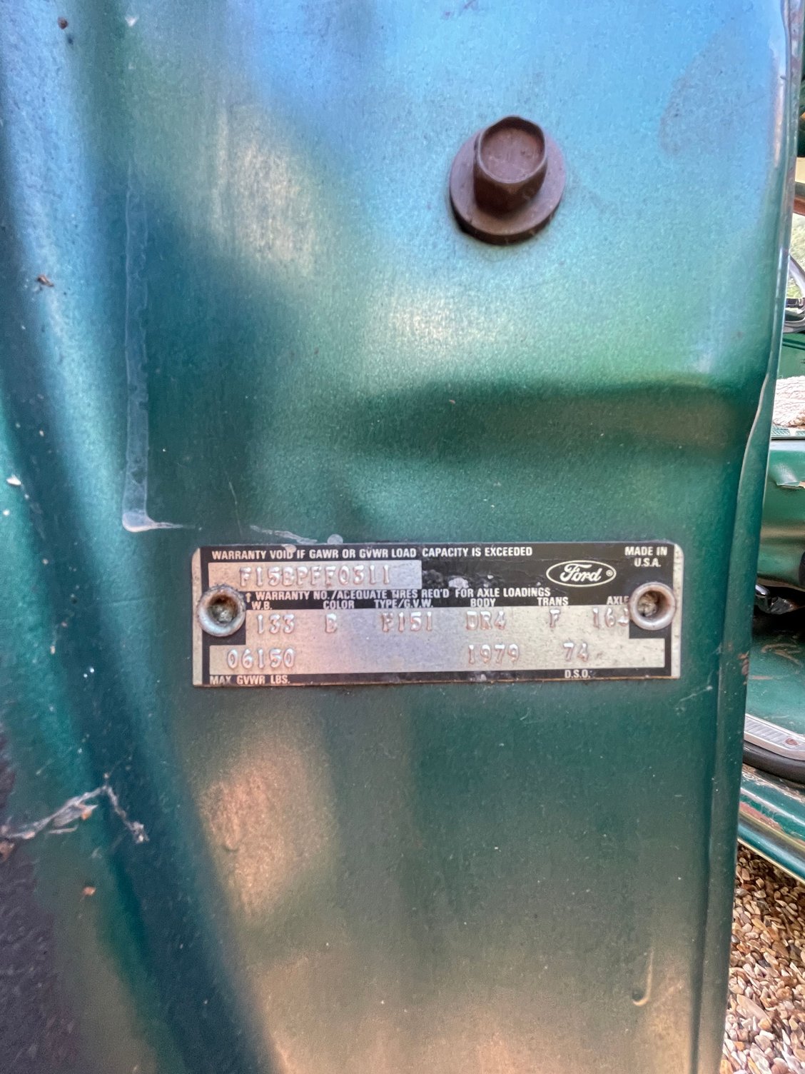

Someone will ask what your rear end ratio and tire size is.

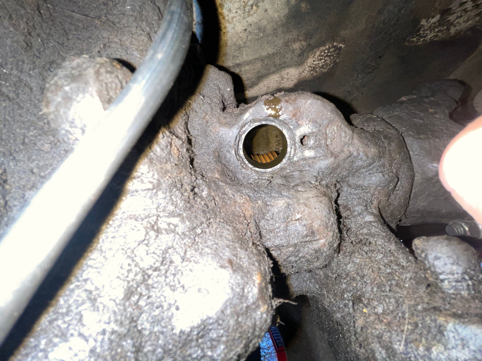

How many teeth are on your current gear?

You haven't given enough information for anyone to know. Go to this site and put in your information to figure it out. Ford Speedometer Calculator
I’ll need to take it out, not sure if the previous owner replaced the gear with the wrong one as he replaced the speedo cable
sorry, I’m completely new to this. How can I find the rear end ratio?

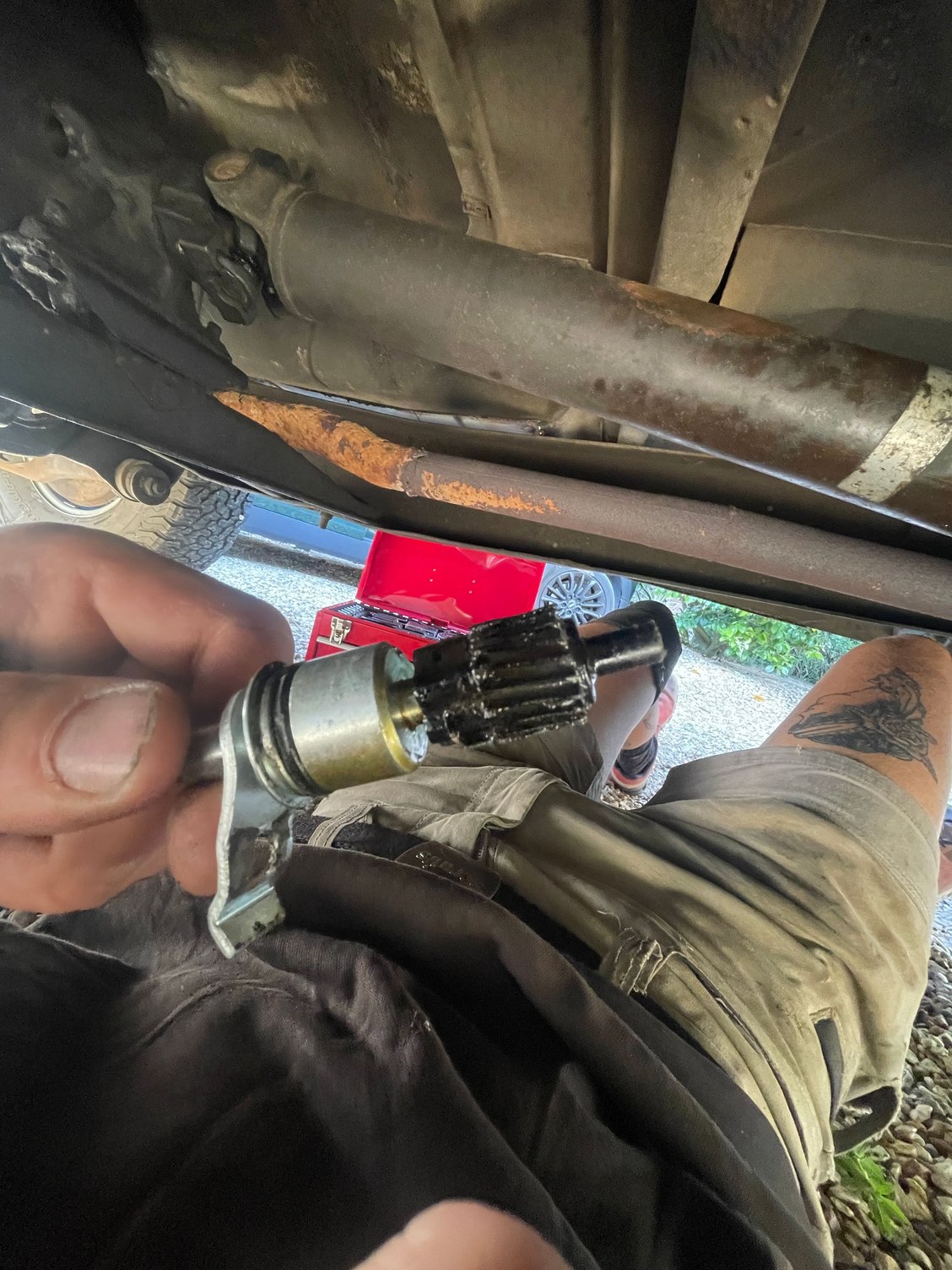

This is what I’m working with

It looks like you need to replace the drive gear, the one inside the transmission or transfer case.

what makes you think that?

The teeth appear to be worn off of the drive gear. Here's a pic of a random Ford drive gear. Notice how the teeth are the same height across the gear, unlike your current drive gear.

ahh I see! I appreciate that, seems like I’ve got a much bigger job on my hands now

Unfortunately, yes, a much bigger job. The driven gear looks OK, but you may want to replace it as well.
