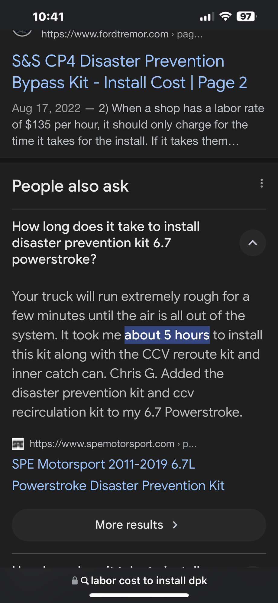

I have a 6.7L 2017 F350 with 130,000 miles. Plan on ordering a 2025 this winter. However in October we are taking a month long trip from Ohio to New Mexico & Arizona pulling our 38 ft 5th wheel & the protection of a DPK on a long trip makes sense to me. I see the kit price is $400. Can someone tell me how much it runs for an authorized dealer install? Thanks
Realistically, you can install it yourself. They have a really good video on their website. When I was getting quotes for the complete fuel system on my 2015, one shop quoted an additional $400.00 plus the cost of the DPK to install it. I have no idea if that is average. Likely depends on where you live.
I forgot to add, two other shops included it in the price of the rest of the installation...since everything else would be torn apart anyway. In reality, the only additional time was mounting the remote filter.

Likes: 2,187
Old Aug 29, 2024 | 10:01 AM
