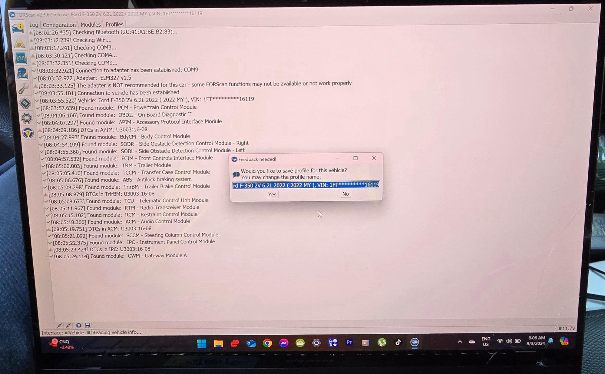

Ok so I have some new info. I managed to get home Satuday night. I still haven't managed to swap the fuel pumps but i was able to hook up the Forscan. I'll attach pics of it when hooked up to my Ford and a pic of it hooked up to my boss's. Its not connecting to mine. I will do that fuel pump my next set off, starting on the 15th. My question, what parts/components effect the OBD plug, turnsignals, fuel pump & cause a trailer braking fault? It seems to me that at least some of those must have a common cause?
My truck connested to Forscan.
My bosses truck, so it does work.
