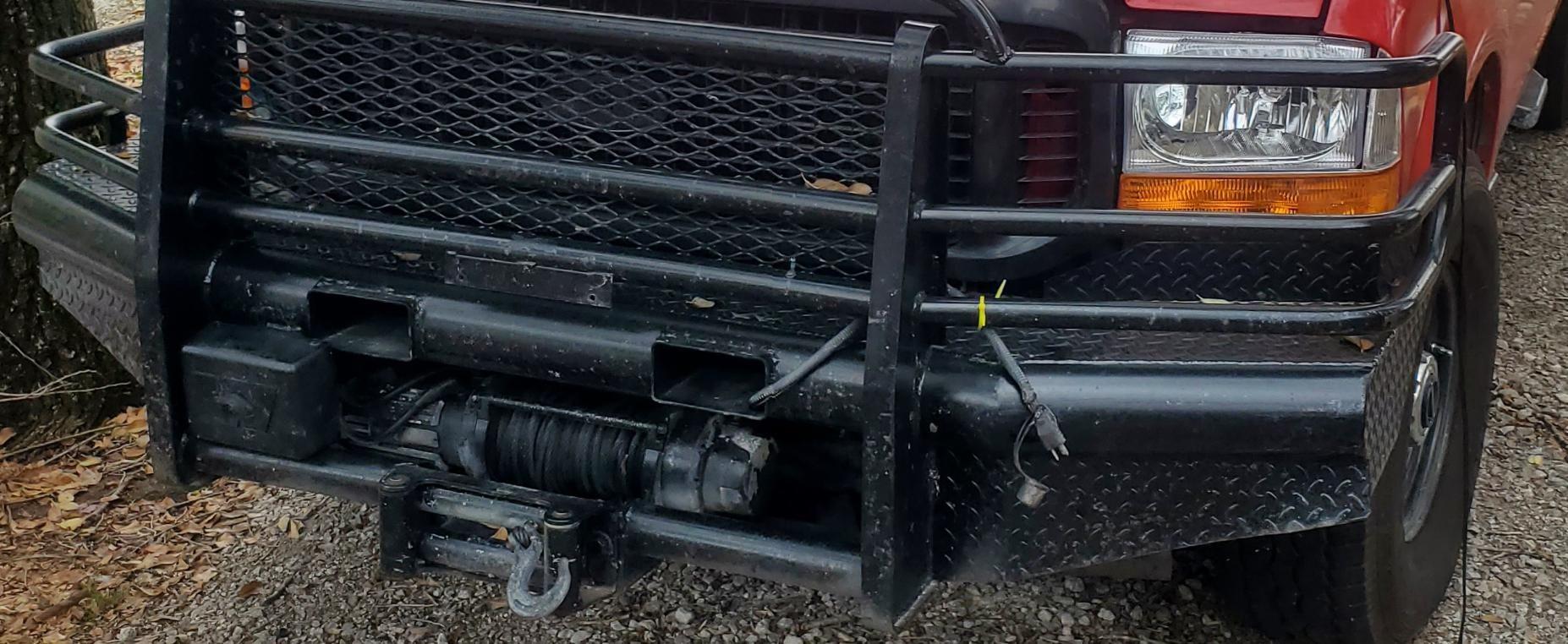

this is the original Warn Winch mounting
Warn Winch

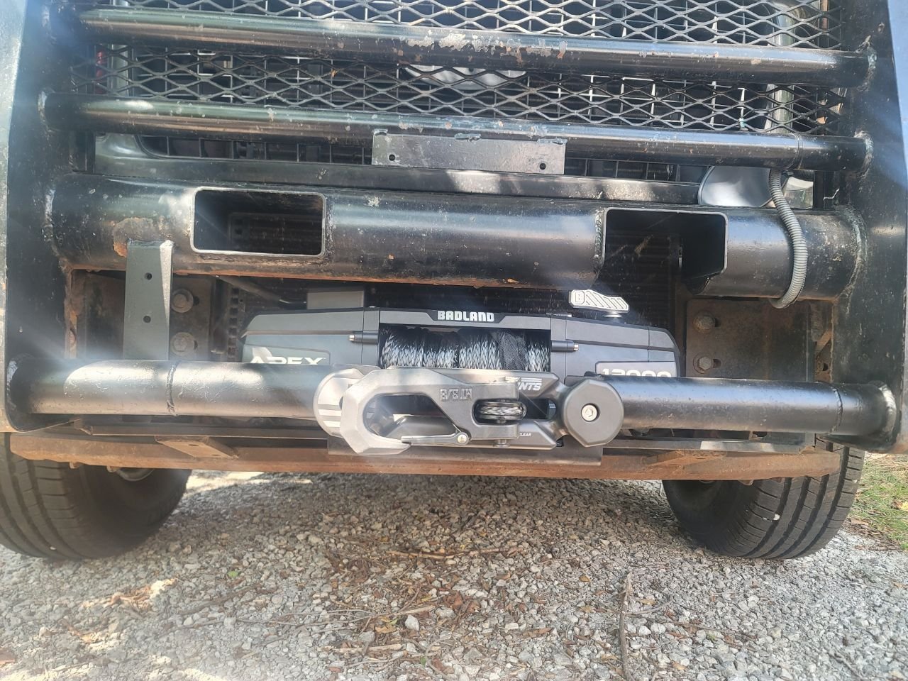

this is the APEX winch, you can see it is resting on the Ranch Hand winch support cradle, well forward of the vehicle frame.
in this pix, it is not even bolted down yet, just sitting there to see how it fits, and what mods have to be done to the Ranch Hand bumper to allow my size XXX hands to access the Forward/Reverse/Free spool lever.
that hole in the bumper, where the Block Heater cable was routed, is too small for my hands to get through it...
So, I asked the installer to cut the bottom of that hole out completely, now my hands can get to the Free Spool lever.
this pix is looking down at about a 30 degree angle, you can see in the right side, the Ford Crossbar that DOT mandated to keep the truck from climbing up over a very small car.
This pix is level with the winch, showing how neatly the installer put the Ranch Hand bumper back together. You can't tell that the APEX winch was not the original winch on the truck, I love their attention to detail.
that DOT mandated crossbar is plainly visible under the bumper here.
I need to paint that crossbar, I don't like it being so prominent.
