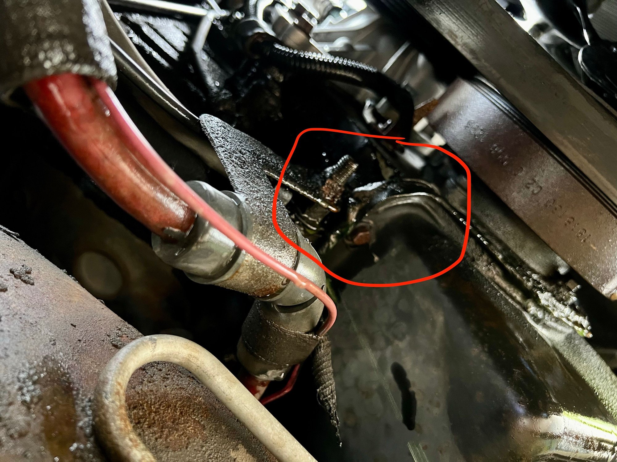

Hi. I'm new to powerstrokes. I have a truck I bought a month ago or so - 96 f250 7.3. Last week, it started to drip coolant when I parked it. Within a day or two, it went from drip to full on leak. It pours out the passenger side somewhere and runs off the bottom of the main pulley. I figured it was the water pump weep hole, so I changed the water pump, today. Filling it up, I got about 1.5 gallons of coolant in it before it started pouring again. I can't see where it's coming from. I've circled the area it's dripping from. I'm not too familiar with this engine. what could be leaking back there? freeze plug? oil cooler?

Clean the area up. Oven cleaner works killer. Then eyeball where it could ooze from on the engine.

Found it. Somehow, I missed the bottom wire harness clip when I put the pump back on, and it got between the pump and the block. I took it all apart, redid everything, and all seems to be ok. Big oops on my part, there.
