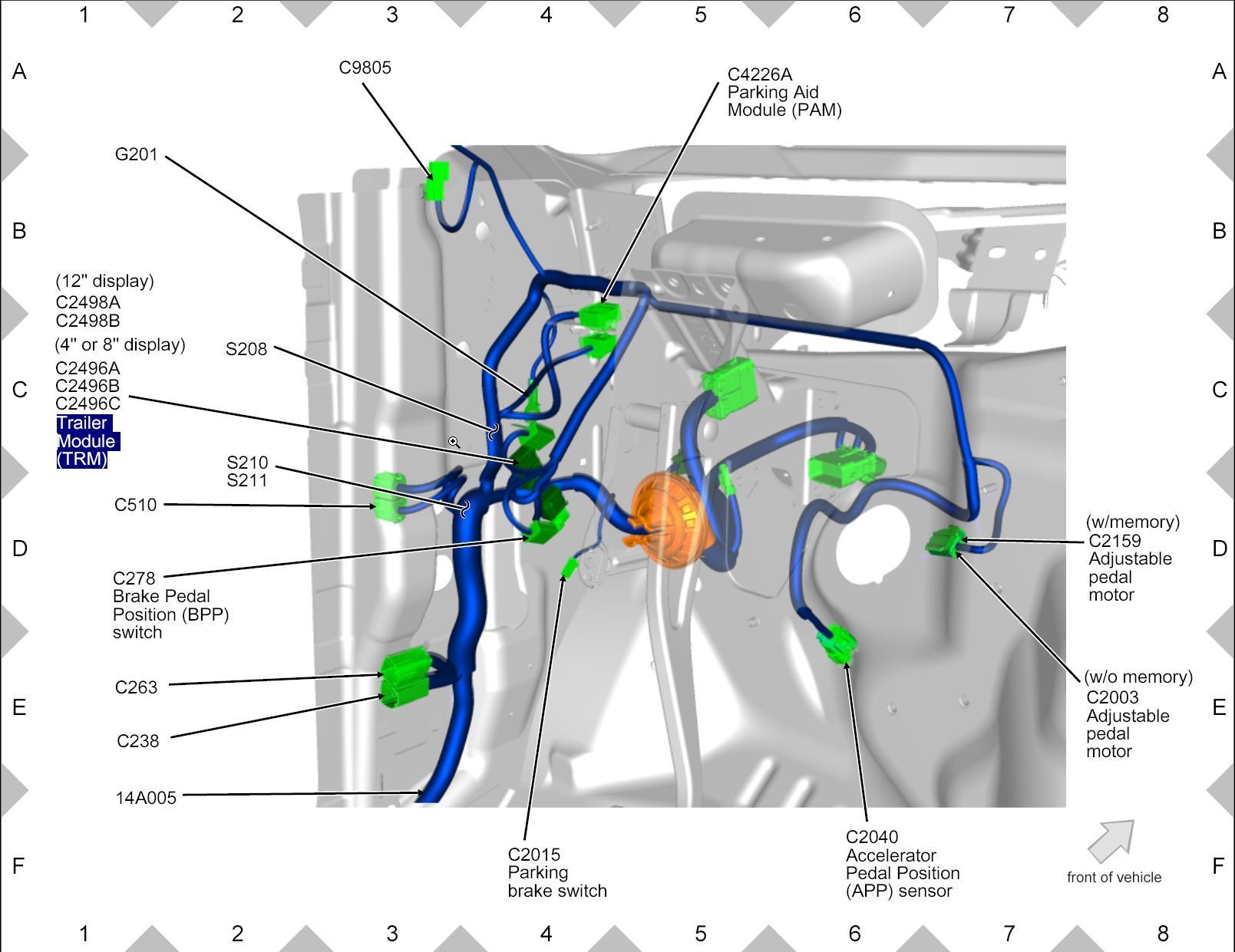

Good morning, I had my truck at the dealership yesterday, it is a 2022 F350 XLCC. I put in the trailer, brake controller in the dash to the left of the steering wheel, right of the AC/radio, and ask them to program the truck, they continue to say I am missing the module or trailer brake module Within the cab. Before I go tearing apart my interior does anyone know where this module is located?? I really need some help. Thanks!!

Trailer Module (TRM) is in the drivers footwell

An XL may not have the trailer module. The brake controller needs the module in order for the truck to talk to it and control the trailer brakes. Do you have the 7 pin socket factory installed? If not, then there won't be a factory installed module.

I do have the 7 pin it’s what I’ve been using for my trailer,

thanks!! I will take a look
