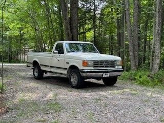

87' regular cab, driver's side noise at slow speeds in particular coming from cab corner/latch area? replaced the body mounts already...truck is solid and well taken care of, I'm baffled.
