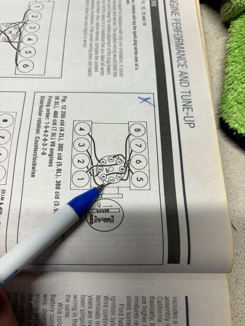

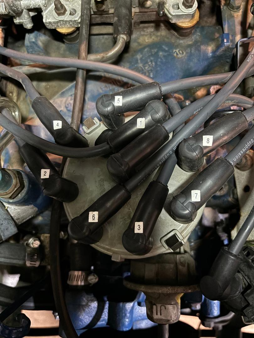

Seems to have a slight miss. Wires were put on as they were taken off. According to the manual picture, where the pen is pointing, I assume is the cap clip. If you look at the actual picture of my setup, those clips are not in the same spot.

It makes no difference what terminal you start on , as long as you pick a #1 and start there with the firing order in rotation.
The #1 position in the manual is just the standard positioning. if you'd rather have it that way just move every plug wire on the cap a hole.
Your timing is more important, you should check it .
How does one verify a miss isnt from a bad wire? short of feeling every inch of cable while its running, lol? mine look new but are only 7mm
My 360 has a pass ex man leak so its hard to tell if the ticking is from that or snapping from bad wire.
is above firing order same for 360 FE/390FE? the pen is covering it...
right now im assuming my miss is probly cuz of weak compression on #4 clyinder. but u never know.
FUNNY enough, my engine seems to have dist cap clocked exactly like this Ford manual.
is this perhaps the ideal way to orient i to have the wires set up neatest and loom together neatly aound all the obstacles?
cuz i tried it with #1 pointing at number 1 and best you can get is 2 crossovers and a wire on each side wont be neatly fitting into 4 wire loom /holders.

Don't let 7 and 8 cross each other. Induction misfire.
