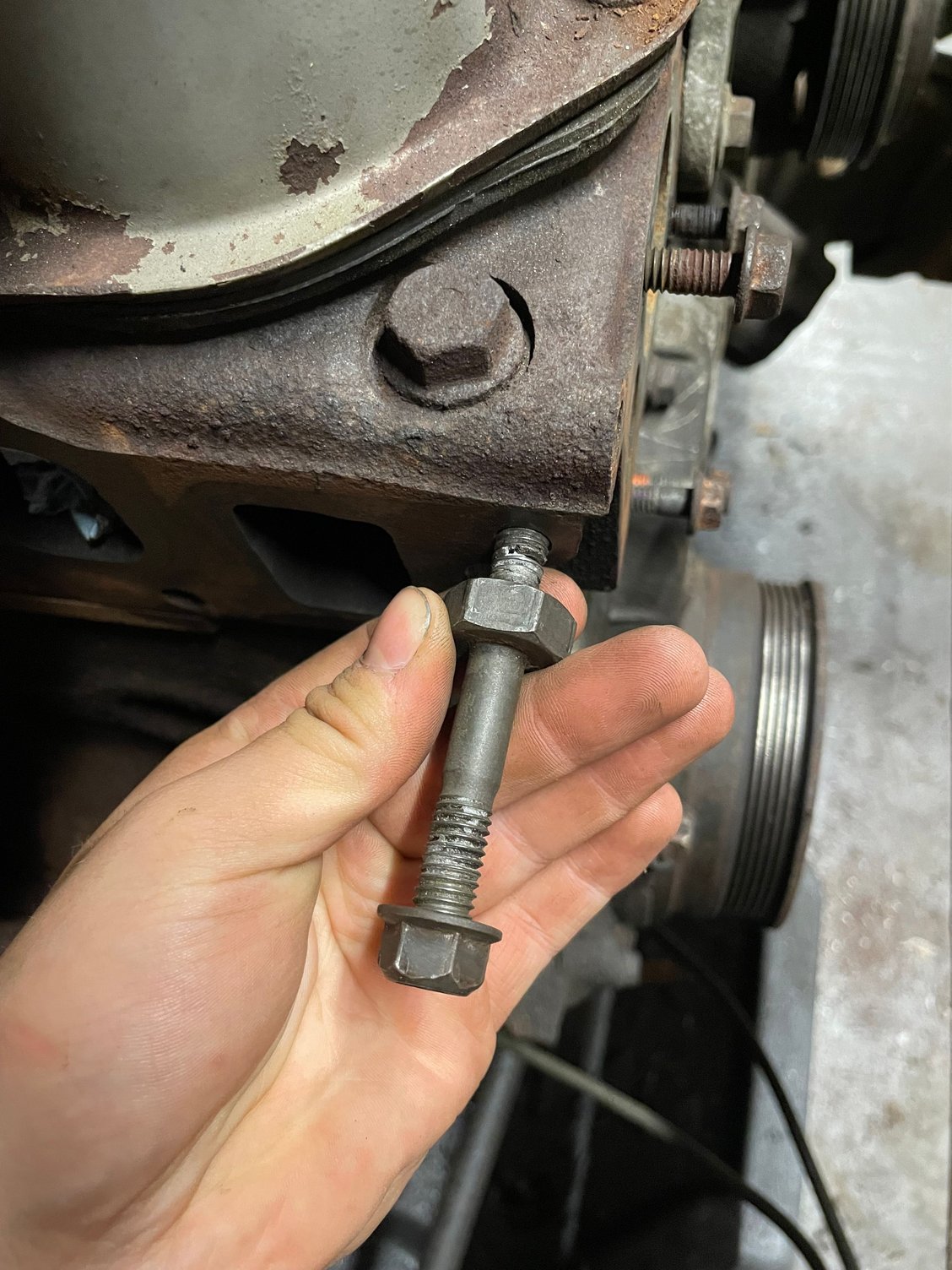

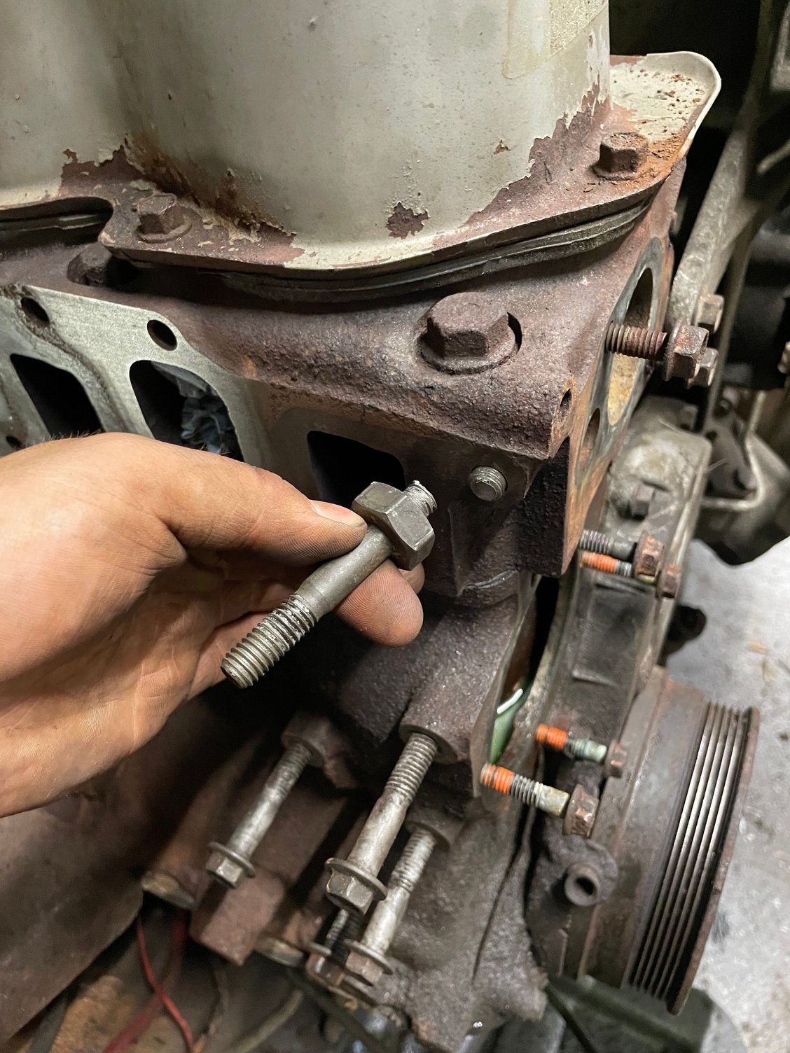

I have a 1994 F-150 with the 4.9L 300 and I need help finding a specific part. It’s the very front bolt for the front exhaust manifold, it’s a stud with a hex in the middle of it, it bolts down the manifold and also runs through the top bolt hole of the accessory bracket to hold it on, it’s threaded on the end for a nut. I snapped it and I can’t find another one, any help would be appreciated.

Put all-thread in it and then put a nut on to tighten at the head.

You can find that stud at the junkyard
I probably have one in my selection of studs
All thread would work but the stuff is grade 5 in most cases

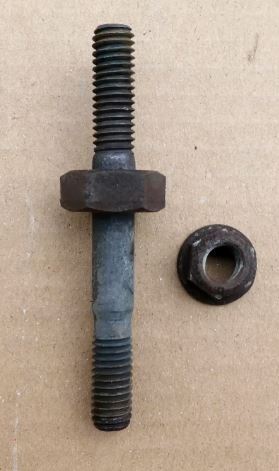

If you don't mind the price, try this:
https://www.ebay.com/itm/126564827608
