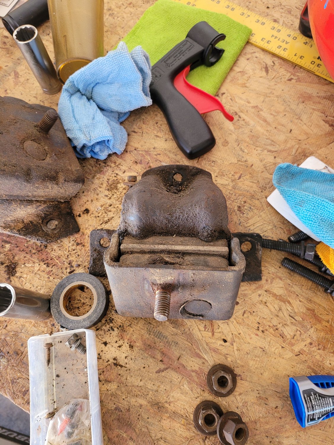

Does anybody know the size of bolts? There are six total, 3 for each mount and there are two mounts. I have not been able to find anything relating to the Inline 300 mounting hardware.

You do not have the old bolts? If you do, you can take them to the store and match them up. Do they have a tractor supply in Texas?

I want to say that they're 7/16" by either 3/4" or 1" long. I can confirm for ya tomorrow if nobody else replies by then. I bought a new set of aftermarket mounts, and the stupid things had a different stud on each side...one was 1/2" and the other M12 (and yes I know they are close in size, but they were definitely different).

I have had this truck apart for about a year, and I have saved most of the bolts but I am not the only one who uses my garage so I think they got misplaced.

I just checked one of my factory bolts and it has a 5/8" hex head and captive washer, which means it is probably a 7/16 coarse thread (7/16-14). I started taking it out so that I could measure the length for you, but it was tight and I remember that my aftermarket mounts didn't line up 100% perfectly, so I didn't want to remove the bolt. They're probably 1" or maybe 3/4" long, but you can just measure the depth of the hole and the thickness of the mount plate, and you'll have a good idea what you need. My 2 cents worth.

Found my answer
Got some time to go through bolts and sizes.
What I found for a 1985 4.9l inline 300, the hardware used to bolt the mounts to the block are 7/16 coarse thread 1 inch. Accompanied by a thick hardened washer.
Just in case anybody has this problem and wants somewhere to start. The head can be turned with a 5/8 socket or 16mm socket.
