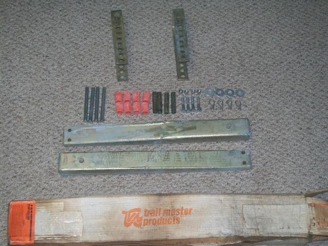

Ever hear of a old school Trail Master Traction lift? You get a traction bar that is also a 2.5 lift block. Sort of works like old slapper bars. But is secured to the front of the rear leaf with some rollers to allow for some flex.

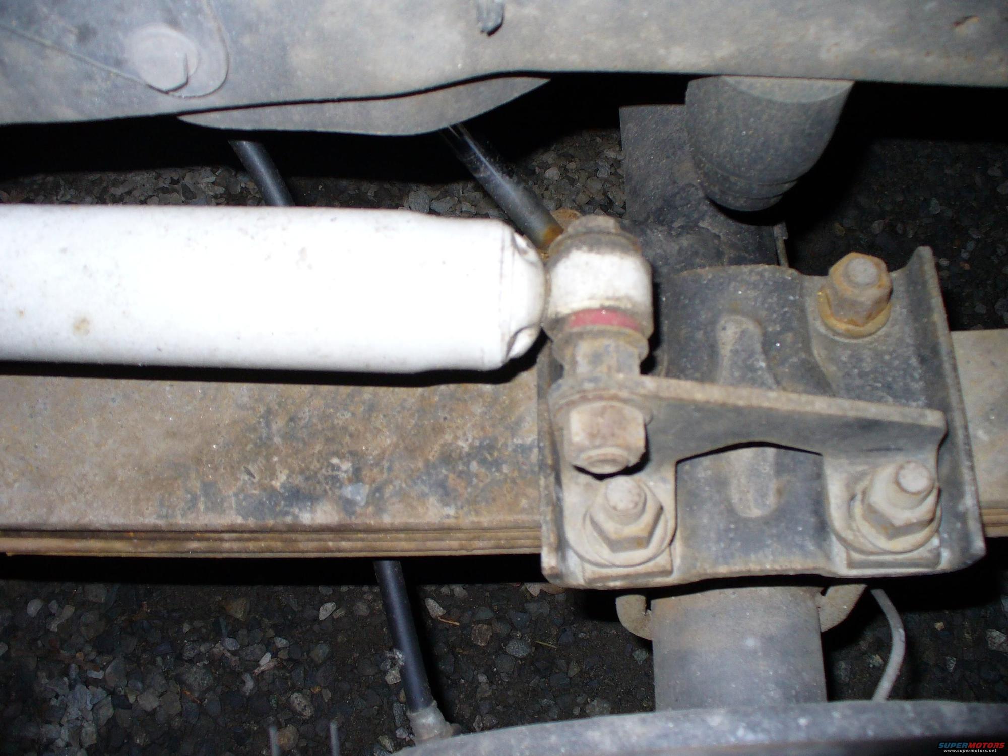

Or even another old school is a "traction shock". Mounts to a bracket on top of the leaf spring plate and then to the truck frame.
