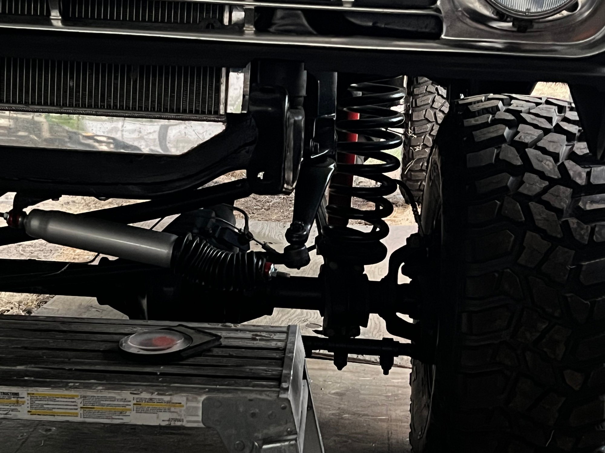

Here’s a picture of the back
and front so you don’t think I complete moron lol

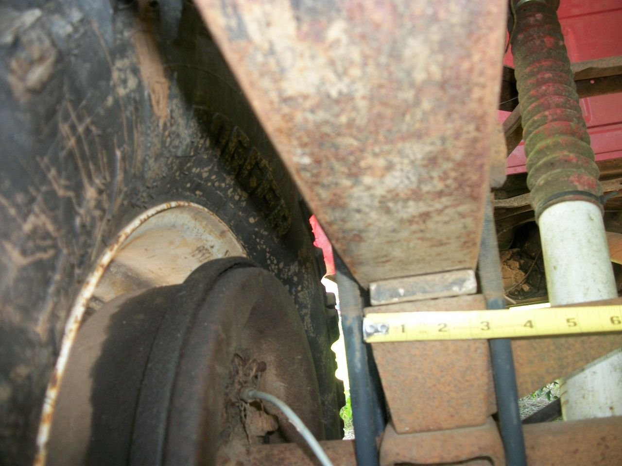

OEM rear block if 4x4, cast steel, 3" on front face and 3-1/4" on rear face to angle the pinion upwards a little. They have loops on one side for to "capture" the long U-bolts and they have "wings" like on the inner face to contact the snubbers on the frame.
Front had no blocks, the coil springs set in cups bolted on top of the radius arms.
Looking closely, I can see that the track bar and drag link are at two different angles, which means they swing the other end through two differing arcs on bumps and dips, the pitman arm is offset but not the track bar mount. That truck will have a great deal of bump steer.

No one thinks you are a complete moron, it's all good. Does is steer a little off and have the "bump steer" tbear talks about? The truck looks like it might need a trac bar drop bracket. Optimally when you lift a truck, you try to get the trac bar and the drag link parallel with each other, at least as much as possible by using a trac bar drop bracket to lower the connection point of the trac bar at the frame. Or use a adjustable trac bar (longer needed for a lift) to help re- center the front axle under the truck.
https://shop.broncograveyard.com/Dro...oaAjpiEALw_wcB
https://suspensionconnection.com/197...wcB&gyear=1972

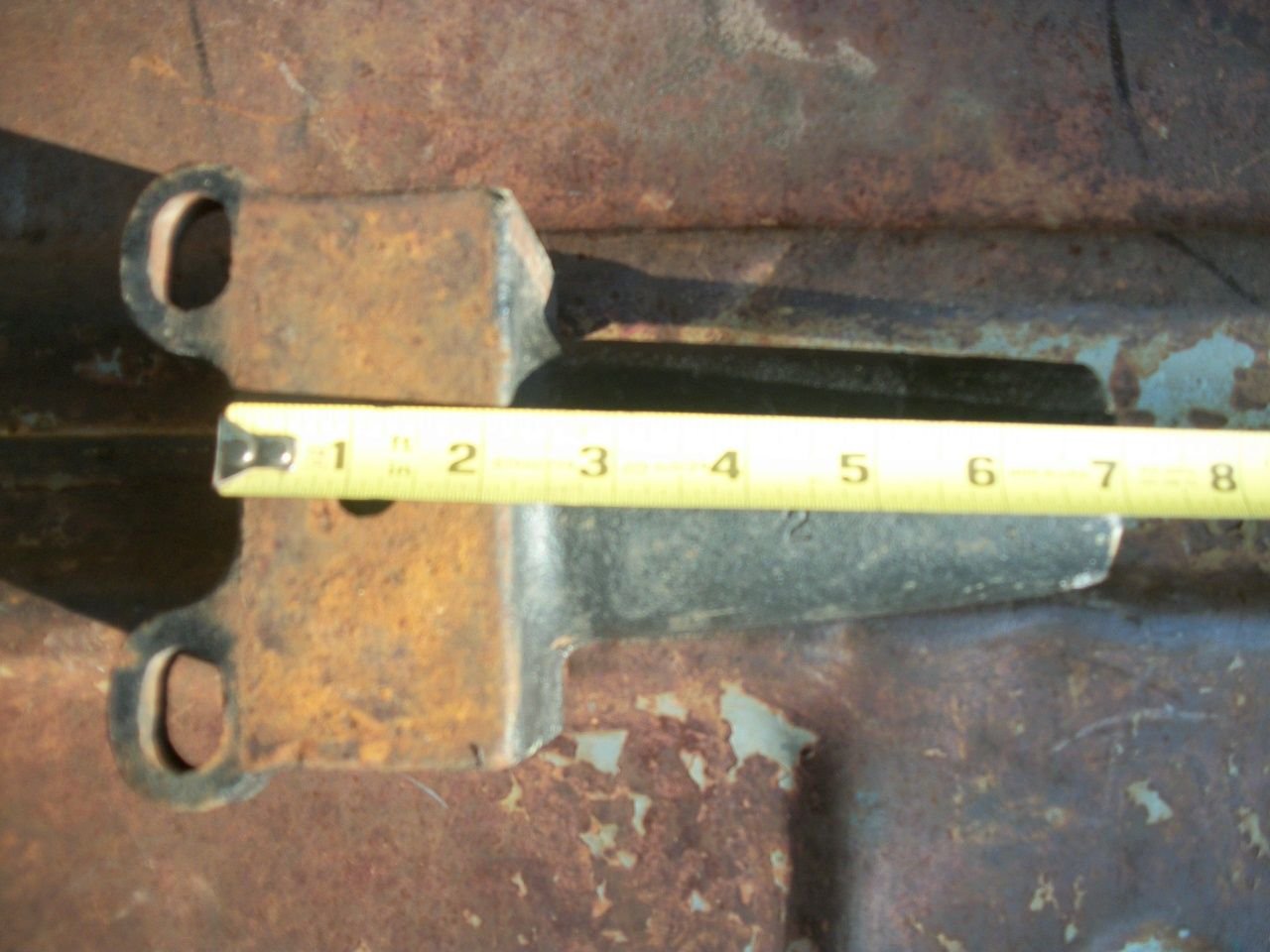

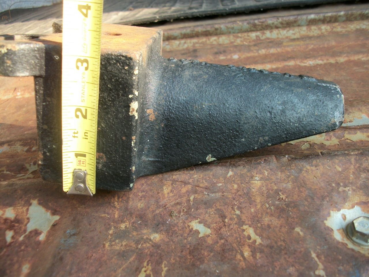

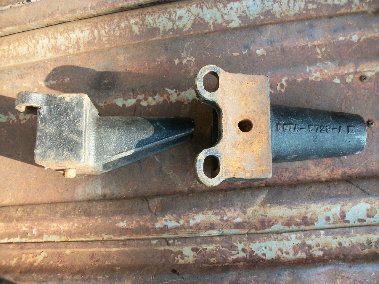

Well as far as those "loops" I have seen them on highboy truck rear blocks, but my 4wd 79 F250 did NOT have them. Some I had setting around the shop.
Maybe this engineering # can tell us what they go to.
Top one has the pin (on the bottom) of it to go in the axle leaf spring plate. The lower shorter/wider one, does not have the bottom pin to go in the leaf spring plate. But is has a hole you can drop a pin thru.

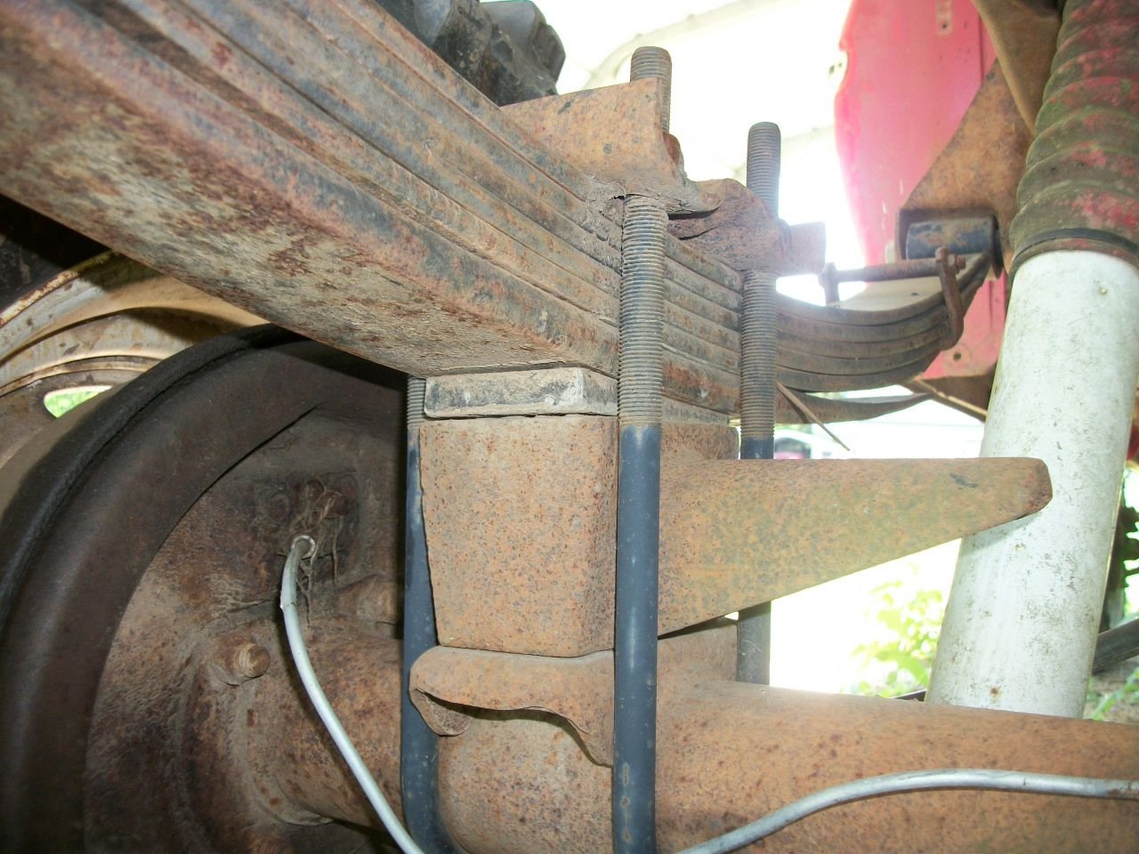

1979 4wd F250 with Skyjacker 6" lift replacement rear leafs. I had to reuse the rear block.
Look Ma no loops. But is has a pinion angle shim that came on the leaf spring.
Yes the inner wing is for your bump stops.

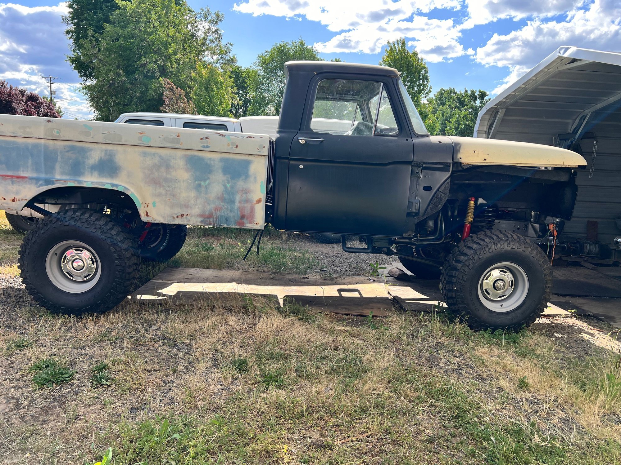

Thank you vary much for this info. I have not drive truck yet. This is my first lifted trk. So all new to me and obviously somebody else did the lift or else I would know about it. I will check into getting a drop bracket for the drag link.
Here’s what the truck looks like now except for the front fenders and grill and everything are on it now. 66 body/76 frame.

Way cool, I like the steel rim and hub cap set up, it look right at home there. And the rest looks pretty cool also. So just to ask why do you want to remove the rear block? Are you afraid of it power hopping under acceleration? Obviously you do not know, since you said you have not driven it yet...but so you know with a lifted truck and a large block back there the truck can be prone to power hopping since the block acts as a leverage device for all the wrong reasons.
