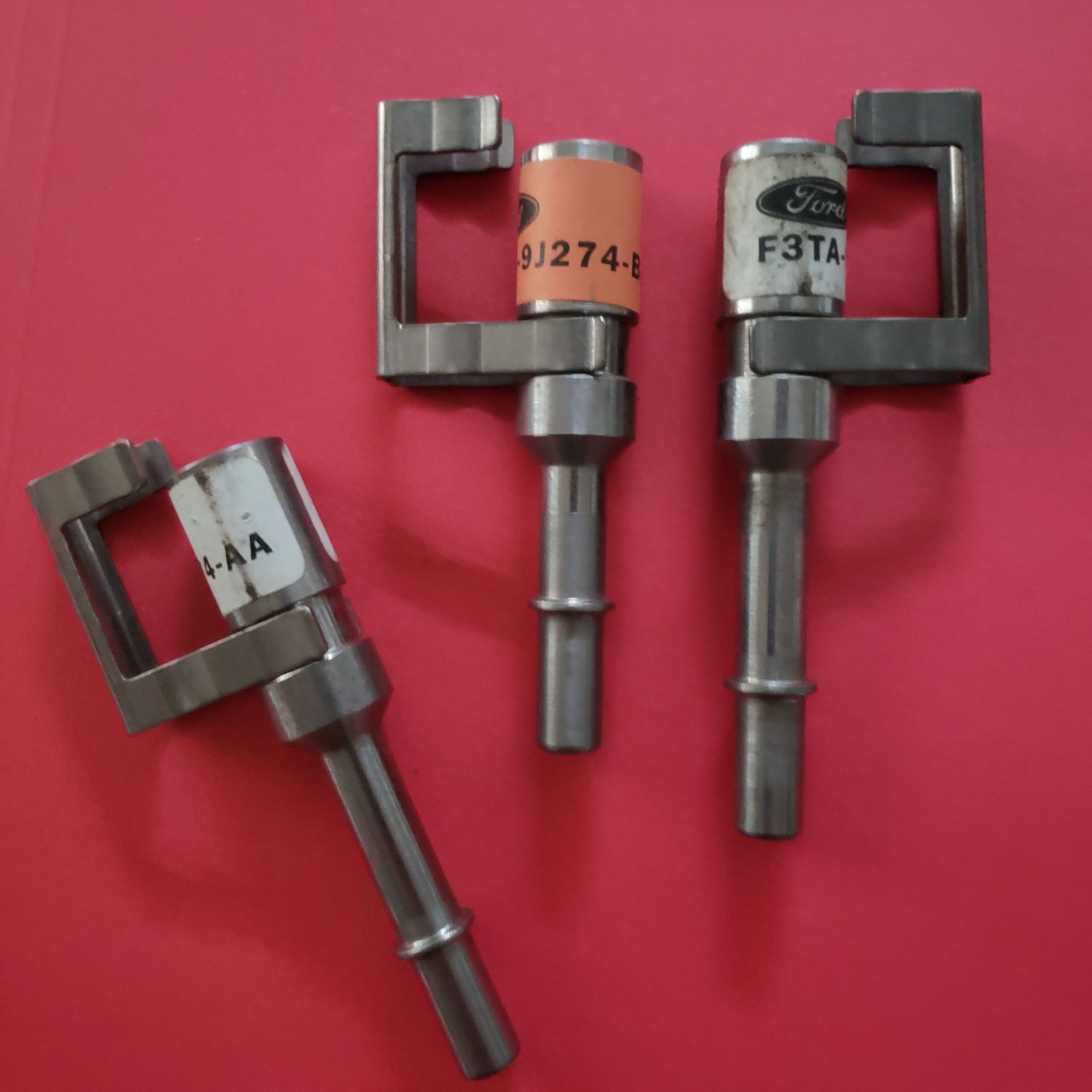

After putting 3 pumps in my 04 Heritage, I resorted to putting one of my (expensive as hell now) one way valves on it
Look for one of these at the junkyard on a 1993-1995 truck
Or pay big money for one on Ebay
I still look for these at the junkyard when I remember to. Worth 300 bucks a piece on Ebay. (I give mine away) out now
I will have to keep an eye out for these. I just noticed again that my rear tank is filling my front tank. Another defective fuel pump!
Where would these be installed on the 93-95 trucks? Are they placed on the pressure output right at the fuel pump? I'll have to take a peek next time I'm at the pick and pull.

The external check valve goes on the supply side of the pump. It's a band-aid fix for a failed check valve on the output side. If the shuttle valve on the return side is bad it will not "fix" your problem.

4) For the check valves, there's TWO lengths of the check valves. See the photo in Post #2 from @manicmechanic007. Due to clearance issues with the bed, if you use the longer check valve, the hose kinks slightly and the hose rubs against the bed. I need to source the shorter check valve (which to my dismay - none of the local pick and pulls have). The shorter one is the one with the orange tag in @manicmechanic007's photo. EDIT - @manicmechanic007 just schooled me. The shorter check valves are for the lines with the plastic retainer clip. If your fuel lines need that special disconnect tool, you need the longer check valves.

The longer check valve is for the metal lines (extra room to use the special removal tool)
The shorter ones are for the plastic lines with the removable retainer
If you put a short one on a metal line, you'll never get it back off without a cutoff wheel
Right, those try to kink the lines when installed
I bend the line coming out of the sender, when installing one, so it has more clearance to the bed
Oh man. Thanks for letting me know that!!! I've got the metal lines. I'll head back to the pick and pull and grab those longer ones and just bend the lines coming off the hanger/sender unit.
