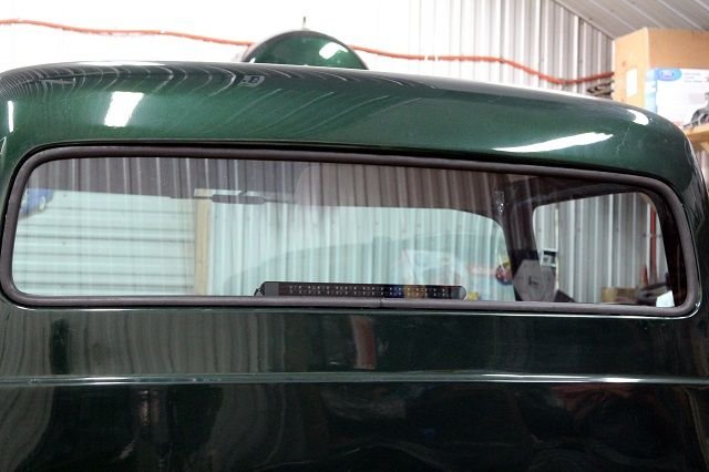

You can buy fairly cheap LED strip lighting and make you own frame to mount in the back window which is what I did for mine..cost me $10 plus a piece of scrap MDF that I routed out to recess the strip lighting in and painted black. Serves the purpose..used 3M tape to mount it to the window..

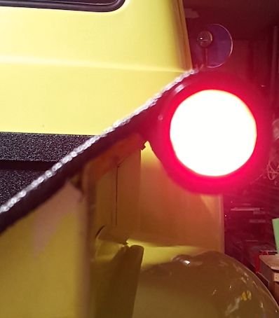

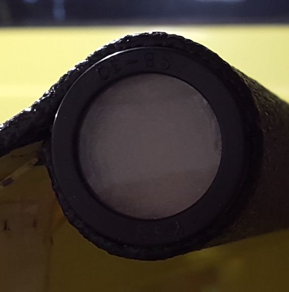

I made my own bed roll lights.
https://www.ford-trucks.com/forums/1...ll-lights.html
I recently added a fogged lens to the snap ring. It is just a piece of plexiglass.
I could only find 12v led bars when I looked for them. Did you find a 6v or is yours 12v? What am I thinking 56’s were 12v?
