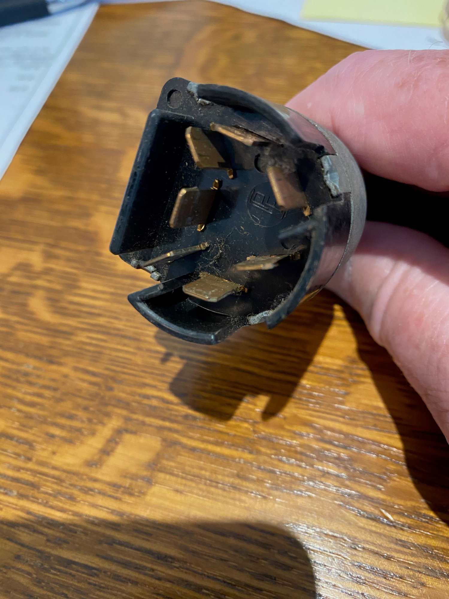

Rewiring my '66 F100. It has 4 wires going to the wiper motor, but 7 spade contacts on the switch. None of the spade contacts are labeled, so I don't know what's what. Does anyone have a pinout for this switch?

I attached a link to previous post of a two speed switch. There seems to be the pump circuit with power into 950 and 941 sending power to the pump. Power enters the wiper circuit at 63 and 56,58,615, and 763 connect to the 2 speed motor. Thoughts?
