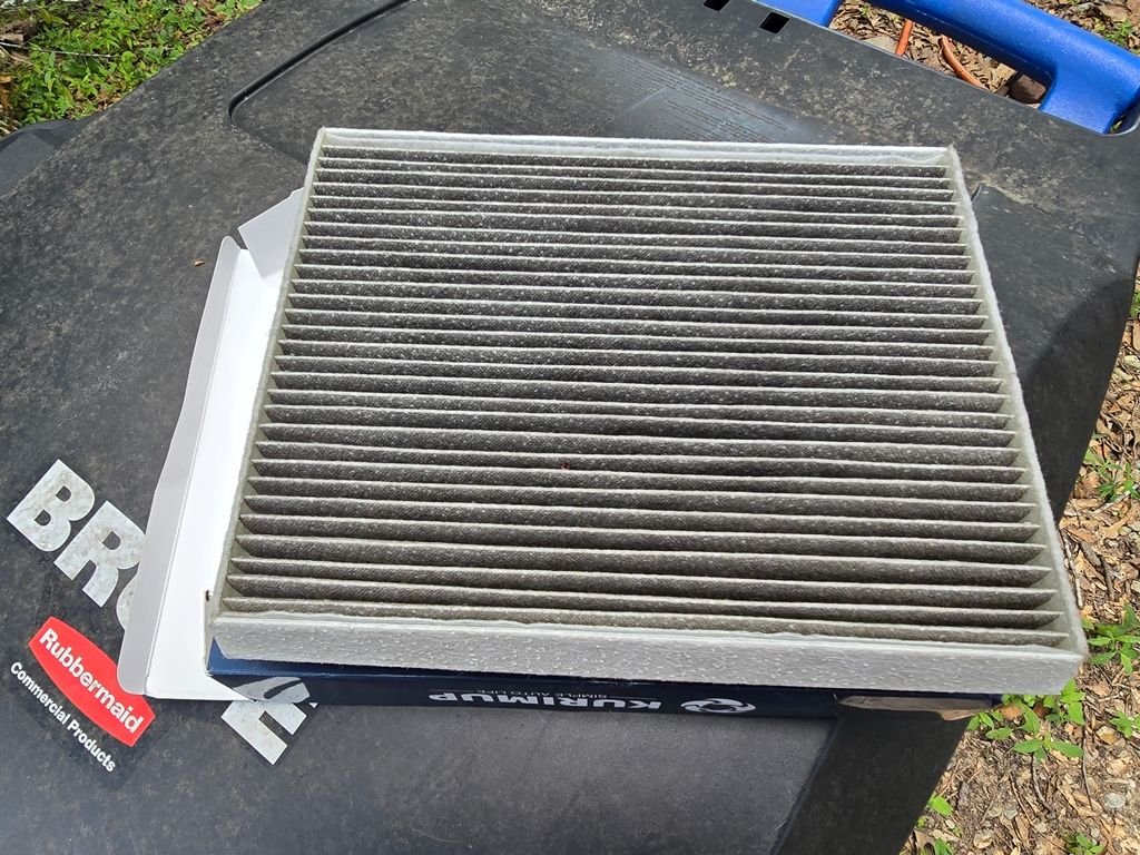

For some reason...
The a/c wasn't working as well as it used to...wonder why???
Actually, not nearly as bad as it could have been since I had never changed the cabin filter before, so almost three years of use!

Where is that located in the cab ?

No way! 10 minutes and a 7mm nut driver.
If you drop down the glove box, You'll see a plastic insert with a couple of screws. It's behind that.
Behind the glovebox. If you have a higher end trim you need a trim tool or I have used a paint mixer stick to pop the nicer trim loose, or you can man handle it like on an XL if you don’t care and have enough practice.
Youtube video will help.
I was able to get my fingertips under the edge of the rubber trim piece that hides the scews behind it, and pull it loose from the right end, then pull the left end loose.
The thing I kept doing was leaning against the passenger seat power controls, causing the seat back to lay back and the seat to move back, too bad there isn't a way to turn those off temporarily.
:-) Pull the fuse
