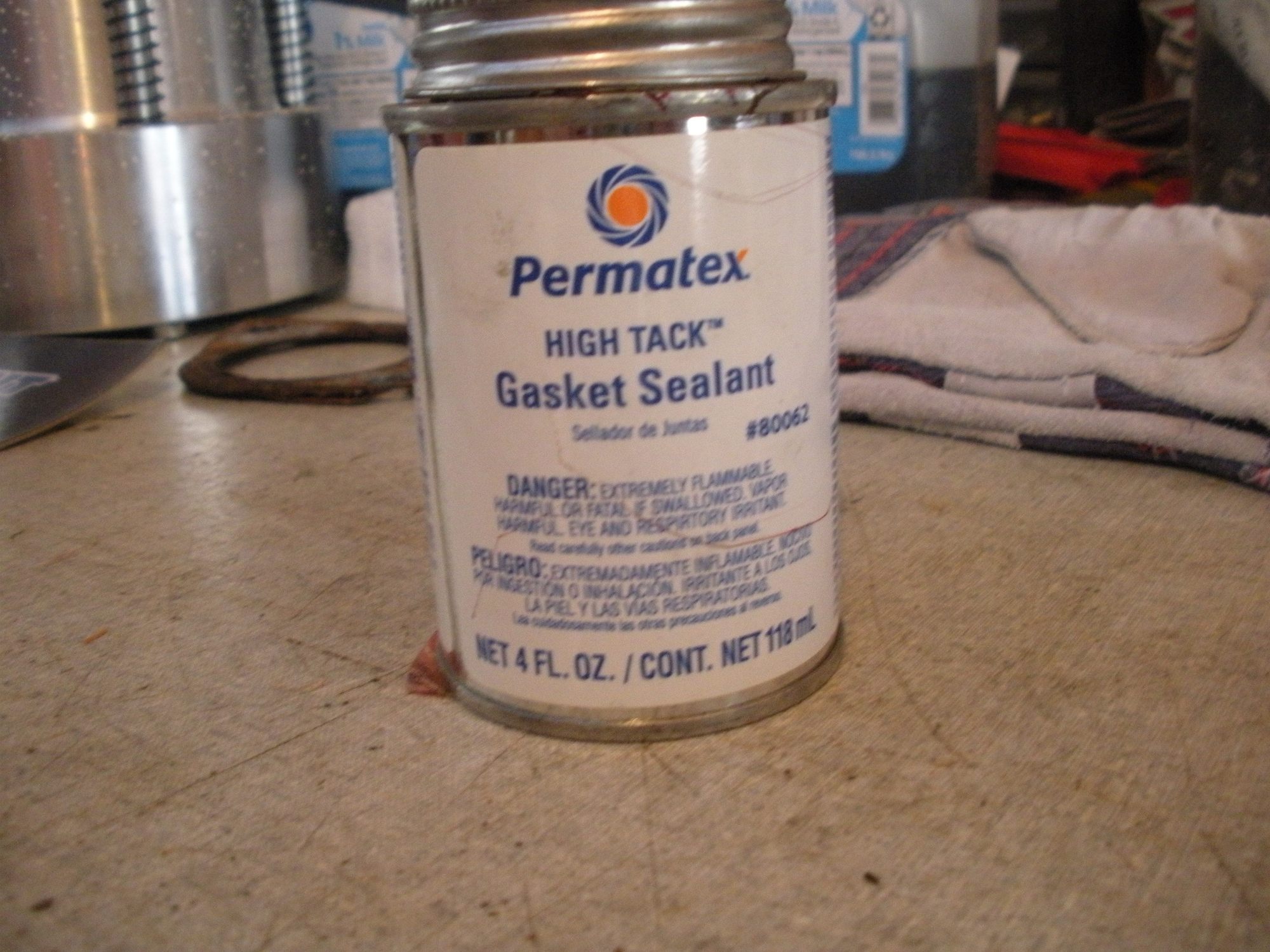

I was told by one of the trusted members here to use this to seal the gaskets.

Man, I dunno @Max Capacity , I would use that sealer on one side of the valve cover gaskets but regular RTV should be just fine for water pump gaskets.

I use that same sealer to hold gaskets like the water pump, oil pan and side cover to each item. I also put a little grease on the other side of the gasket.
This way if I have to remove them later the gasket sticks to the part removed and is easy to clean the old gasket off the part on the bench and little clean up on the motor side.
I also used that same sealer on the freeze out (casting plugs) plugs.
