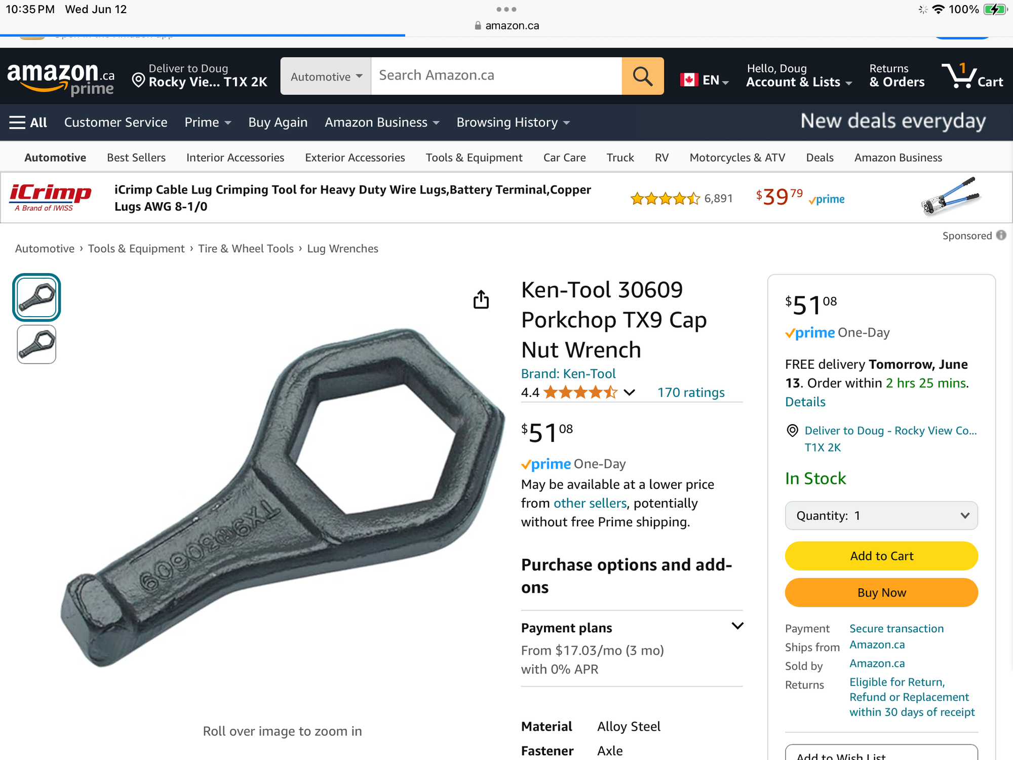

I would also recommend a torque multiplier. Even an inexpensive import would be worth while. Also be sure your helper knows about the reverse threads! As a bonus, a pork chop can help separate the inner and outer lugs.

This is the pork chop that was mentioned in previous post. Doug

Looks delicious! Thanks but this guy I'm sending over to work on the truck regularly works on 18 wheelers so I think he said he has air and a 1" impact wrench that should handle it. Thanks fotr the info.
A prokchop helps separate the inner and outer lugs by preventing spinning allowing one to harness the power applied to the socket. Without it, there is no way to harness/apply the power of the socket, even a 1" impact.

User @Muppy1840 suggests a "Pork Chop" is necessary to deal with the rear wheels. Time is running out and seller is getting antsy and threatening to cancel the sale. Question: is this socket in your experience all that is necessary to deal with the rear wheels? I will probably only have to remove just the outer wheels to put them on the front for now. Also, where to purchase this socket ASAP? Thanks for your help.

If your guy works on 18 wheelers, your guy should likely already have access to the budd socket and porkchop.
The combination budd socket isn't strictly necessary if one has distinct sufficiently deep 1 1/2 hex and 13/16 square sockets.
If you need to put your hands on either today, Napa would be a good bet, but far from necessarily being the most economical:
Prokchop: https://www.napaonline.com/en/p/ESC60301
Budd Socket: https://www.napaonline.com/en/p/NPT617826

what usely happens is the square inner nut usely stays rusted to the 1 1/2 nut . you can remove outside wheel but the square nut and 1 1/2 inch nut are stuck together on the outer wheel. i had never seen a porcshop its pretty neat ,we used to cut the assembly with a torch and install new nuts. thats where the porcshop would lock 1 1/2 nut while you remove the square one i guess !
