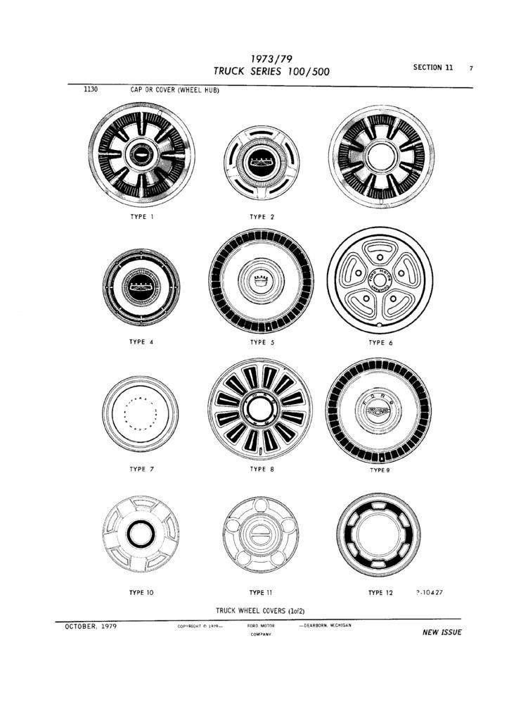

any idea what size hubcap fits a 8 lug 16inch rim,,,,,,,,,thankyou for response

12". there are a couple styles and it depends on the year and trim.

I think type 2, 10, maybe also 11 or 12.

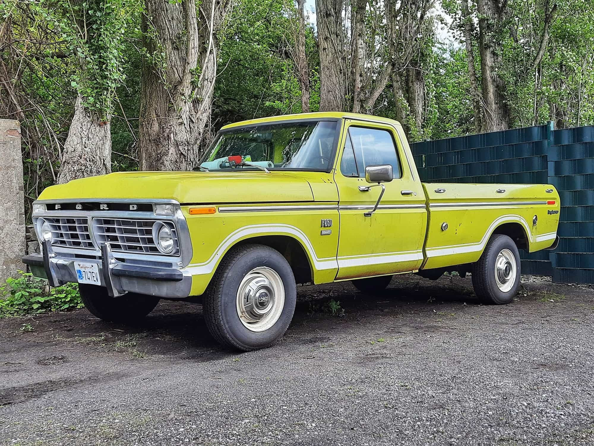

This is a 2wd F250 with 16.5 rims. Looks like type 2's.

I've never seen those caps on anything but 16's. if they're 16.5's are they 12 1/4" caps or does the wheel have 12" nubs to fit the 12" cap?
I tried putting type 12 on some 16" wheels and they fell off. they only fit 16.5's.

The above picture shows my Truck and it is type 2 on 16.5"
They also fit on later 16" wheels, the nubs have the same pattern.

The type 2 will not fit 78-79 or newer 16.5 wheels because they' have 12 1/4" nubs. so those wheels have to be quite rare, for that matter 16.5's were pretty rare until the late 70's.
I wish I could find 16" wheels that type 12 caps would fit on for my '79. but my search has fount they're unobtainium. I thought about welding and shaping the nubs up enough they would work and I might still do that.

They're 7". Most older ones are 6". when buying them be sure to check because some later ones have no nubs for hub caps.
Type 2 caps will fit them, type 12 will not.

I said type 12 caps won't fit 16'" wheels because they're 12 5/16". and that's what 16.5's use at least post 1978. and all 3 sets of the type 12's I have are that.
But I see type 12's for sale listed as 12" , which would fit 16" wheels. can anyone verify this as correct?
