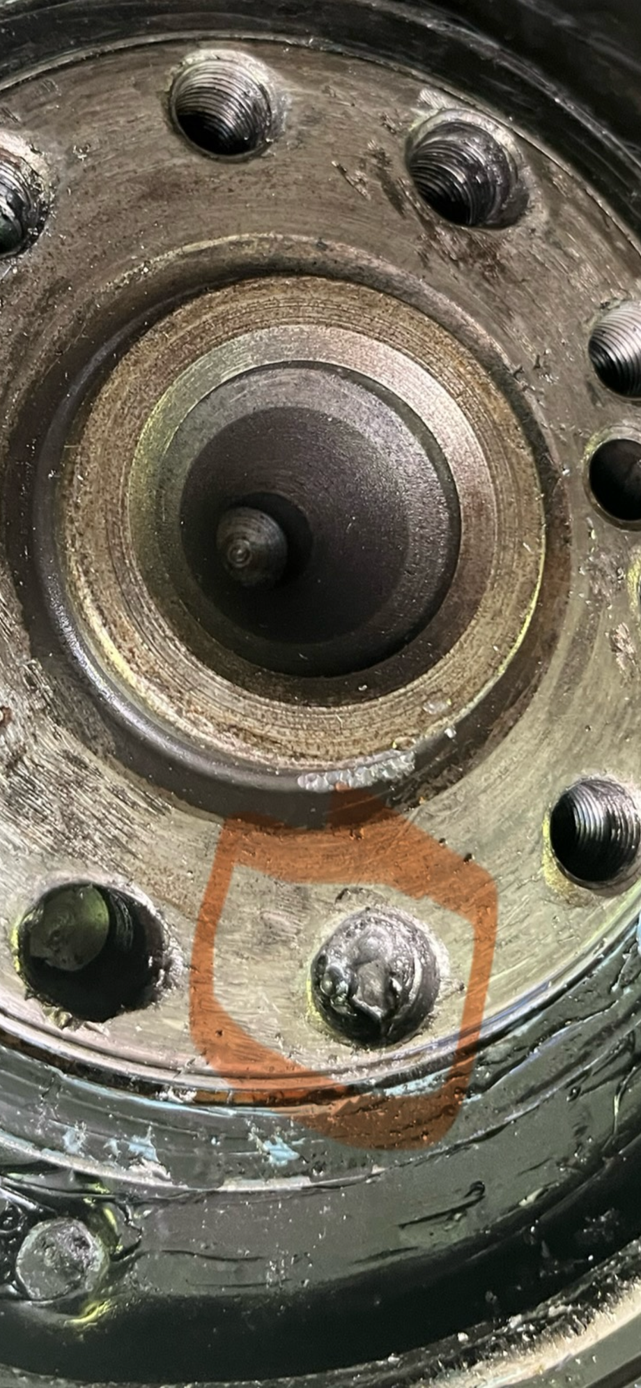

Current situation

exactly, get a slightly smaller nut and weld it to the broken extractor. back the extracter out and then try a new extractor, that or recenter the hole and drill it out to as close tot he threads as you can without buggering them. then try and easy out again. worst case you have replace the crank right? thats where you are at anyway.
To be honest i bet it would hold with 9 proper bolts and one half assed, but me being me I would drill, tap and or weld till I got it as right as possible as otherwise you are looking at a new crank or engine. necessity is the mother of all inventions. you might be surprised at what you can do to say paying for a new engine.

The "issue" with welding to the broken extractor is that is made from a high carbon steel...a steel that gets hard (and brittle) when welded. He might get it out doing as you state, as the bolt isn't rusted in place. I would try and put enough weld in the area to get some fusion to the parent bolt material....and that might still be somewhat brittle after welding.

Yeah, this has been my experience and I would be concerned about. I know it has been said, but I would run it with 9 bolts if this last one just will not budge, and then see what you get. Either way, it'll work or it won't and you'll be replacing the engine anyways? It's worth the try if you can't get the last one. If it works, no harm no foul. If not, it wasn't going to and you tried, right? A++ for your effort my friend. That one is tough.

Years ago I broke an easy out off when a crankshaft balancer bolt got cross threaded and broke off like yours are..
An older mechanic told me how to get the easy out removed, and it worked.
He told me to get several soft steel punches and beat on the hardened easy out with them and a good sized hammer.
He said the soft steel would deform and bend, the reason for getting several, but the big easy out would shatter because it was hard.
It took a couple of hours, but with three soft steel punches, the easy out broke into pieces every few blows until it was in a small enough piece to remove. I drilled out the rest of the bolt and chased the threads.
That saved me from buying a new crankshaft.
It does work.
