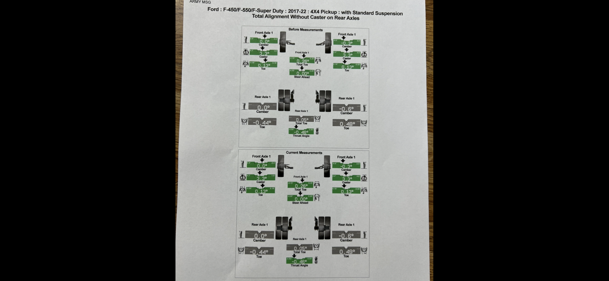

same problem on my 2019 f-450
even broke a piece of the rim trying to use a tool.
at this point I think ford started to press these in for death wobble mitigation.
I even loosened my top ball joint nuts and drove around for a few hundred holes to see if they would move…nothing.
i can tell you if you can’t get them out and want a caster change, you can do that with a pinion arm drop kit. I installed a 4” pinion arm drop kit and with a 3.5” top coil spacer I’m at 3 degrees caster. If I was going to redue I would get a 4” or 5” drop kit to try to get closer to 5 degrees.
the drop kit install was a heck of a lot easier than trying to remove the alignment bushings.
