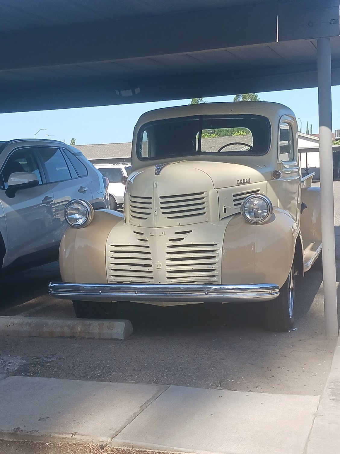

Now this is more like it. Took this shot this morning before church. Usually, a black Rogue is in that open space to the left.
I wish I had that Dodge. I would not need to pass any smog test!
