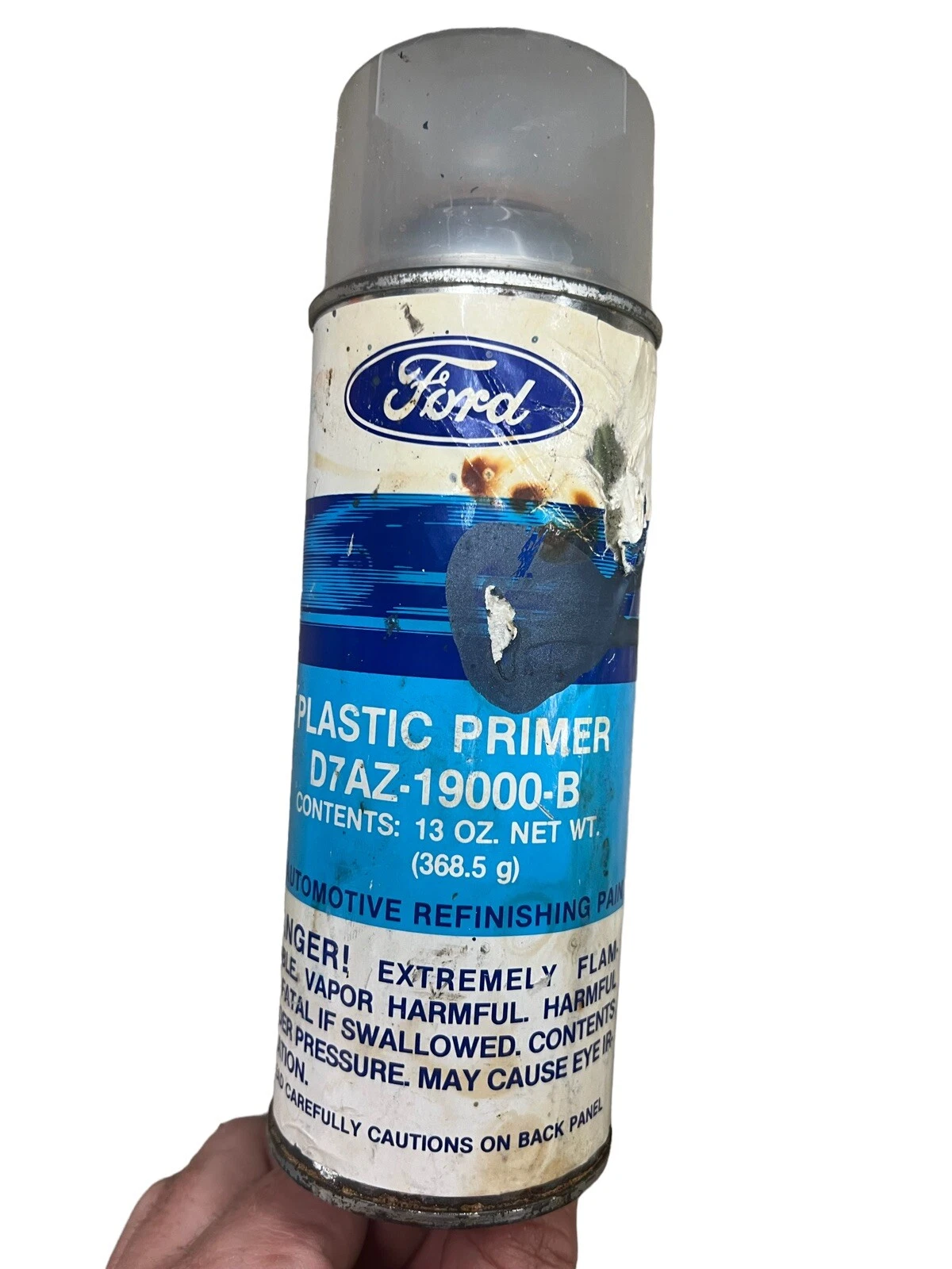

Ford had a product called plastic primer we used to use with their Ford interior paint
Most of those dash parts came neutral and had to be painted
None of it lasted forever and they would need to be repainted after about 6 years or so depending on scratches etc.

FORD Plastic Primer D7AZ-19000-B
