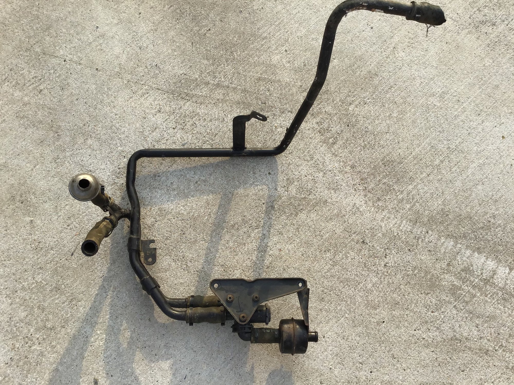

Your lucky day. The one I have is still good. It has the control valve and muffler. Where are you located. The freight will probably be high.
It was on a 94 F 250 5.8 in a salvage yard. I bought the engine for my 94 F 150.

Some of the hoses are still good.
Fortunately the gorilla that removed the engine did not damage it
Control valve and muffler . Here you go.
