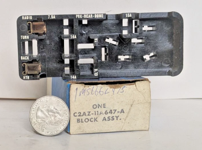

Hi guys hope I'm doing this right in not very good at using a forum so I apologize if I'm in the wrong. I have a 62 f100 4x4 and I've been having a hell of a time trying to find the fuse holder that clips on to the back of the headlight switch. Mine has gotten so old and weathered that it's fallen apart and in order to put things to OEM use I need this part old or new but at least I'm good working order. Any ideas would be gratefully taken. Thank you so much!

Your best bet is to try and find a good used wire loom. The fuse block is part of the dash loom. A new loom from Dennis Carpenter is $1,000.

The Ford replacement main under dash wiring harnesses didn't come with the fuse block but they did sell it separately. Part number changed across the years but for a 1960-1962 B-F100/600 they specify a
C2AZ-11A647-A - BLOCK - HEAD LAMP SWITCH JUNCTION
Some on eBay.
C2az-11a647-A for sale | eBay
