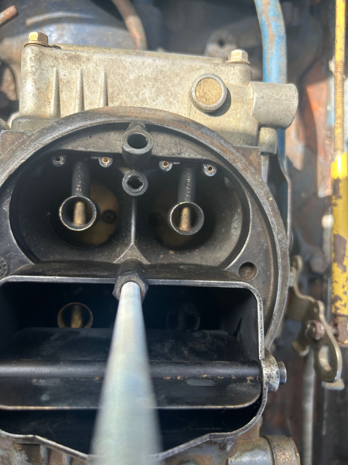

Bottom right on the carb appears to have damage, would this affect carbon build up on the plugs?
Anyone have any recommendations, rebuild or just buy new? Holley 4160 is the model.

I can't see any damage just gunk.
You have the right carb, it's just a matter of what condition it's in and if it's worth rebuilding. if it's pretty slopped out I'd just buy a new 4160 and be done with it.
If it's putting too much fuel through for any reason it could blacken your plugs.

I thought it was gunk at first as well but it turned out to be chipped on that circular part and almost as if something hit it.
The carb is a bit toast in general, weighing out the options of rebuild vs new.
It seems like it just dumps fuel.

As long as it's not broken it probably doesn't matter.
It looks like an older one, probably no power valve protection so if you have a blown one it will run very rich.
There does come a point where it's best to just buy a new one. they say nothing lasts forever but a lot of people seem to think a Holley carb should. just because they're easy to rebuild doesn't mean they're as good as new. I have new electric choke 4160's on my 428 CJ, 429 and a couple 460's . yes a 750 is over kill , but they all run perfect.

Is that "DAMAGE" ... or is it "GRUNGY GUNK"? It was in the darkest hole in the picture.
If damaged, I wonder what hit it.
If grungy gunk, it'll clean.

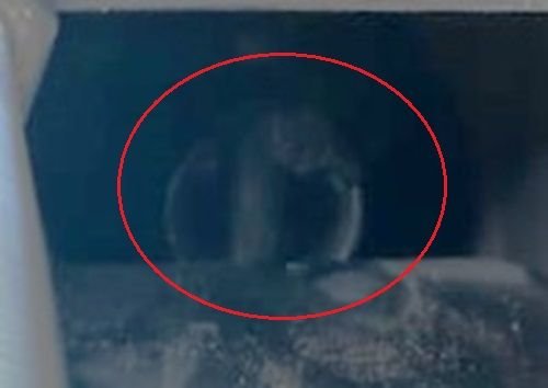

Looks to be melted from a carb fire from backfiring. Seen that before.

Apologies for the poor image, too lazy to go back outside and take one.
It appears to be damage, another comment said melted and seems consistent with that.

Years ago I had a Holley given to me that had a melted booster venturi from a fire.
I sent the body to Holley and they replaced the melted venturi.
I don't know if they still do that or not.
