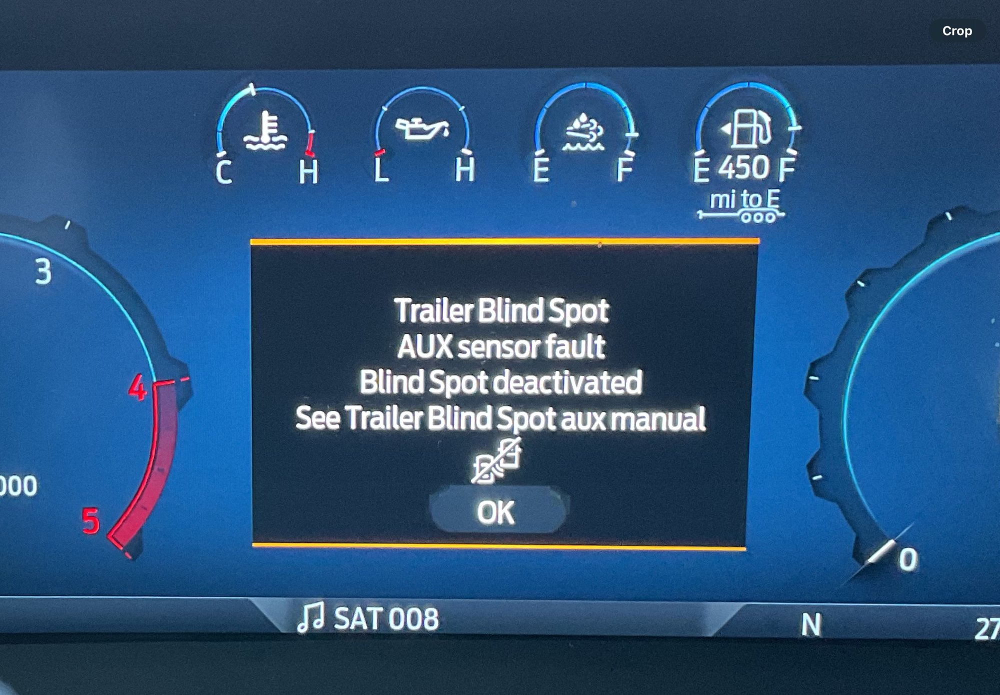

Hello ll. New Ford F350 here and learning. The mother hen messages irritate me when I hook up my gooseneck trailers. Is there a way I can turn OFF the BLISS system when towing for all trailers and leave it on for non-towing driving? I want to stop getting these messages…

Nope, to my knowledge there is no way to deactivate these messages. I have tried, but Ford thinks it's something you need to see. every. time.
If it's any consolation, even with the sensors installed you still get warnings (specifically, "cross lane traffic alert deactivated")

I've never enabled the BLIS with my trailers on my truck. My understanding is that it would work if I had a narrower trailer. My bumper pull trailer is as wide as a fifth wheel, so that would block the BLIS sensors in the tail lights.
I do get the warning that BLIS is not enabled for the connected trailer. I have the full TPMS/camera system that was available for my model year.

I have had success entering my 102" wide Gooseneck deckover trailer as a bumper pull trailer, and the BLIS seems to work fine. The only reason I can tell that Ford disables BLIS for Gooseneck trailers is because the hitch pivot point is over the rear axle and may give some wonky BLIS alerts during turns. I haven't experienced anything weird and it works fine on the highway configured as a bumper pull trailer. May be worth a try.

Ya know that crossed my mind but haven’t messed with it yet. I’ll try it today later when I’m hauling some horses. Thank you for the info sir!

Set my 24’ stock trailer that’s 6’ 8” wide to conventional from gooseneck. Plugged in the correct length and width. BLIS worked trailering as it’s supposed to. Thanks KeystoneF350 for the tip!
