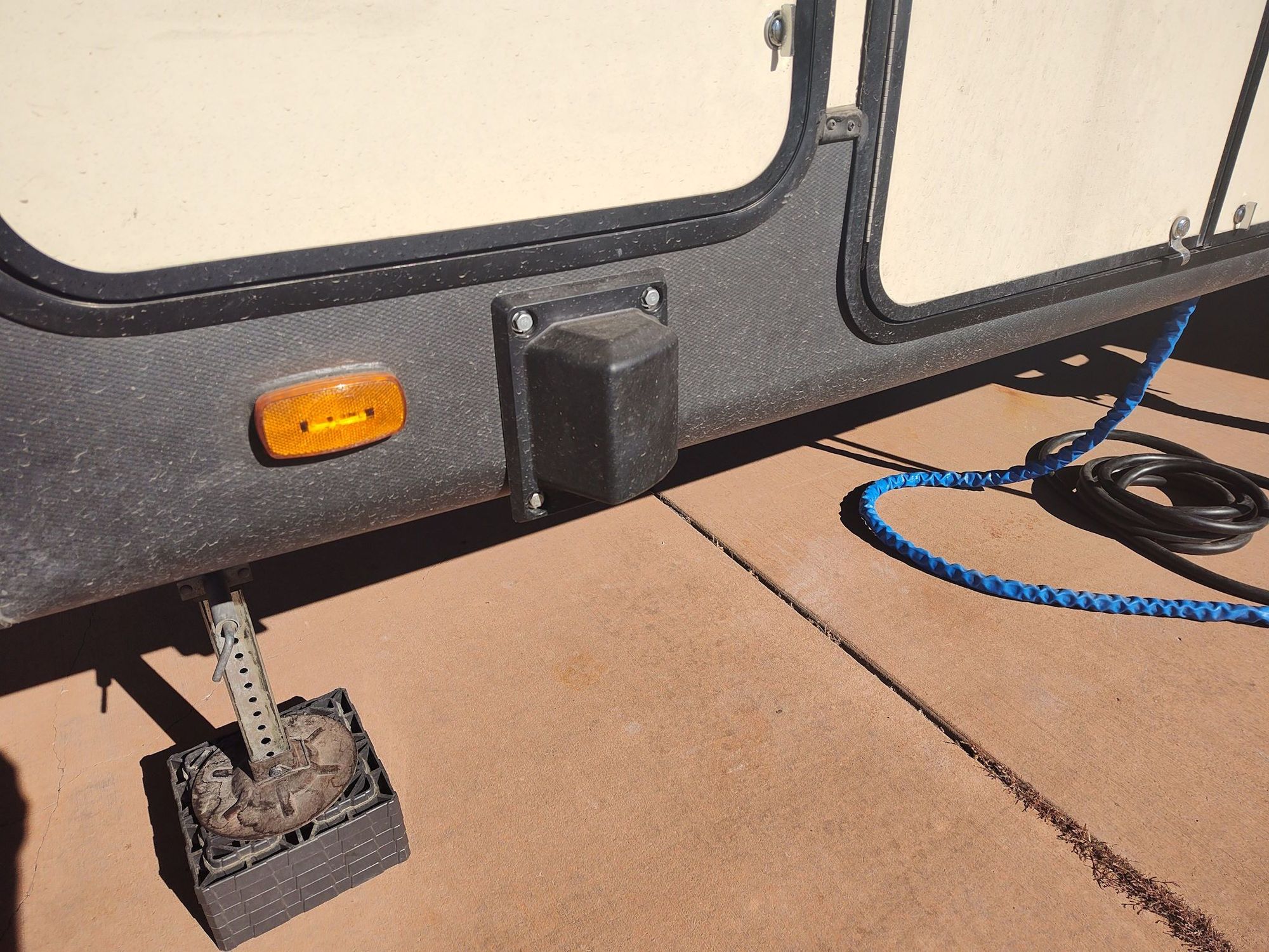

I've purchased and installed the Trailer BLIS kit for my 5th wheel. Overall the sensors work most of the time, but I think it's pretty expensive for what it does. The main advantage of the system is that it lets you know when your tail is clear for changing lanes. But the 360 side cameras pop up when you signal, and the hard-wired trailer camera (a much better option) shows you if it's clear back there, so the BLIS kit's actual value seems pretty marginal. Also, the cross-traffic BLIS warnings (the blinking BLIS light/audible warning) are disabled when towing, even with the trailer BLIS sensors. That would be a useful feature if it was still enabled, but it's not, which is somewhat mystifying to me. When installed and towing it does give you one less warning to click through on startup which is nice, I guess, but it's probably not worth $700.
In terms of install, it consists of two sensor boxes (one for each side), a + shaped harness that inserts into the TPMS harness between the harness and TPMS sensor receiver box and 8 bolts and nuts. The sensors are supposed to be mounted very far forward and low to the ground, probably so they work with gooseneck horse & cargo trailers, which did make the install a bit interesting for my 5th wheel. I ended up having to cut out a steel backing plate and attach that to the trailer, and get some shorter bolts for the lower half to get everything to fit along my trailer. But it does work. Here's a picture:

Thanks very much for your response and this information, and especially the photo. I already have Ford trailer TPMS running on my existing truck, a 2017 F450. I wonder if the trailer BLIS system would work with it? Obviously, the cable would be the same, but I'm guessing the truck is too old to recognize the feature. Did you install the 360 cameras on your RV yourself? If so, how difficult was it. I already have the Ford rear camera, so how many more cameras must be installed?
