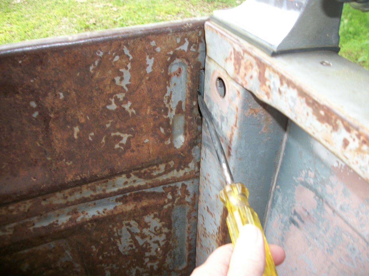

The screwdriver trick. See if you can carefully slide/pry the entire tailgate to one side a little, to give you more eye ball/screwdriver tip room in the opposite side.

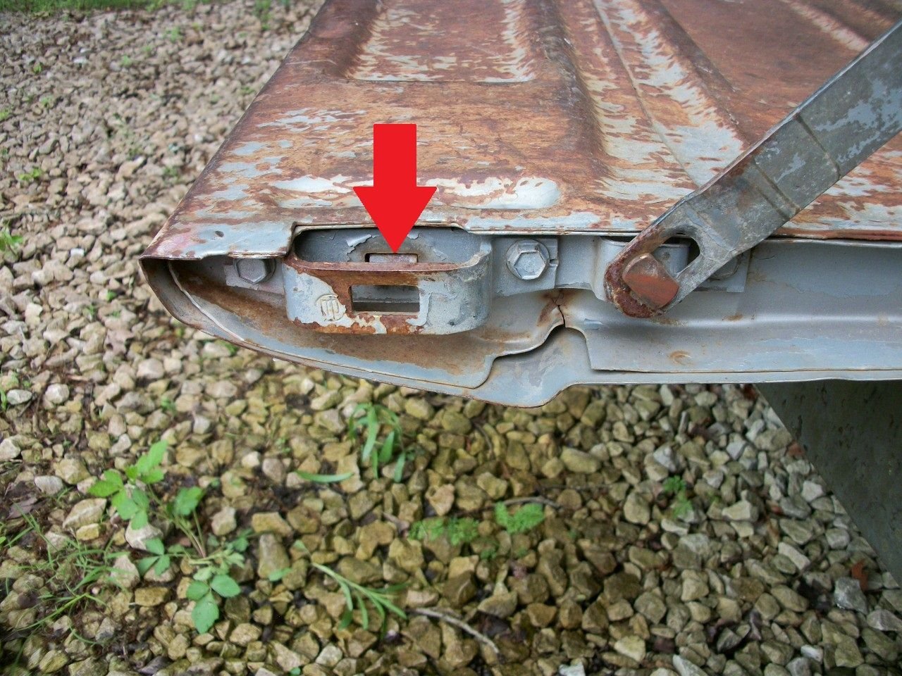

Red arrow is angled piece inside the metal outer "bar" is what you want to pry on, ever so slightly. Having a helper on the handle helps to pull the other latch rod to the opening position, as you screwdriver it from in the bed.

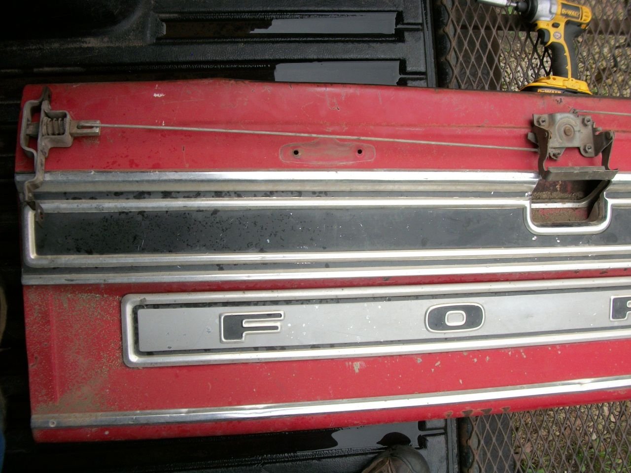

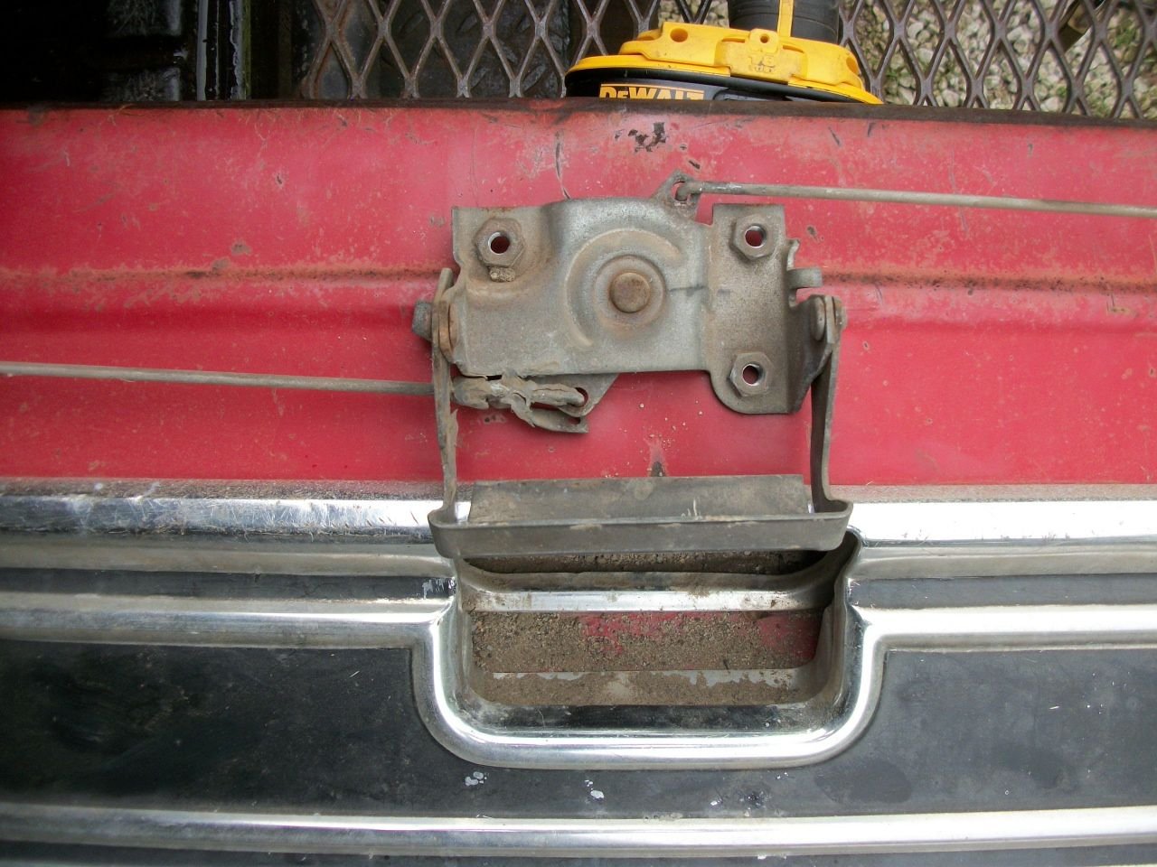

How it looks inside.
Home made rod lock. A piece of sheet metal and some silicone.
