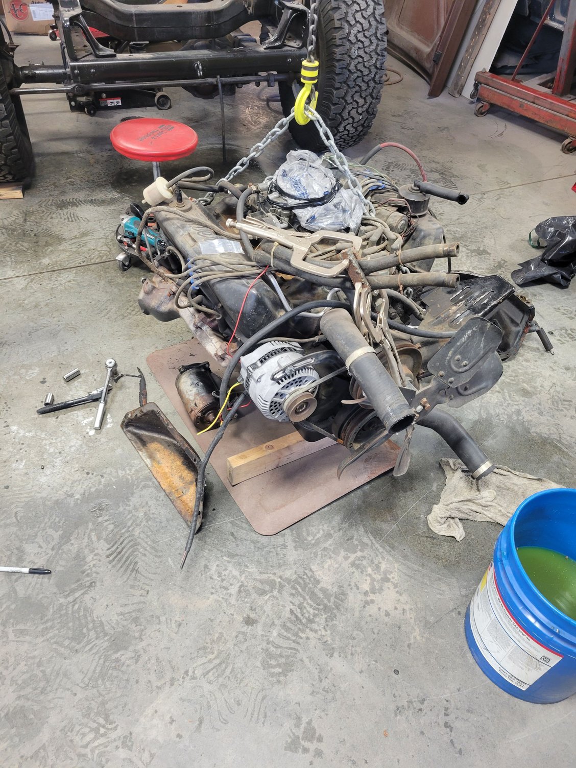

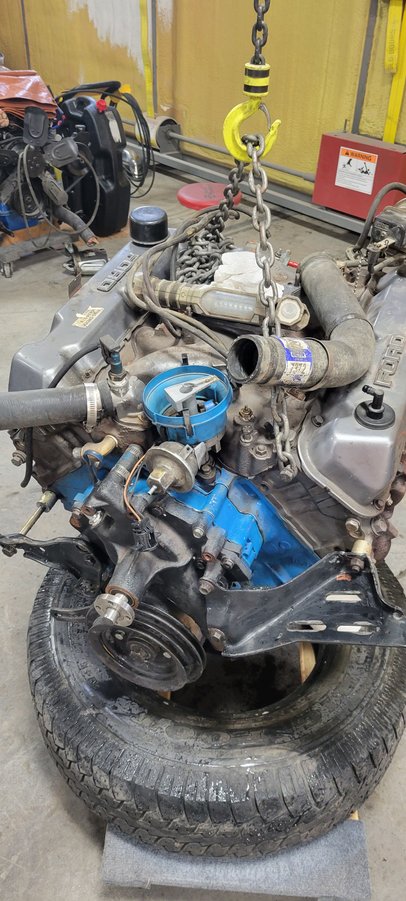

Originally Posted by nutter3
Agreed, the Al intake would worry me. And I'm not worried about the grade 8 or grade 5 studs. It's the aluminum threads it is threaded into. Use the harbor freight leveler for ultimate control. I just use a chain into the heads.
Interesting! Hook / Bolt the chain to where exactly? Would you mind sharing a picture?
Cheers, MarKus
Old Apr 7, 2024 | 10:20 AM
nutter3's Avatar
nutter3
Joined: Jan 2014
Posts: 1,077
Likes: 500
From: Kenai
Jpegg01
