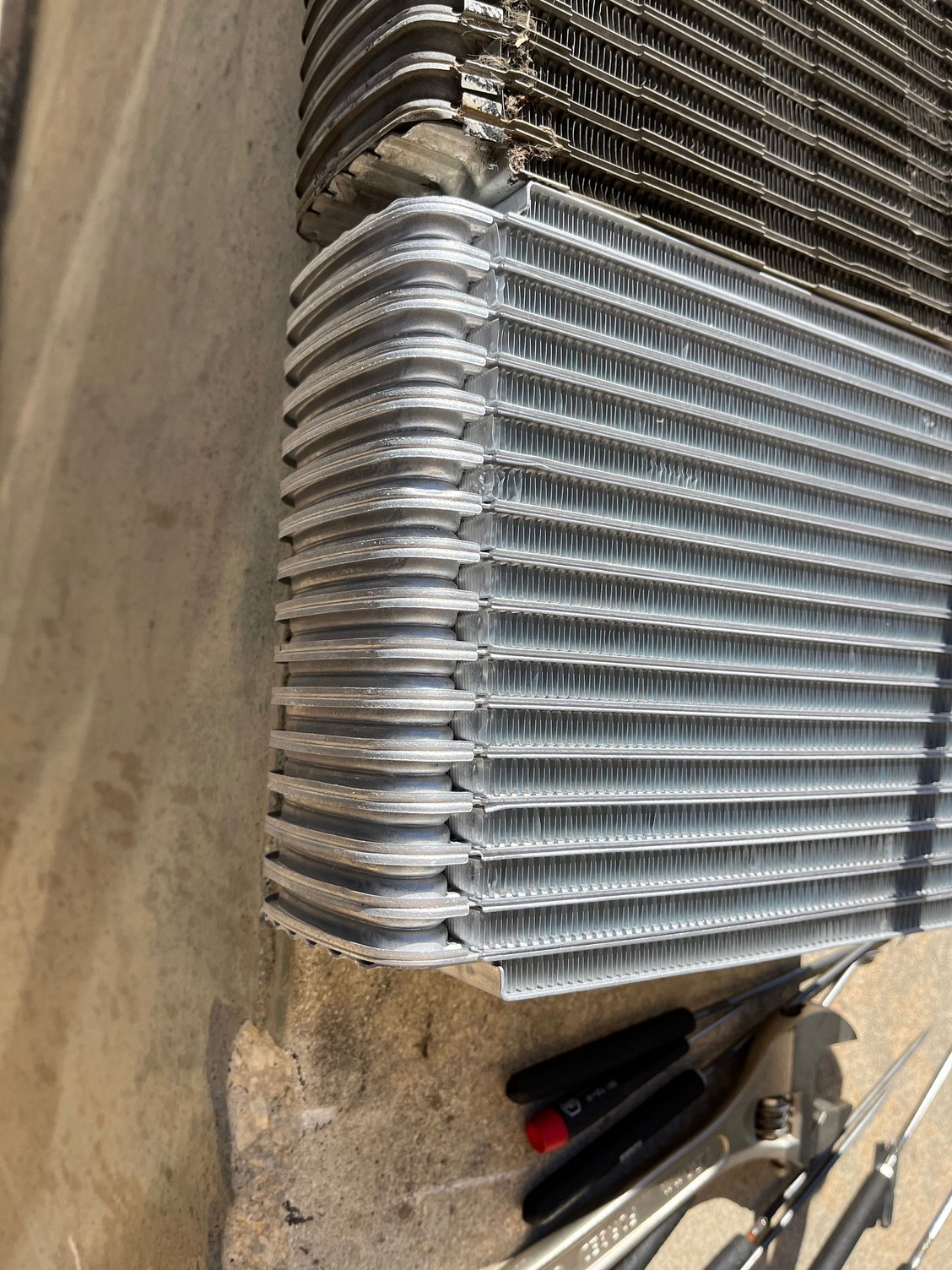

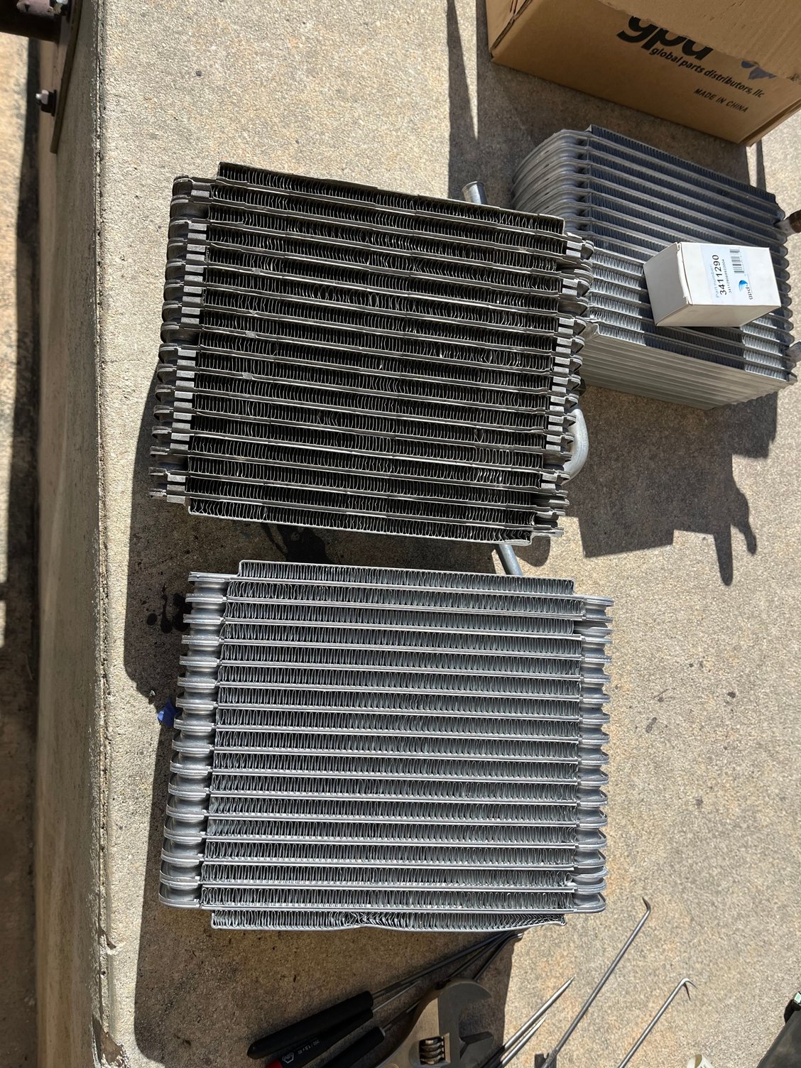

new evaporator

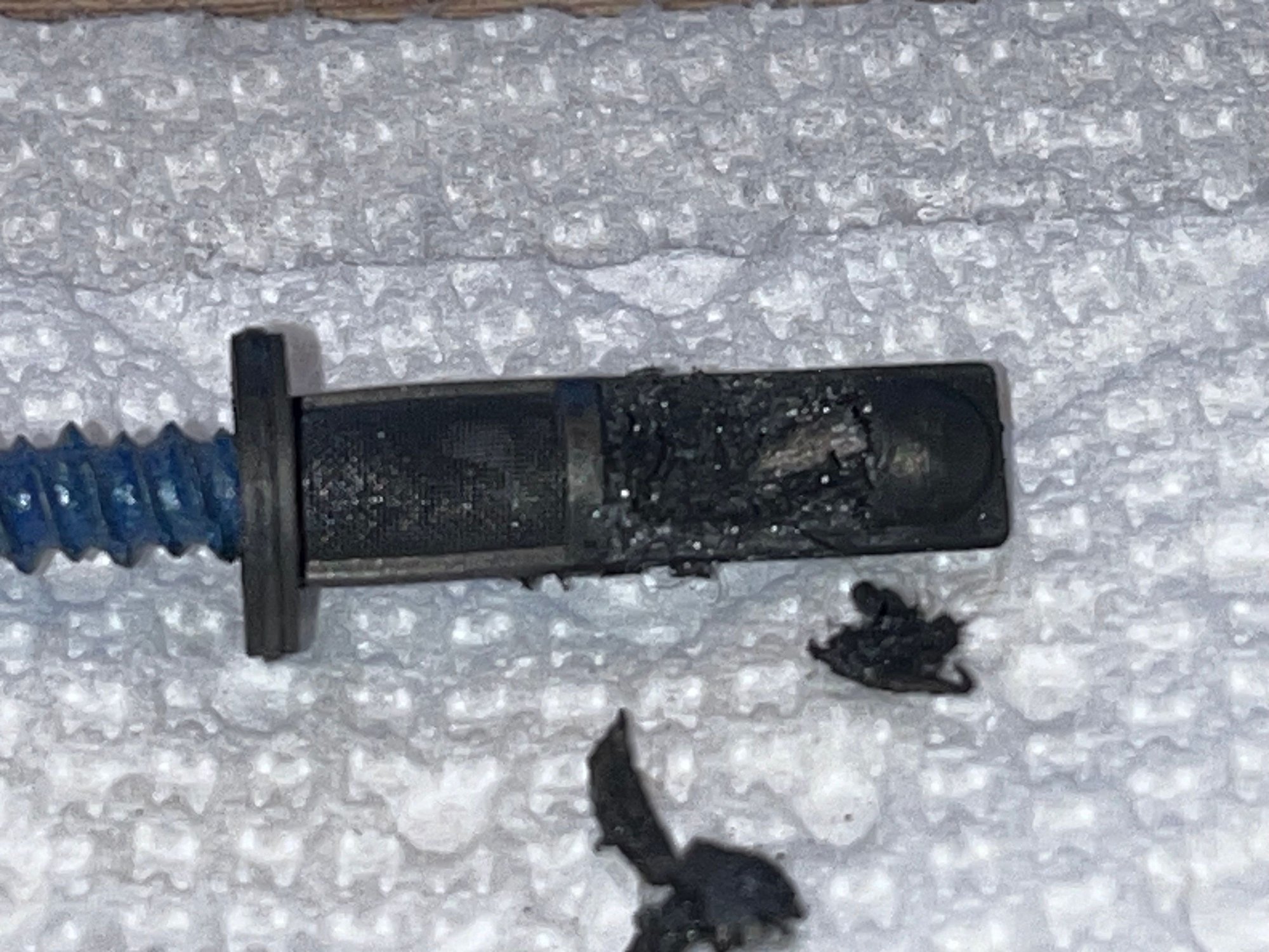

new orface tube

I found debris in the lines, clogged condenser coils, bad vacuum lines, stripped fittings, loose foam on mixture panel in rear, and a bad mixture motor in the front.

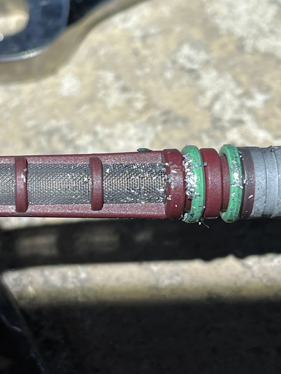

There is a orface tube in the front to regulate refrigerant, and an expansion valve in the back for the Aux AC. ALSO, Right after the small refrigerant tube turns upward towards the rear, there is a $2 in line filter. Mine was completely clogged. Make sure you replace this after flushing the lines.

New vs old
New vs old
