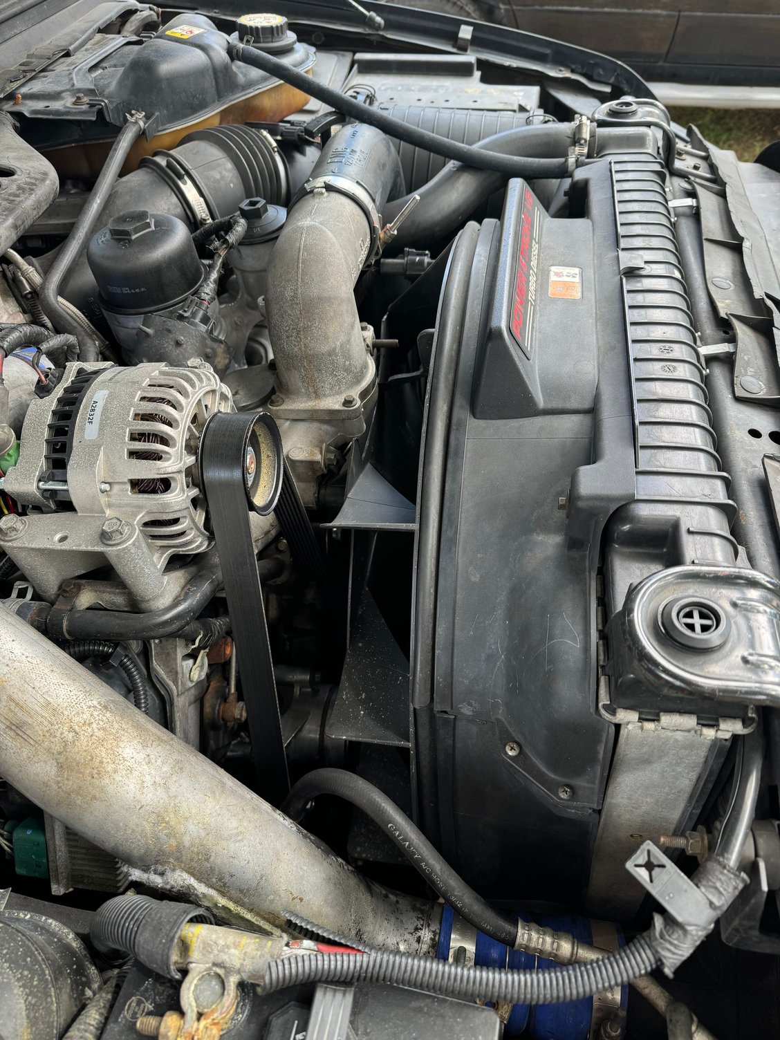

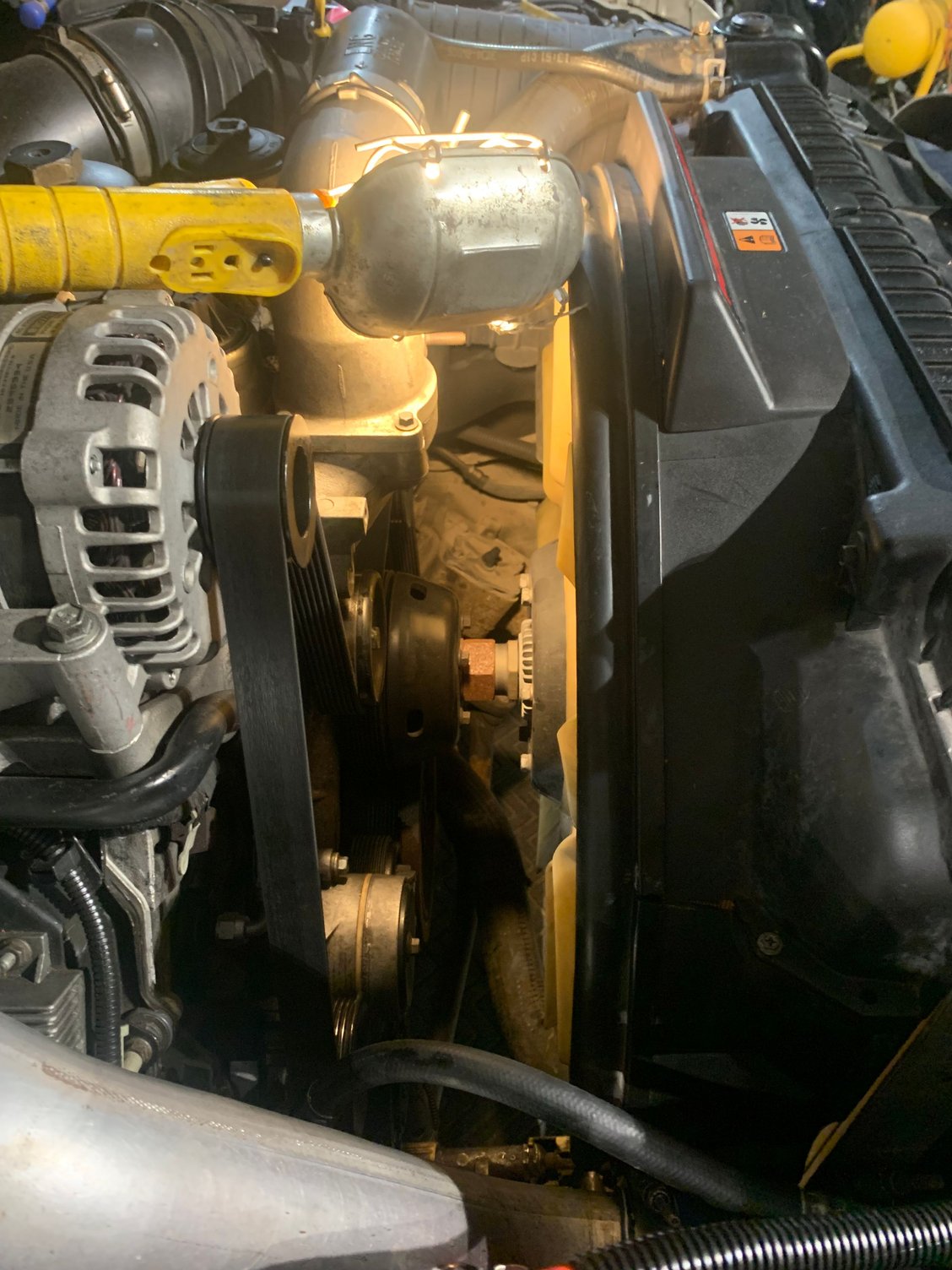

@Tylus I'm thinking you are on to something here, as you said, I'm starting to think this is an airflow issue.
I have owned the truck for a few years, but I think the previous owner removed part of the fan shroud.
I'm wondering, to your point, if I'm sitting at a stop, the issue is probably more airflow related, as it cools off if I rev the truck.
Here is what I have, I'm guessing I'm missing pieces of the fan shroud :

It’s raining or I’d snap a pic. But yeah the fan shroud is very snug fitting in there. You shouldn’t see anything at all.
random. Is that a 6.0? And is the EGR unplugged?

@Tylus I think im missing the Fan Stator cover.
Yes, same truck as yours (but not the limited) , 2005 Ford Excursion, 6.0L
EGR is connected, not sure what the previous owner did to the truck exactly, im still in the process of learning it

Was wondering because 6.0’s with 2006/2007 PCM strategies will have the fan quit working when EGR is unplugged. Your 2005 is likely to have the this strategy because Dealerships upgraded it anytime they worked on them. Looks like yours is installed and plugged in.
even with the clutch shroud missing it should still have decent air flow across the rad/condenser. The actual fan shroud is still there
