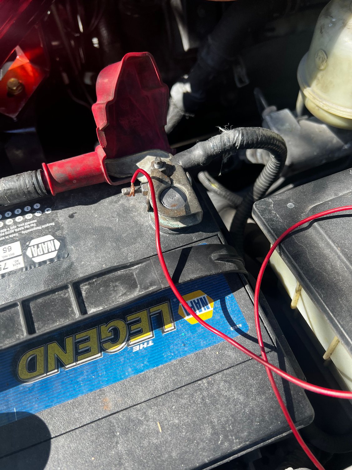

Not solved but know the issue.
Ok guys I checked for voltage at the harness and I have 12 volts then I ran a jumper wire to the harness with a quick splice. No amperage. Now what? Is it the fuse relay inside the fuse panel or???…
