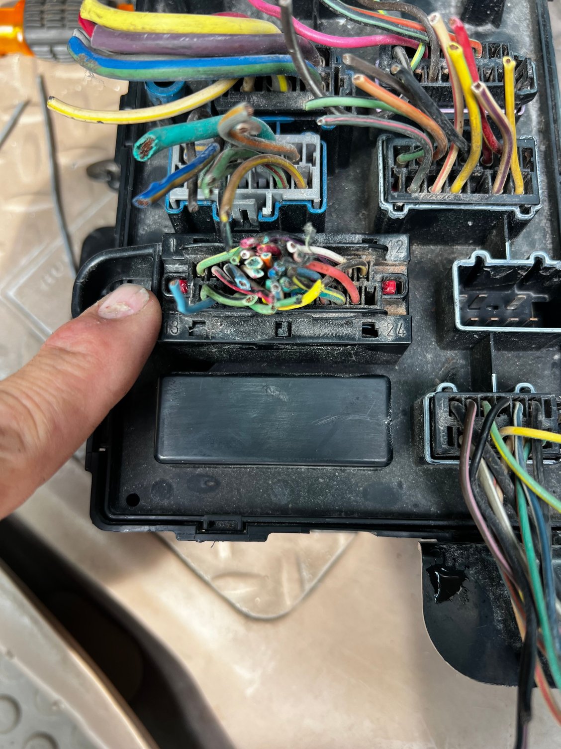

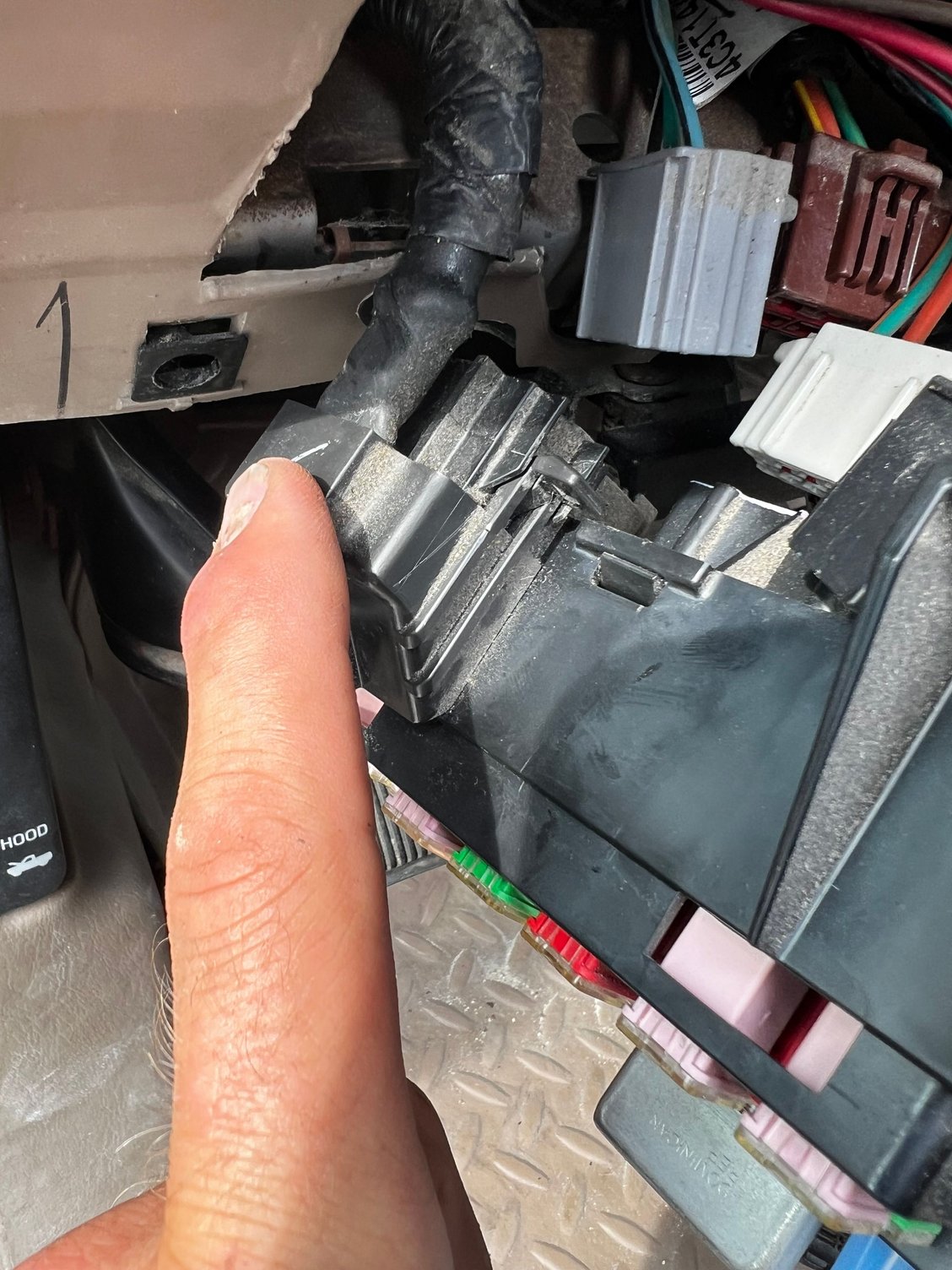

Alright gang the new fuse panel is here I’m in the process now of putting it in my truck. I can’t find anything online telling me how to get this done. Are there any videos or does anyone feel like being a nice guy and helping me? The problem I’ve run into now there’s a long plug that has two red deals on each end. I can’t get that out also notice something that looks to be welded on here it is a ground I believe. Sorry for sounding ignorant but I truly am when it comes to these things. Thanks for any help.

Some of those plugs can be a bear to get out. Make sure the tabs are in and sometimes a screwdriver can catch a lip and the connector turned out.
You are going to have to show the welded ground.

What I’m calling a welded ground is pictured first.

Top pic is the 12v feed there is a nut under the plastic. Plastic is clip and will come off
second pic pull that tab to the left, it's a slide lock type of connector thingy
THANKS MAN!
