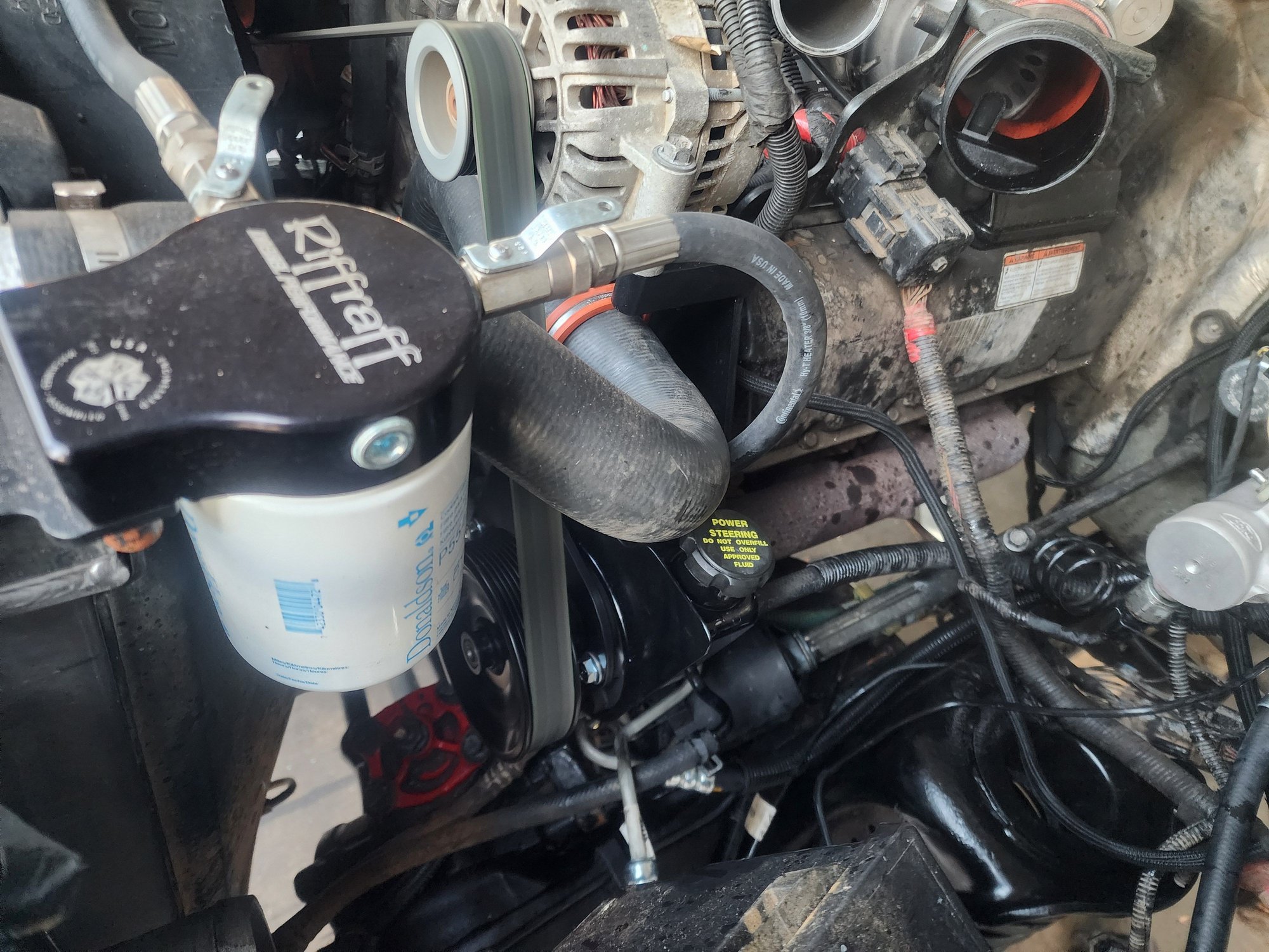

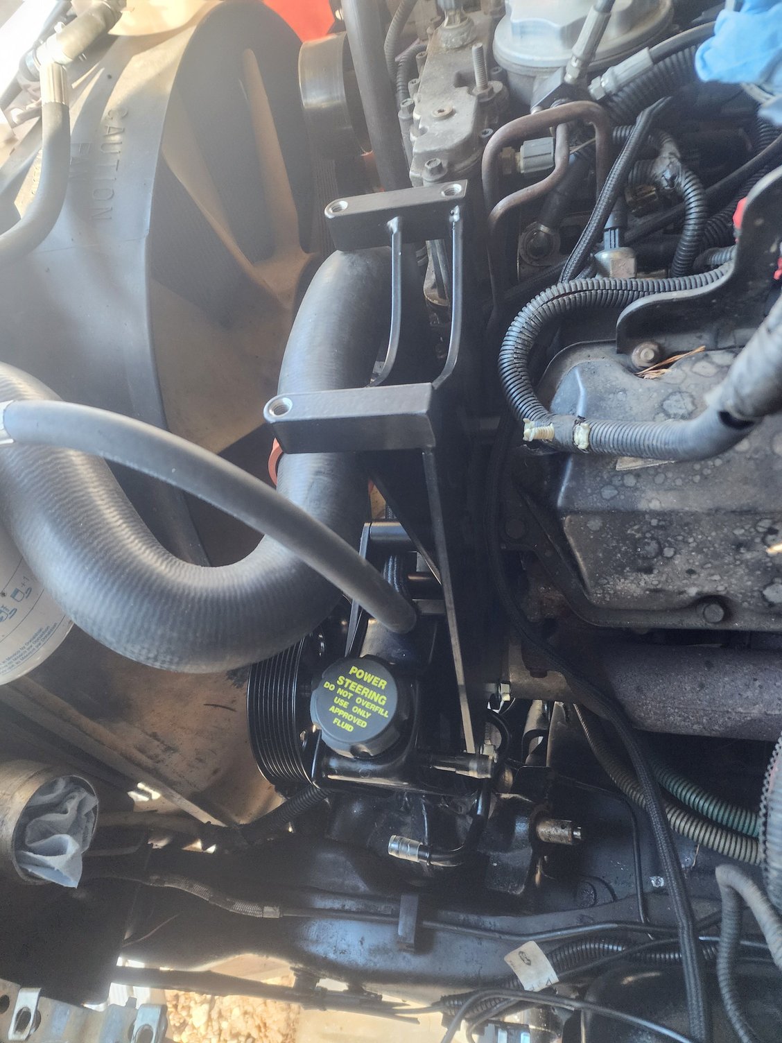

Have you seen the saginaw conversion kit made by a member on here? I have one on my 250 along with a 6.7 steering box and couldn't be happier. It's a all new alternator/ps bracket that uses a off the shelf duramax saginaw pump, a 6.7 ps pulley, and a off the shelf hose off something else that fits just fine. Super nice piece and works great.
https://powertrain-integration.com/p...ing-pump-mount
Here are a couple pics from my install.

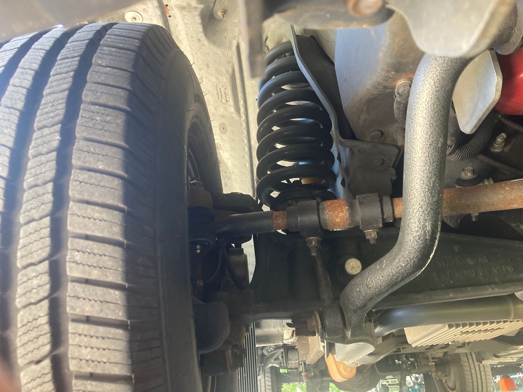

Post a pic of your front steering arrangement (I don't own anything 2wd to go look at). If there isn't an adjustment close to the pitman arm , then the adjustments would have to take place at the tie rod ends (which would affect the toe).
Old Apr 11, 2024 | 08:51 PM
ASFC27FTFBQ's Avatar
ASFC27FTFBQ
Joined: Sep 2019
Posts: 892
Likes: 160
From: Gainesville

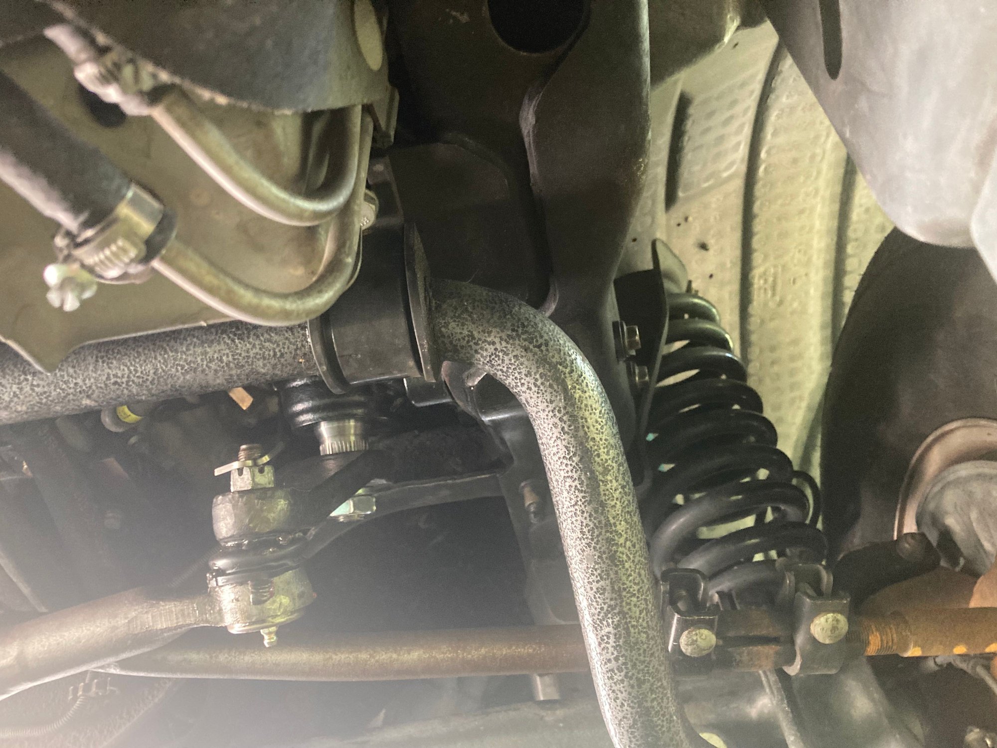

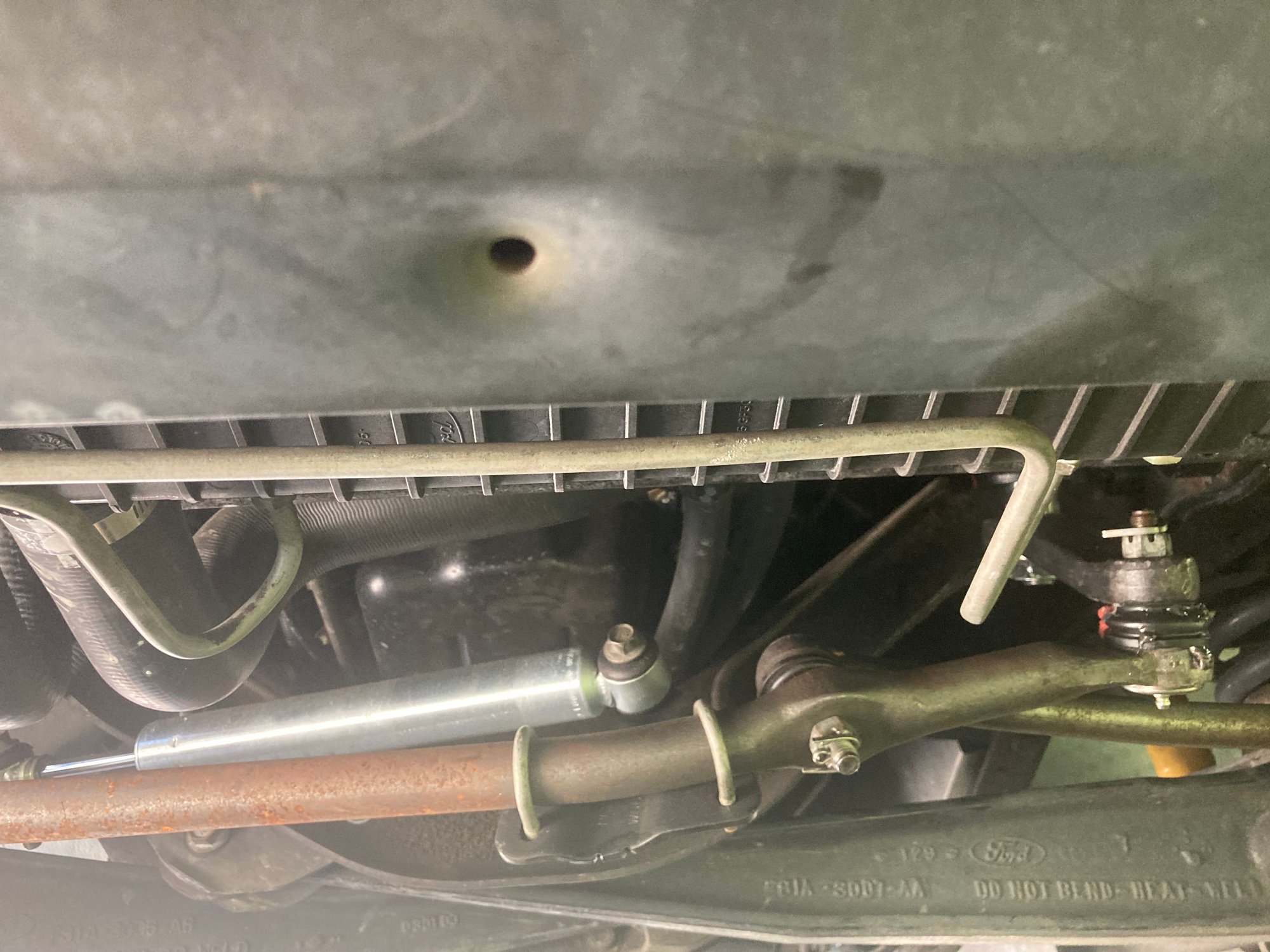

Here are the photos from underneath.
Old Apr 11, 2024 | 09:44 PM
Antonm23's Avatar
Antonm23
Joined: Mar 2023
Posts: 1,598
Likes: 939
I didn’t know the 2wd Excursions used a front twin I-beam setup, about as old school as the front leaf spring found in the 4x4 models I suppose.
To re-center your steering wheel the tie rods will need to be adjusted, which does affect toe, so you need an alignment shop.

The 4x4's have it easier for centering the steering wheel, they have an adjustment point on the drag link close to where the pitman arm attaches that serves no other purpose besides centering the steering wheel. See the red circled area in the image below.
The good news for your twin I-Beam setup is you can adjust the tie rods and set toe in your driveway pretty effectively with a tape measure and a couple pieces of straight steel/ aluminum/ lumber/ whatever. Just set whatever straight things you have against the tires such that they stick out in front of and behind the tires equally on both sides, then measure the distances in front of the tires and back of the tires, you want these two measurements close to equal with a slight amount of toe in (closer in the front than the back). You want a little toe-in , any amount of toe-out will make for a wandering feeling in the steering.
