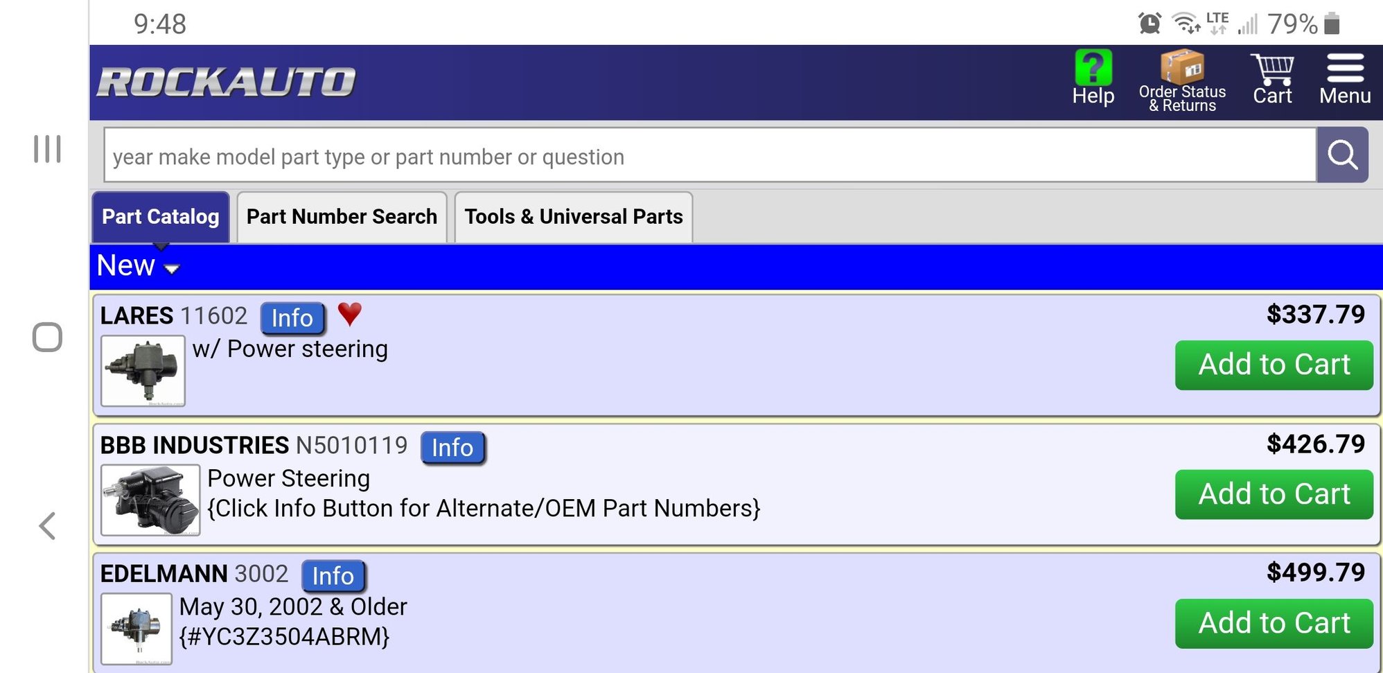

So I think I need a new steering gear box... My question to you all is should I go with a quality reman like the Red Head or go with a new one (not remanufactured)? The new ones are about $500 versus the Red Head which is about $350ish... I found the new ones on Rock Auto but I dont know anything about the manufacturers.

anyone heard of this brand? https://www.buyautoparts.com/buynow/...ox/82-00425_an

I would bet that all 3 of these come out of the same plant in China...
