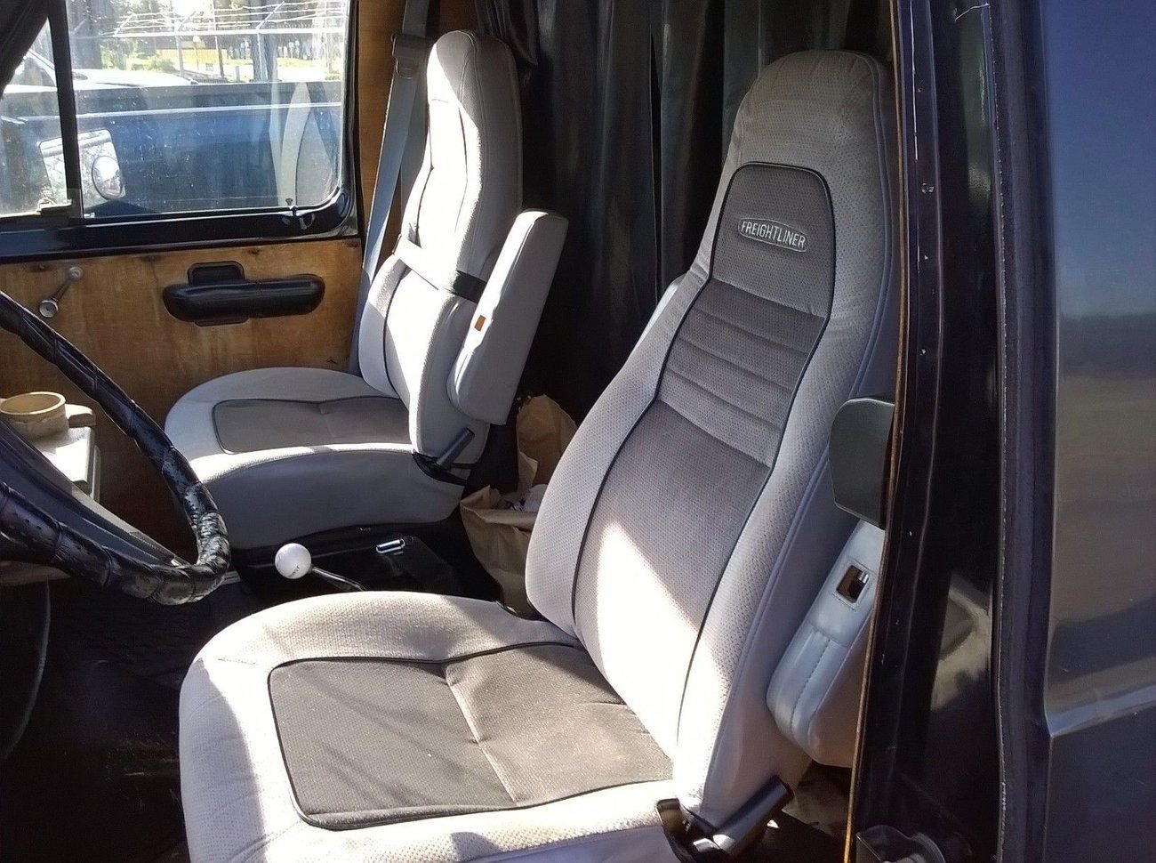

I certainly like your build thread, I had the same year (1981) but mine was a black panel.
The seats I found on Ebay were part of a "tear out" from a then brand new Freightliner truck. I used two panels of flat steel for an adapter plate and that was that, those Freightliner seats were great for long distances, never got saddle sore.
