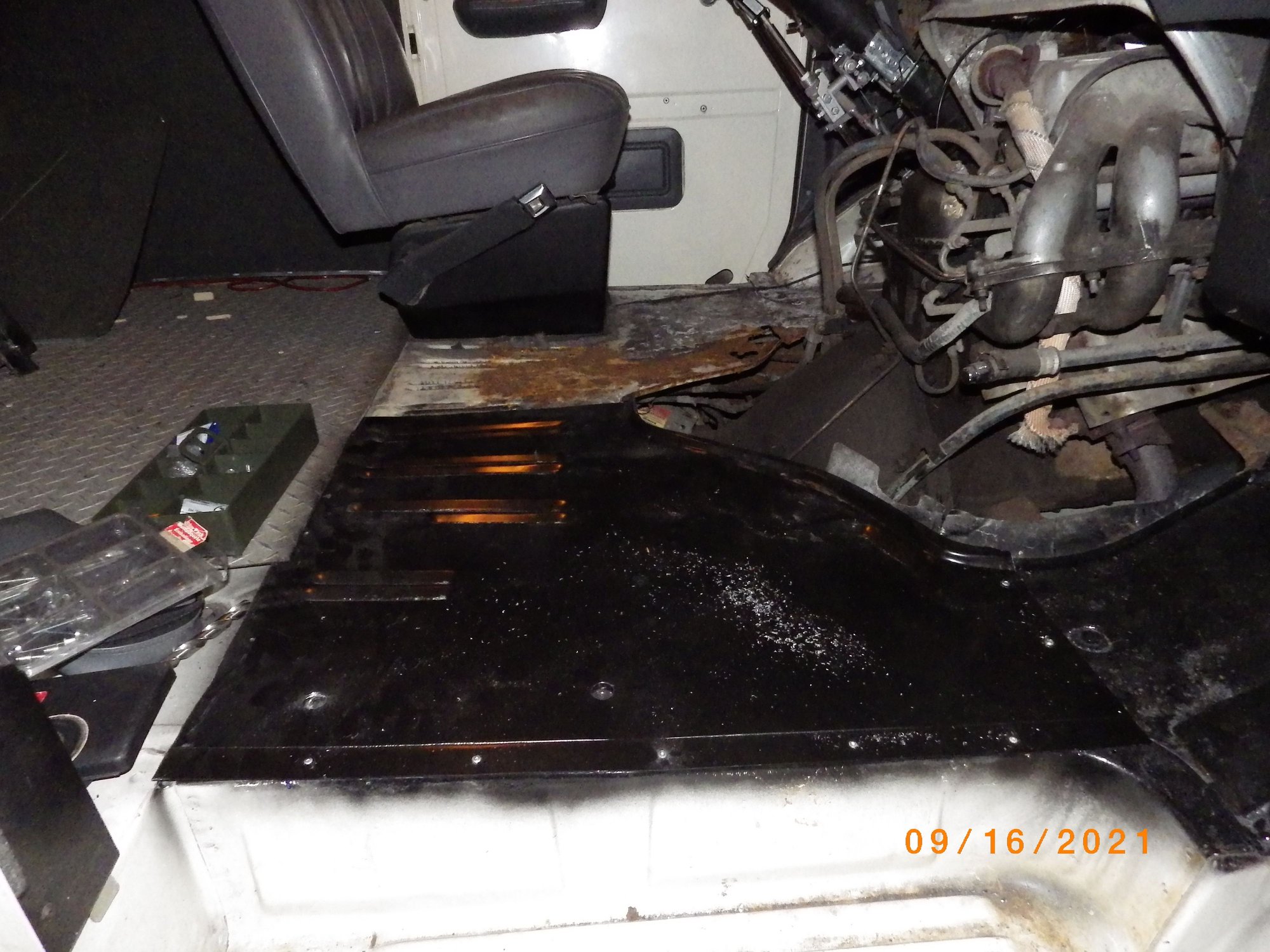

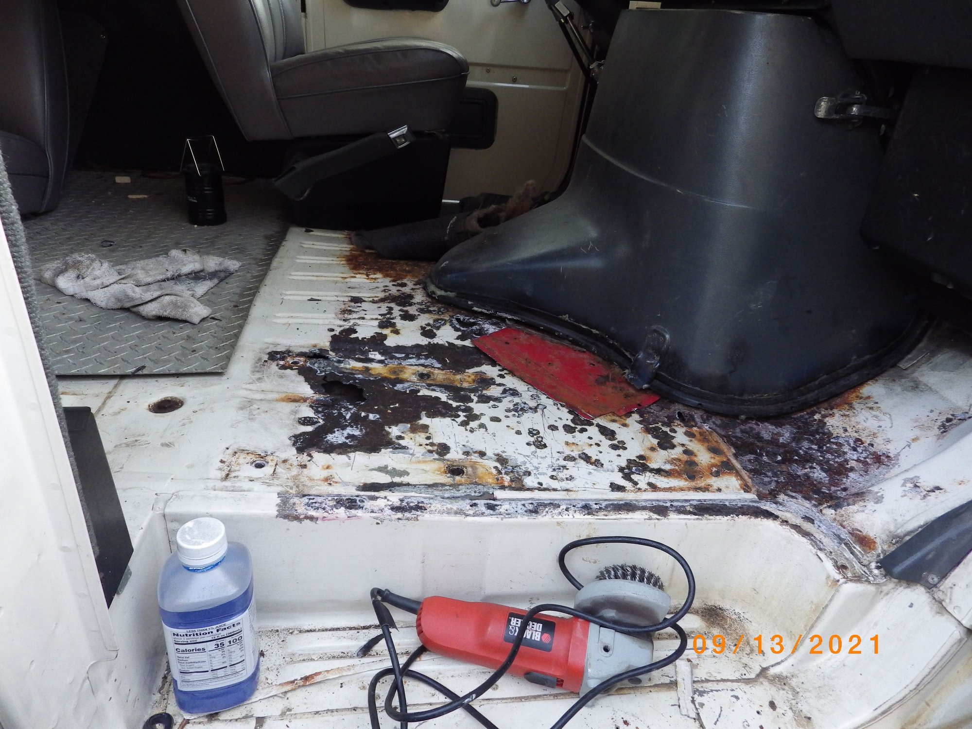

I have an enormous aluminum radiator, my mechanic wasn't going to put one of those garbage plastic tank ones in, as thats all shops were selling, I don't know what it went to, likely a V8 as he had to get creative on the lower hose connection, inline has it on the other side, wasn't able to put the shroud back on, and I've looked into it to see how to arrange it to go in, I just about hate this van by now and just plan to drive it till its dead, too much in it to ever get back out, which is why I'll suggest no one buy a fuel injected 4.9 OBD1, they are a pile of excrement, I should have put a carburetor on it, at this point I could have put in a 351W stroker and came out cheaper.
I added that sheet of aluminum in the middle so my wheelchair doesn't catch on the ribs in the floor as I try to move around, that floor was solid, carpet up front aided in the rust, along with the idiot who felt 30 self tapping screws in the windshield trim would stop the leak, cracked windshield was removed, and all those screw holes had to be welded up, some people should be banned from using tools!
I did not cut out my floor, no welder, trying to budget fix what soon became a money pit, I ground out all the rust, coated it, trimmed for the reproduction floor to fit, and form where the doghouse rests, then riveted the sheets in, one has automotive adhesive too, ordered a reproduction floor mat, front only then drilled and bolted the seats in, lining the passenger up to go back in the factory threaded holes, drivers seat is a power slide track for wheelchair transfer.

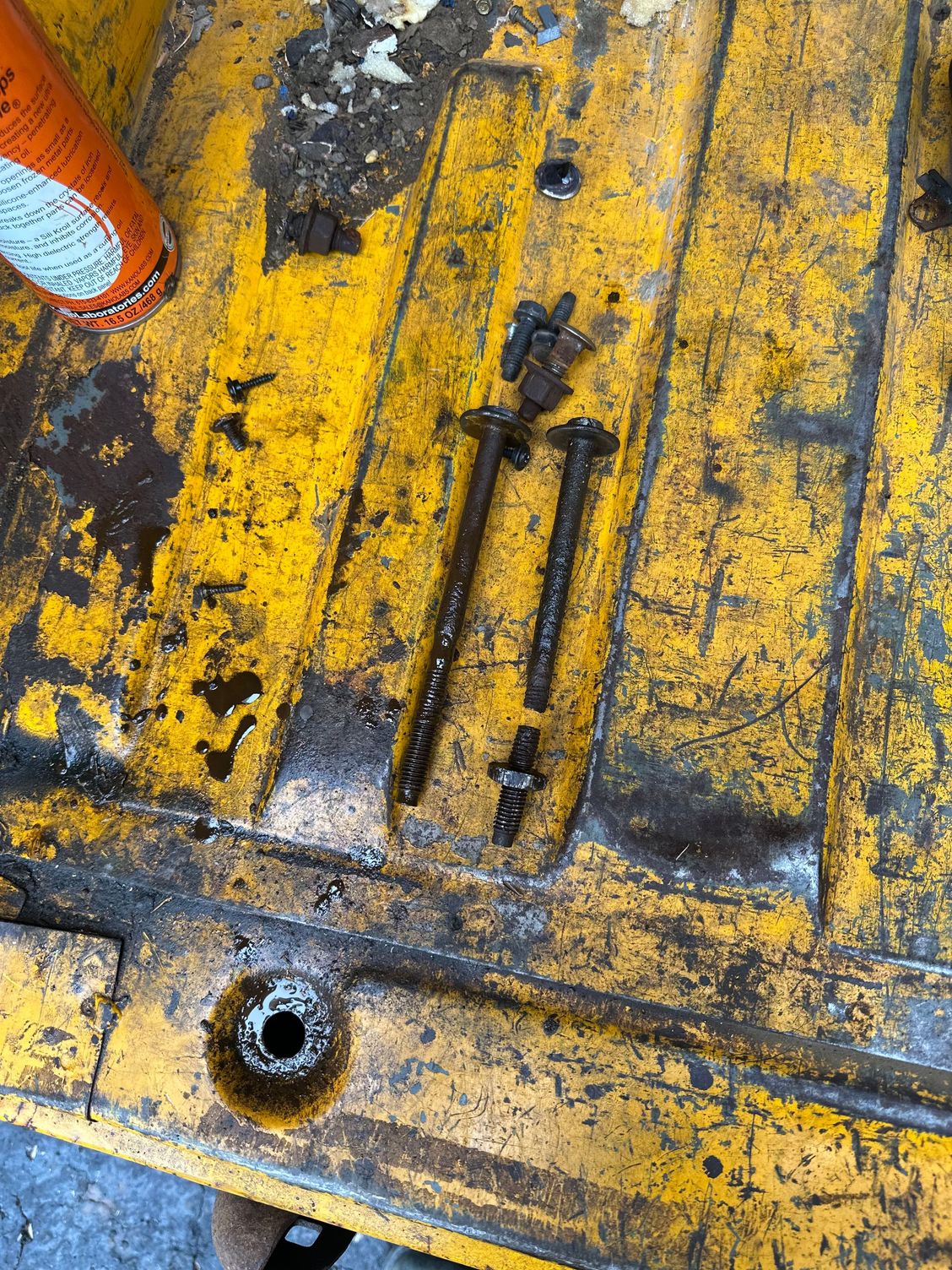

The bolt from hell. It snapped off (top) and from the bottom I was cutting the nut with my cut off tool (3", dewalt battery powered). Turns out it heated the bolt so well that the rest of the bolt was able to be unscrewed from the bottom. That was lucky... otherwise I was going to have to drill it out, and that hole is long!
