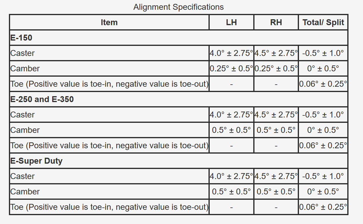

I have a 2008 E-150 that is difficult to keep in its lane. I have been following the thread A Real Econonline Steering Fix and I'm not sure that my issue has the same symptoms as is referenced in that thread. See end of this post for a description of my van's symptoms.
-- Three different shops say the steering components are tight. (There doesn't seem to be "play in the wheel." While driving and quickly shimmying the steering wheel left and right, the front wheels respond as expected.)
-- Tires have been checked by a respected tire shop.
-- I just had new rear springs installed and alignment done. That made the issue slightly better.
To determine my next step, here are my two primary questions:
1. With the caster at +4.5 and +3.1, should I have the 3.1 (right side) increased to somewhere around 5.0?
2. Would there be any negatives to installing a steering stabilizer at this point in the problem solving process or should I wait?
Description of symptoms:
The issue is subtle and I think that's why at least four different techs who drove it did not find that there was any problem that needed to be addressed.
I experience the issue at any speed but it is more noticeable at higher speeds. It's as if there's play in the front end. Yet as noted above, the front end seems to respond as expected when shimmying the wheel quickly left and right.
Example 1: The vehicle can drive straight for relatively long periods of time. But it will seemingly at random decide it's going to drift to the right (or left) without any input from me. It feels as if I've encountered a strong crosswind or a significant crown of the road when little or no wind or crown is present.
Example 2: Picture driving at any speed and moving into a left turn lane. What a driver would normally do to execute such a move is steer left a certain amount and then steer right a certain amount to properly position the vehicle in the lane. For anyone who's been driving more than a week, this is instinctive.
For the same maneuver in my E-150, when I steer left the van responds as expected. When I steer to the right, it does not respond enough. I have to steer to the right more than one normally would.

Just when I thought we were finished with these threads about E-Series vans "wandering" we have yet another! If the existing threads aren't enough to convince people they're generally ill handling vehicles, never meant to be anything more. Having owned 4 of my own and driven 3 others sadly this isn't a problem that is fixable. Those chassis are just huge compromises in design which creates the handling issues we all experience.
Have the caster angles corrected closer to +5 degrees with acceptable cross-camber variations, make sure the tires installed are specified for your chassis and probably too often over looked what's the weight as driven most often?
While some variations in road surfaces might not be immediately seen visually they can exist and in turn affect a poor handling vehicle's behavior.
Personally I didn't experience any significant difference with the front steering stablizer installed but did notice a large improvement installing a rear anti-sway bar, any brand but Addco. It is possible the steering box is worn but before replacing it raise the front tires off the ground, have someone wiggle the steering wheel while you observe whether there is any slop before the tie rods and drag link are moved.
Since you've had at least 4 technicians not find cause for concern that should be sufficient to say your van is acting as it should.
What type of shop is capable of this adjustment? I could take it back to the place that did the rear springs (they're a well respected heavy truck suspension shop that most other shops in the area refer to) but they're not very near me.
Similar question for this - should any decent shop be able to do this diagnosis (and replacement if needed) correctly?
If convenience is your priority then keep shopping around for a closer shop asking if they're capable and/or willing to do as you request caster-wise.
If its a truly competent shop more geared towards repair/correction than just replacing parts then yes it should be a fairly straight forward process. The best initial inspection should be done by YOU in order to see what's happening--otherwise you're trusting someone who might not have your best interests in mind.
Brand-wise on steering box replacement I've gone from a Ford reman'd box that unexpectedly and catastrophically failed just 85K miles later---was replaced by the junk brand "CarDone" that lasted until the van was sold at 291K miles about two years later.
Red Head boxes were once upon a time thought to be among the best but I'm not sure that's still the case----Google search the 'net for recent reviews. Concentrate on what failures were experience and how Red Head dealt with the situation. This would be a part you'd supply to the installing shop for their installation. The onus for any warranty replacement due a failed box would fall on you. I really don't have any specific brand recommendations for reman'd E-Series steering boxes, there are probably no brand new parts available nearly 10 years after end of life for the full bodied series.

Did you get an actual full alignment or did you pay one of those back yard shops that just adjusts the toe and hands you a bill for a complete alignment? ( never mind, the readings you posted for caster already answered that question). I ask because thats been my experience with nearly every single shop that has ever claimed to have done an alignment on my E350.
They adjust the toe and then hand you a print out of what everything is currently reading even though they made no attempt to set the caster or camber to the correct values. Its because they dont want to spend time pulling the camber/caster bushings and doing the math and then running to the parts store to track down the correct bushings.
Clearly your caster is incorrect by a large margin and likely everything else in terms of proper alignment. The ford specs call for the right side to have slightly more caster than the drivers side and here you are with nearly a full 1.5 degrees less caster on the passenger side than you have on the drivers side. You have exceeded the maximum allowable cross caster. Why would you expect your truck to do anything other than what its currently doing? Find a shop that knows how to do a correct full front end alignment and then go from there. Tail wag is also a real thing and is common in the RV world and can also be an issue with regular vans in crosswinds. Its actually the rear of the truck shifting but mimicks a steering/alignment issue even though it isnt. Like i said, find a shop that actually knows what they are doing and get a proper alignment before you waste a bunch of money.
The proper way to do an alignment contrary to popular belief is not to leave one side at say 6.75 degrees while the opposite side is at the other extreme end of the spectrum at 1.75 degrees and then claim the readings are within spec because they are not. You have to attempt to get the readings within the specified range while not exceeding .5 degrees of difference side to side. There is also a reason that your passenger side is supposed to have more caster than your drivers side.
Claiming that these trucks all handle like crap and you just have to live with it is a logical falisy. If they handled like yours off the showroom floor Ford would never have been able to sell them. There are 100 half *** alignment shops out there for every 1 shop that actually knows how to do a correct alignment.
Have you recently replaced any front end components such as balljoints?
