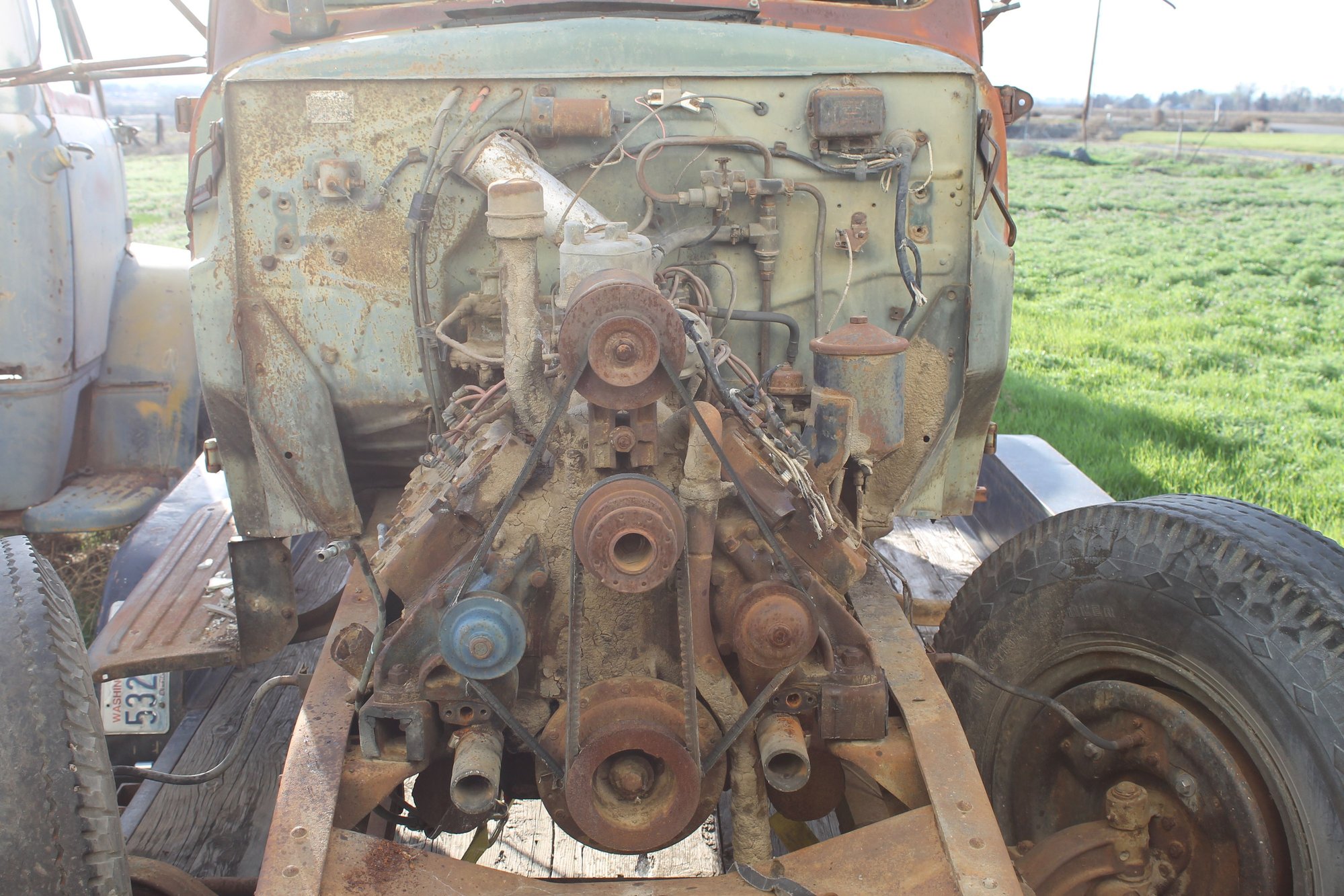

Here is are pics of 1) the 337 motor mount, still in a car about 8 hours away from me; 2) motor mount of the current '36 flathead in the 1.5 Ton; and 3) the Big Dog itself.

Here's a couple engine pics I grabbed when I was parting out the F8. I don't know if these will help at all, but here they are. The engine is sitting on a roller cart now. If you'd like more pics or measurements or anything, just let me know. I'll do what I can.
