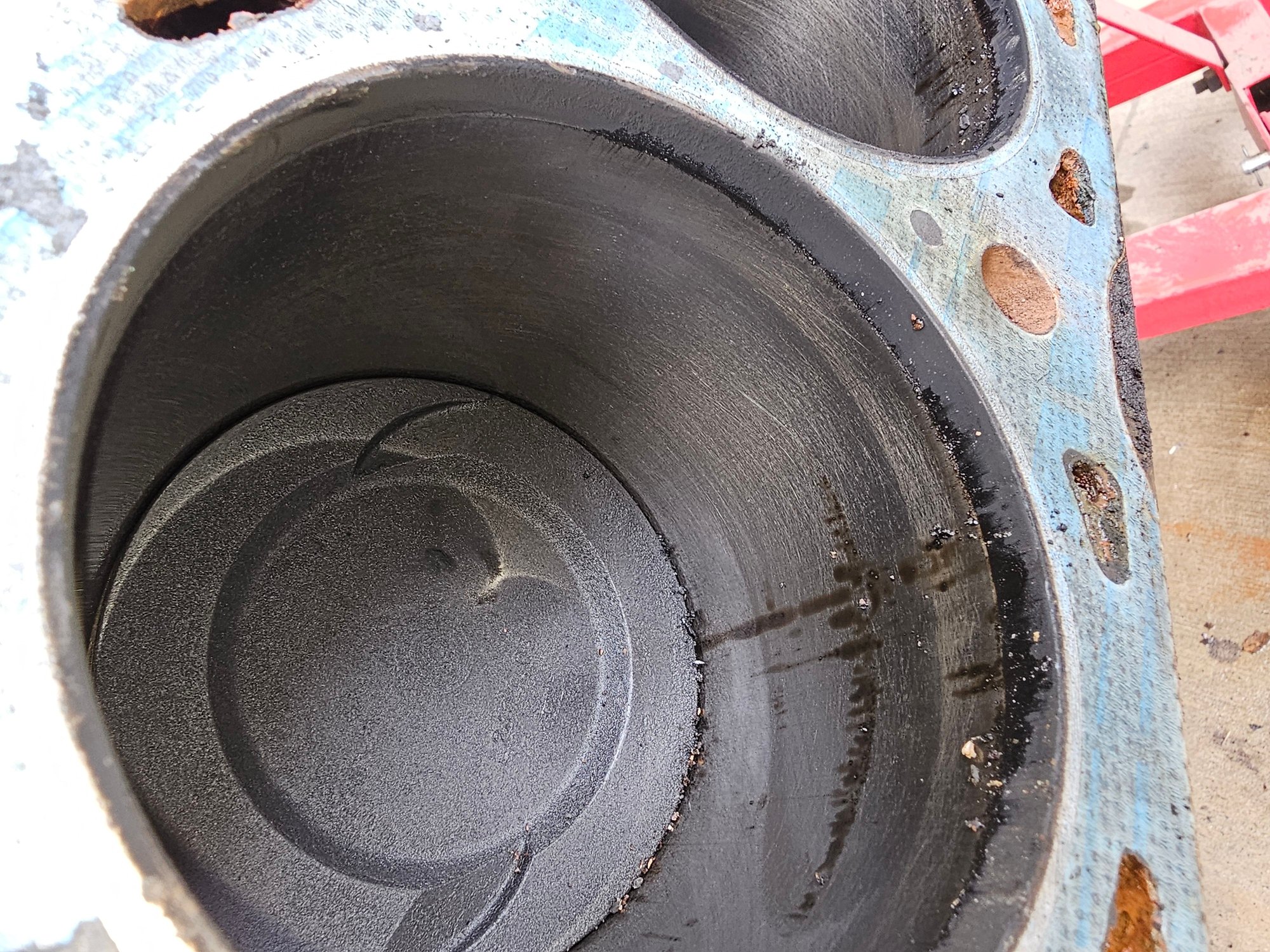

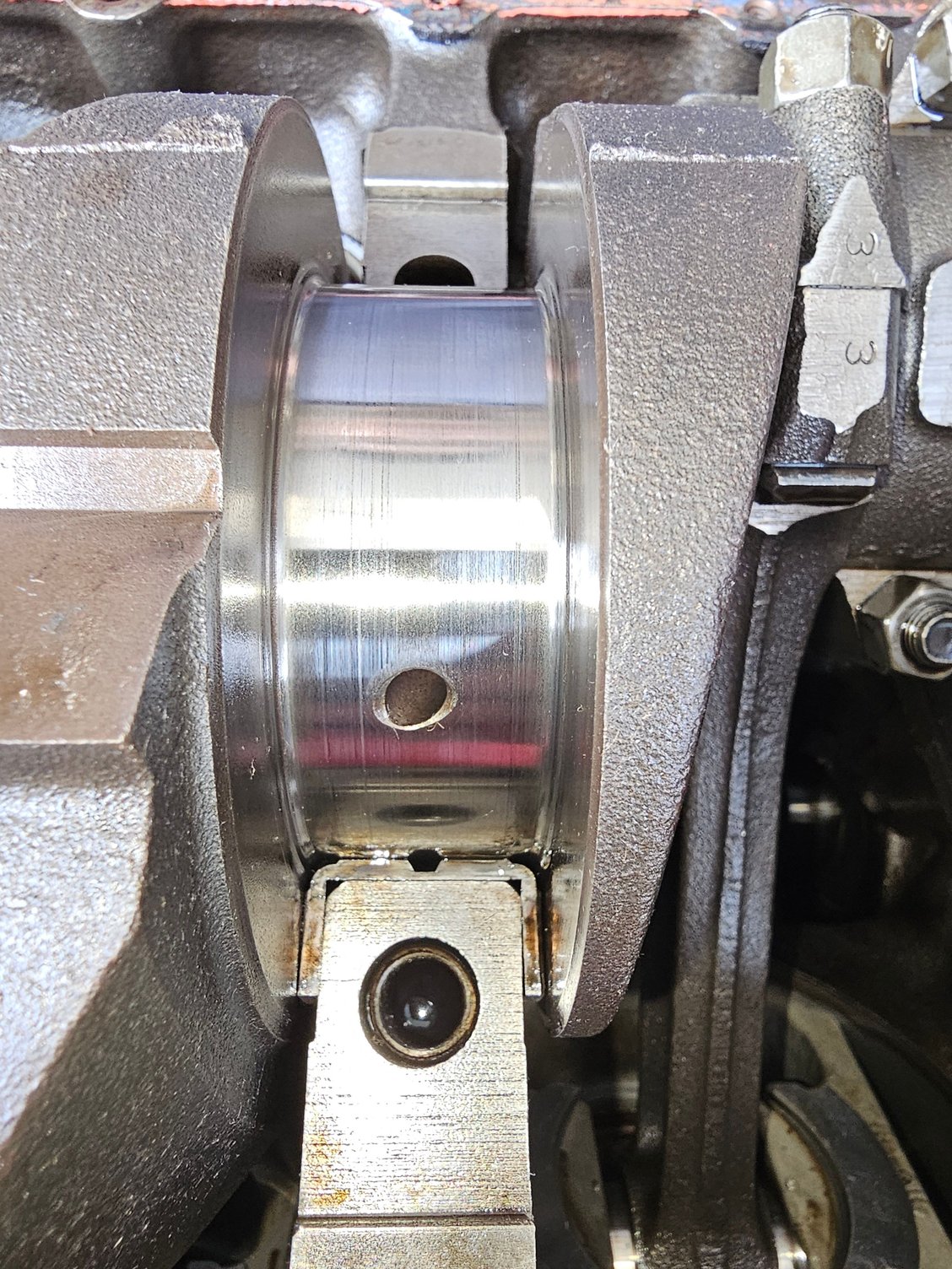

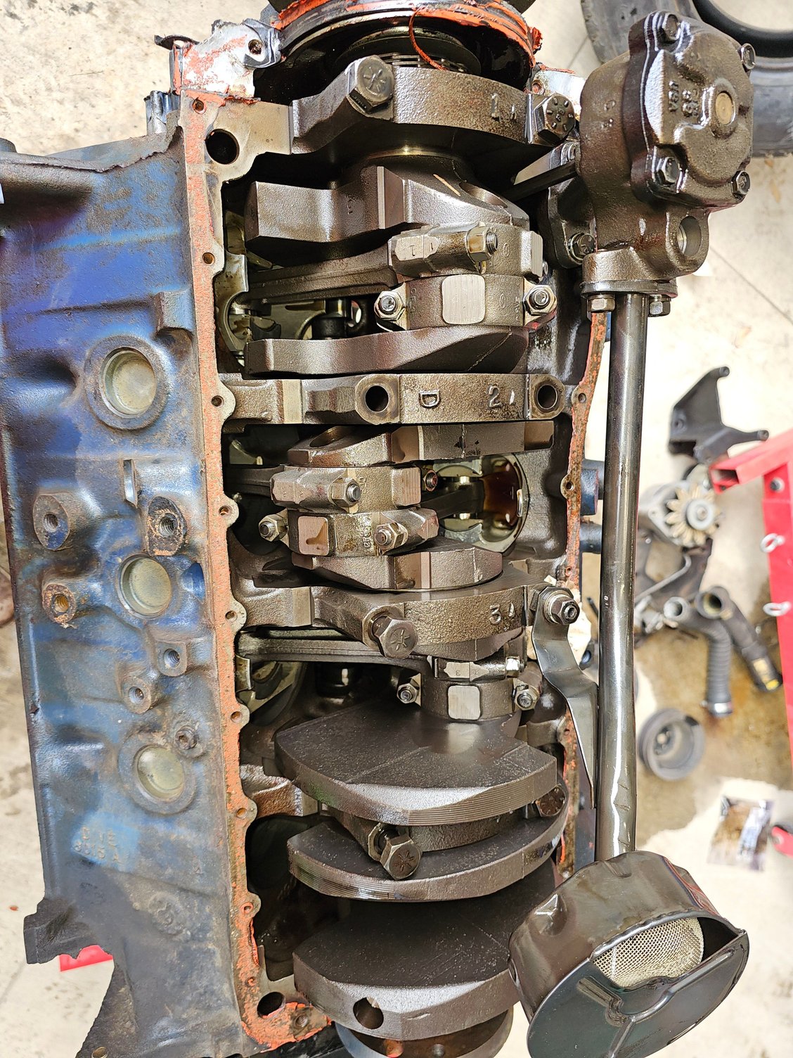

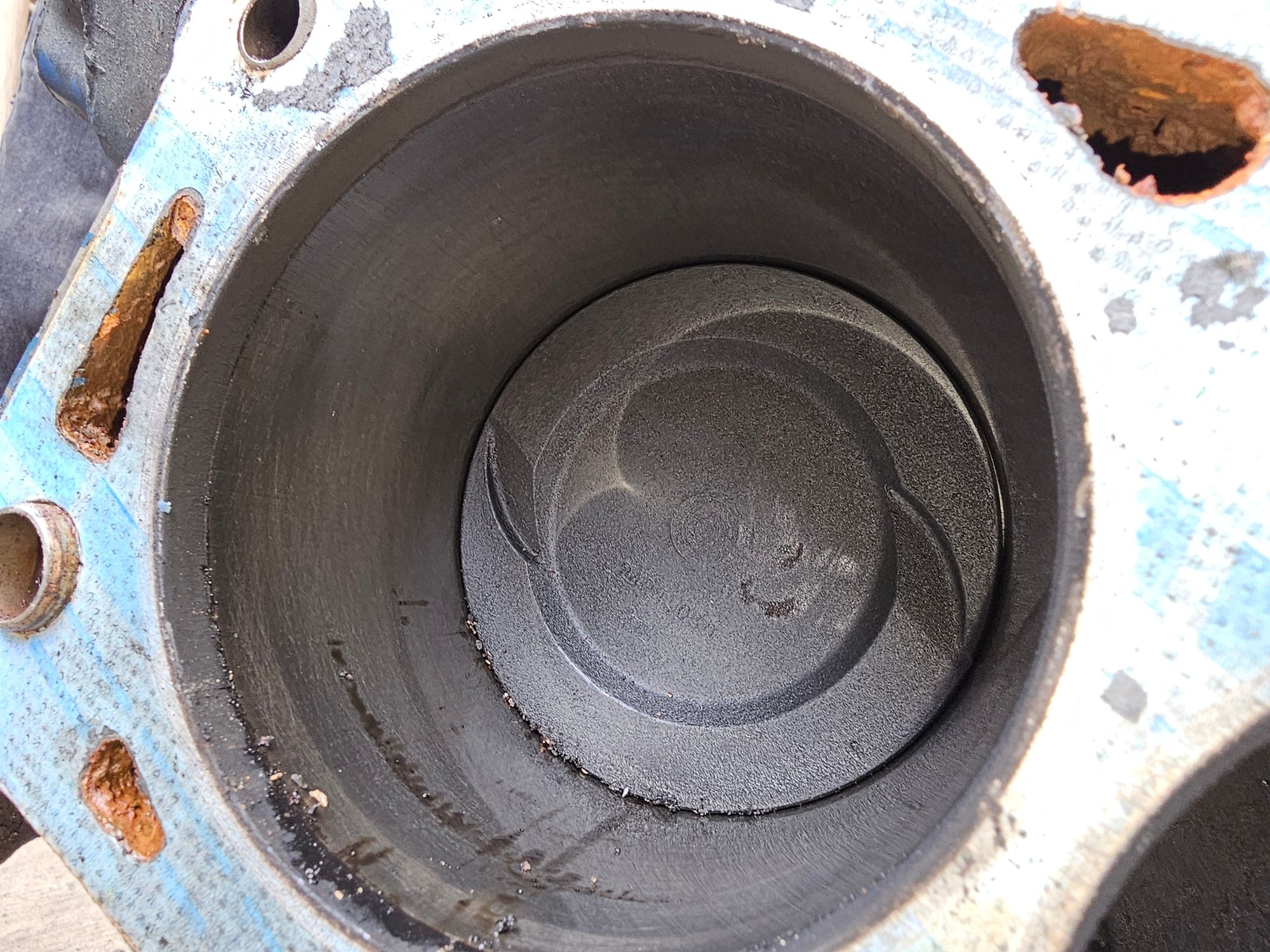

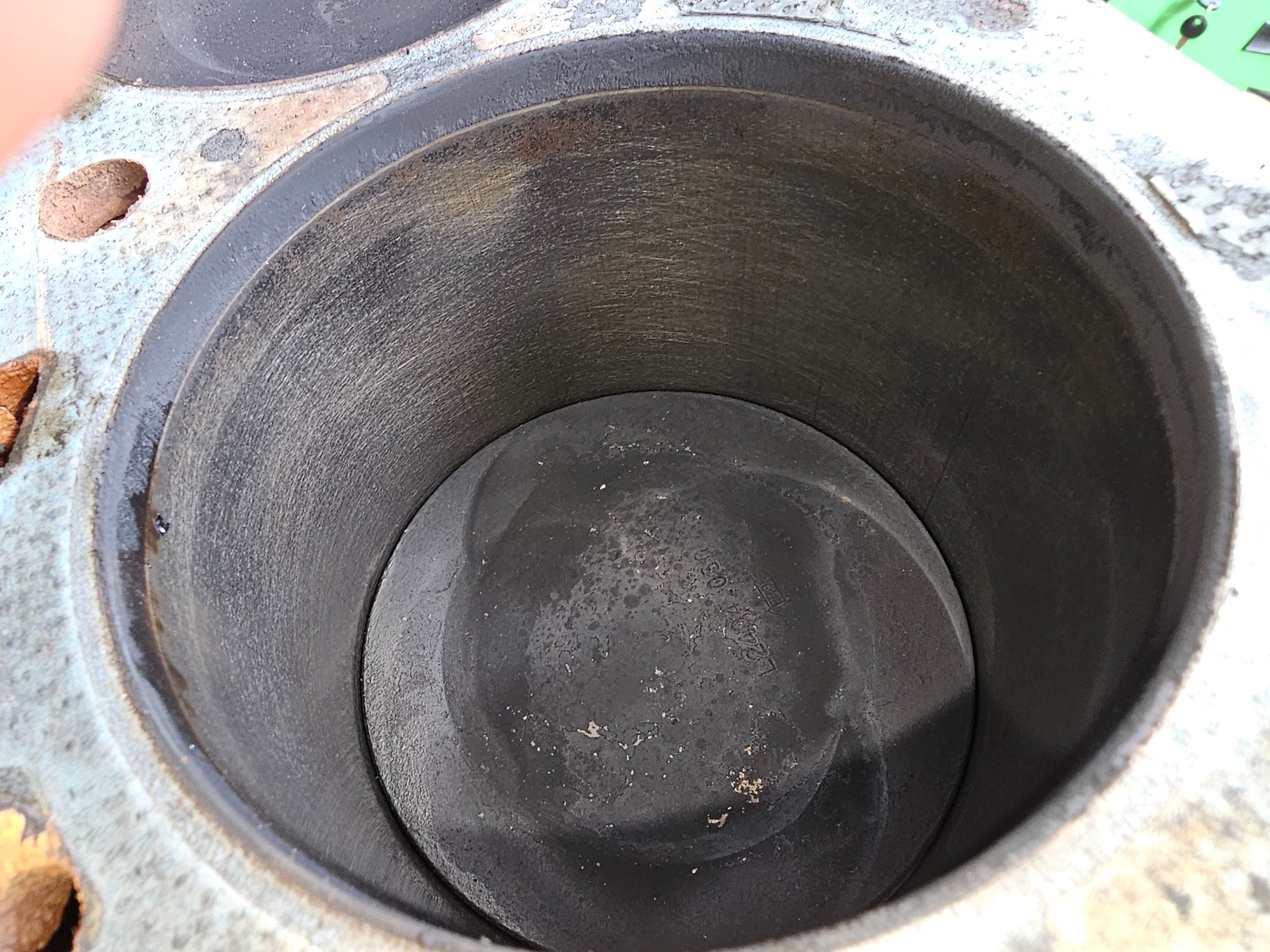

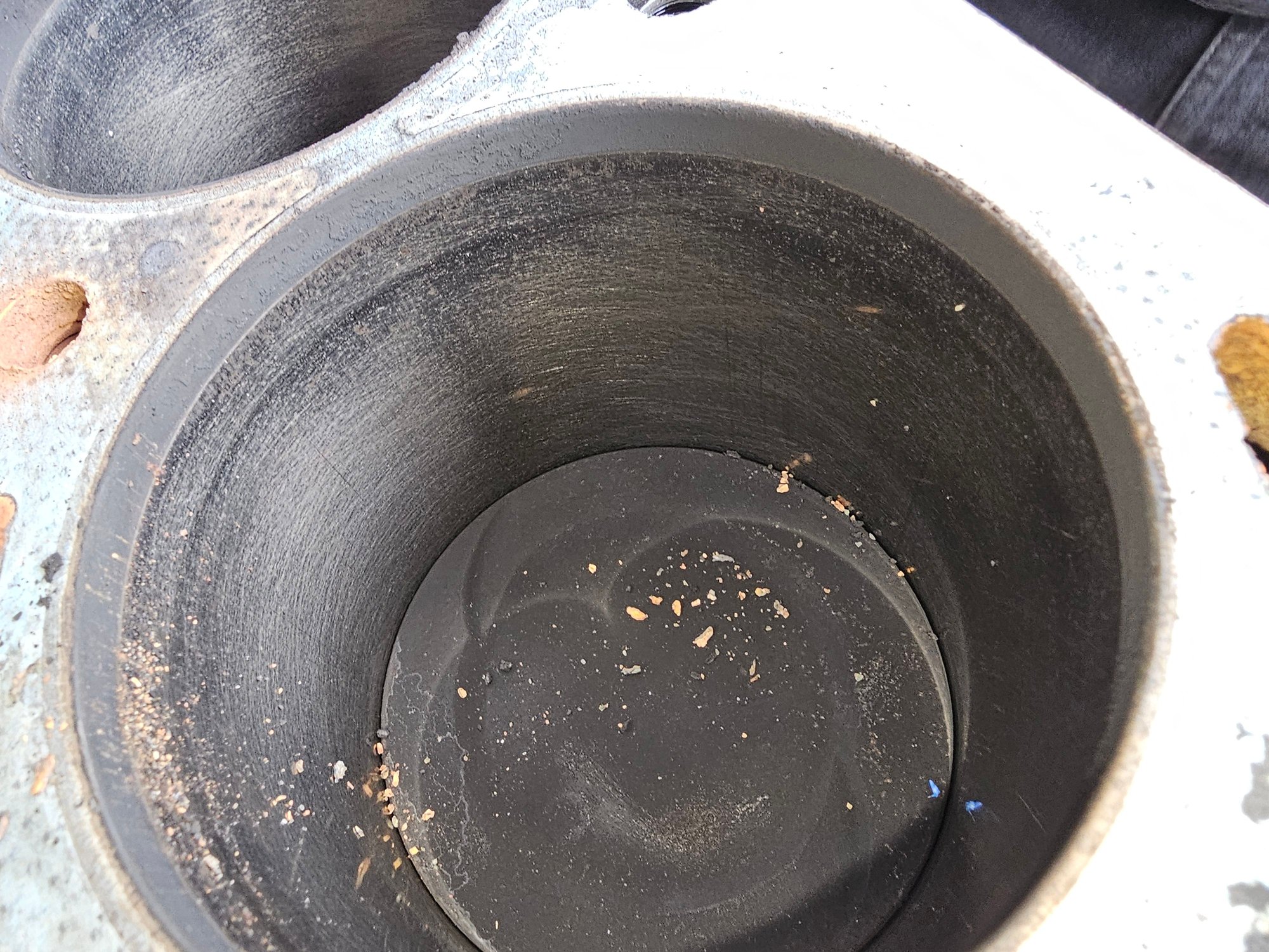

Okay, about to bombard you with pictures. Sorry in advance LOL

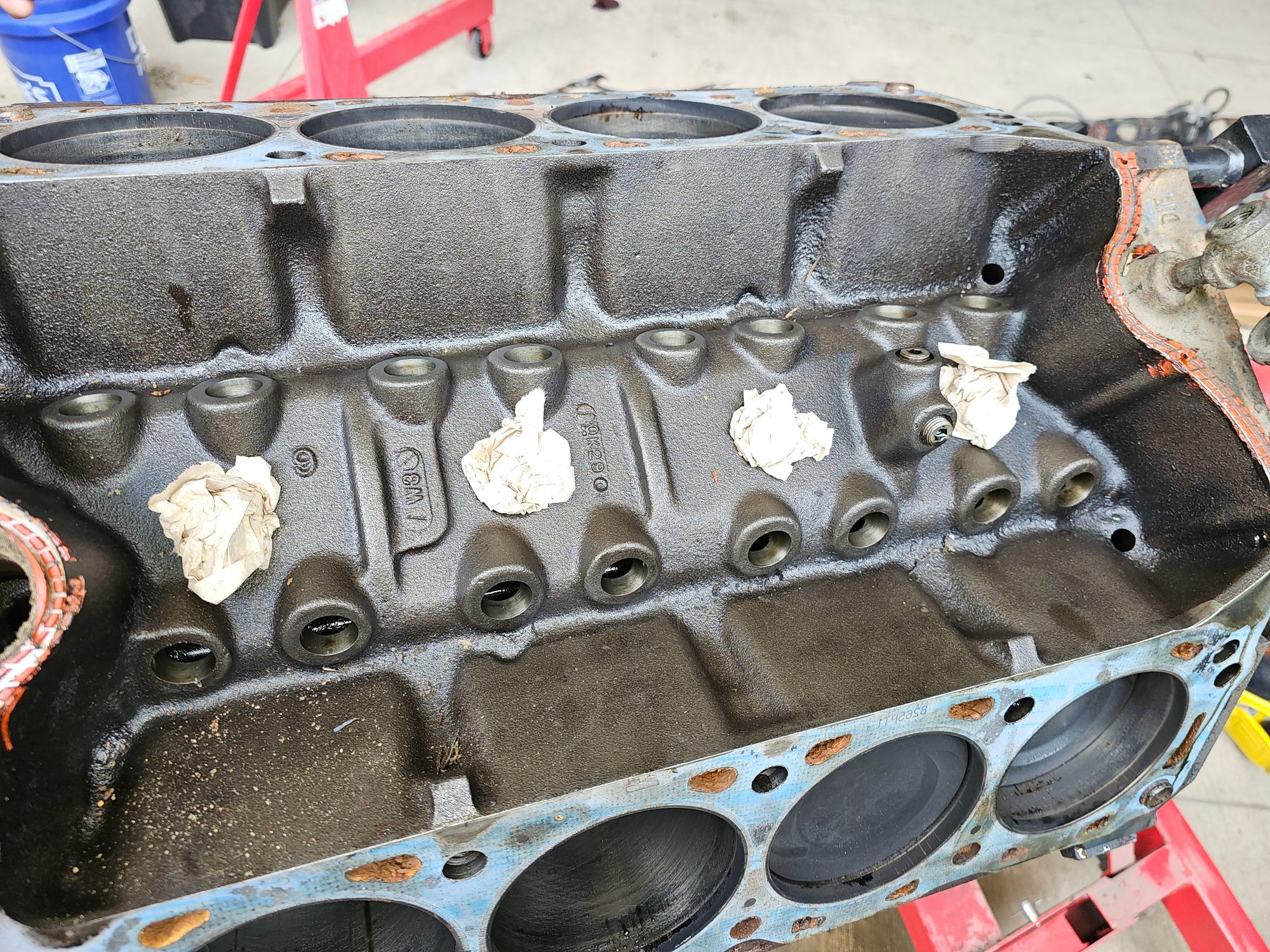

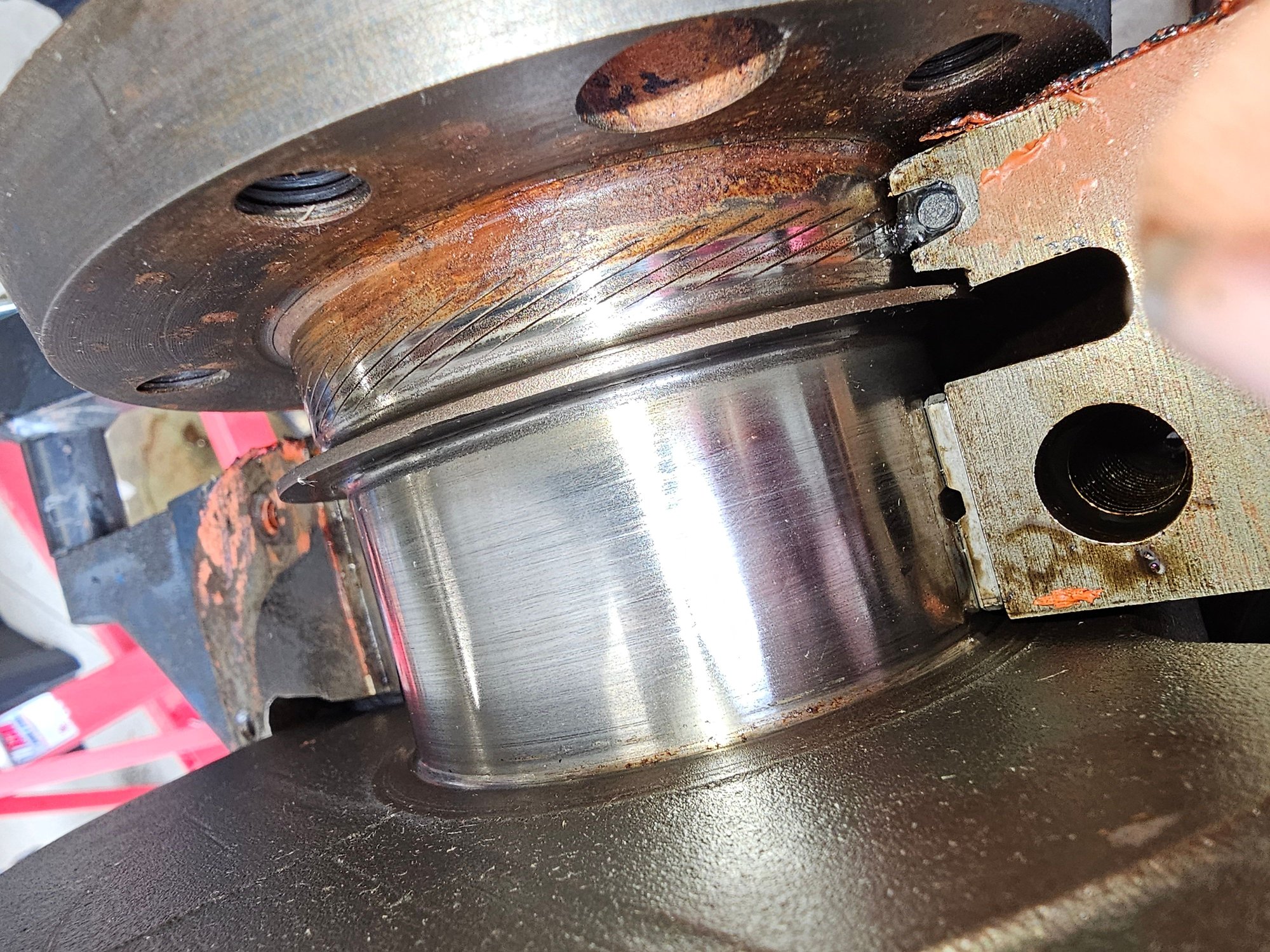

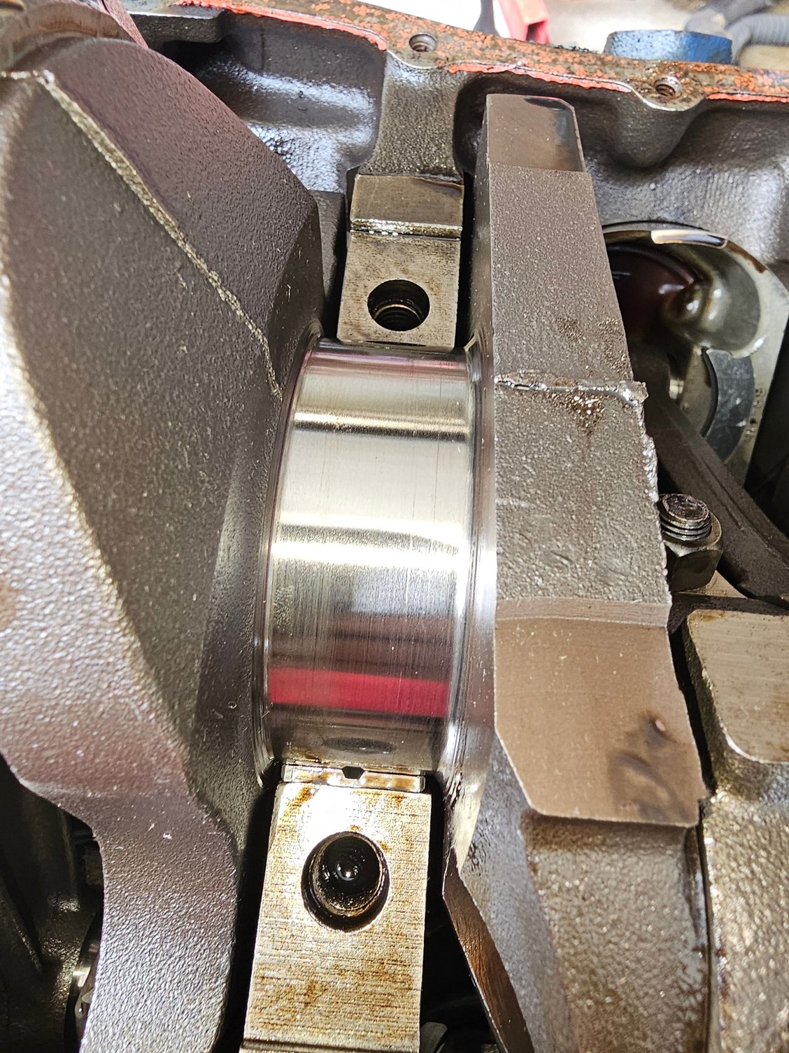

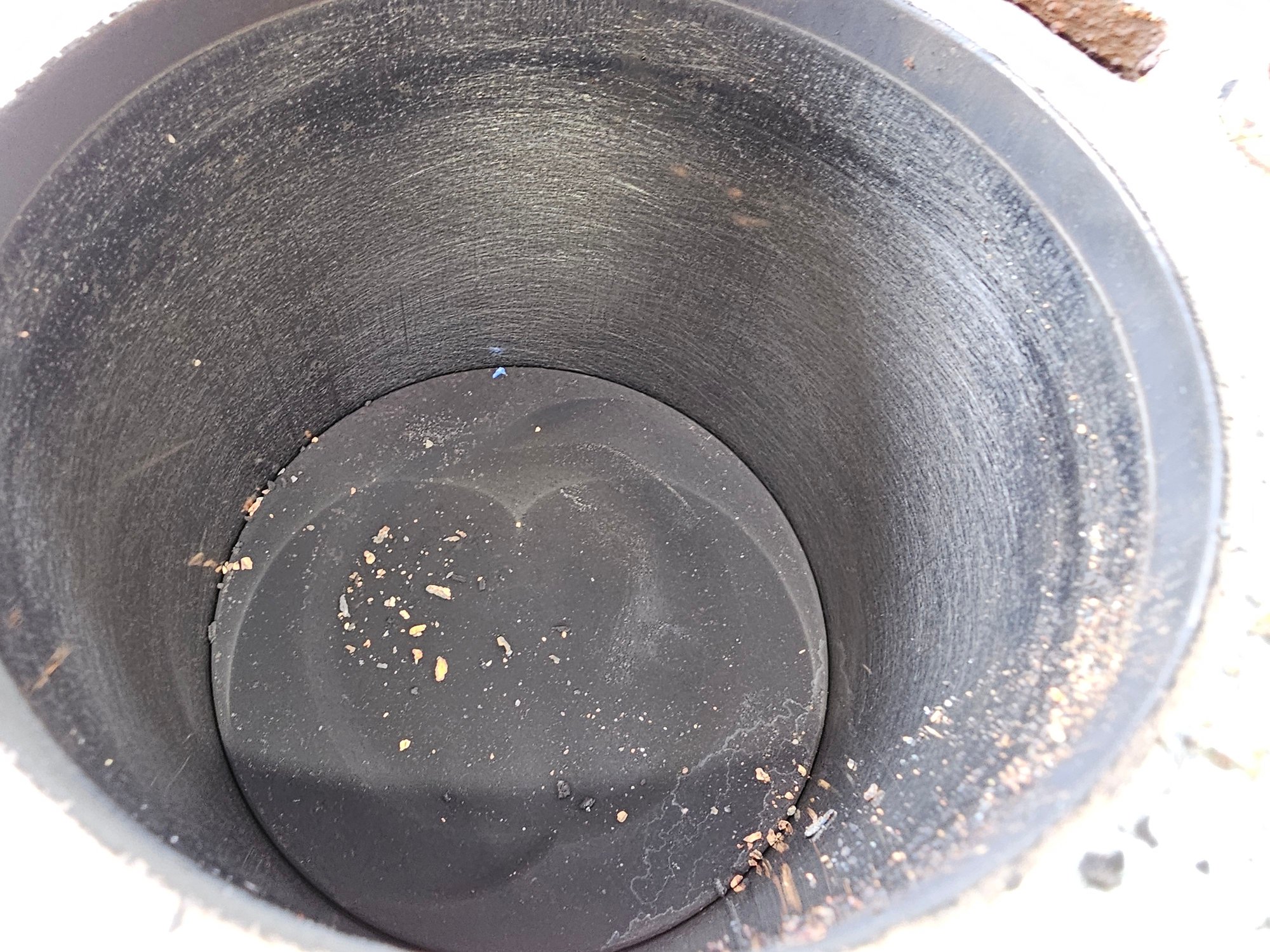

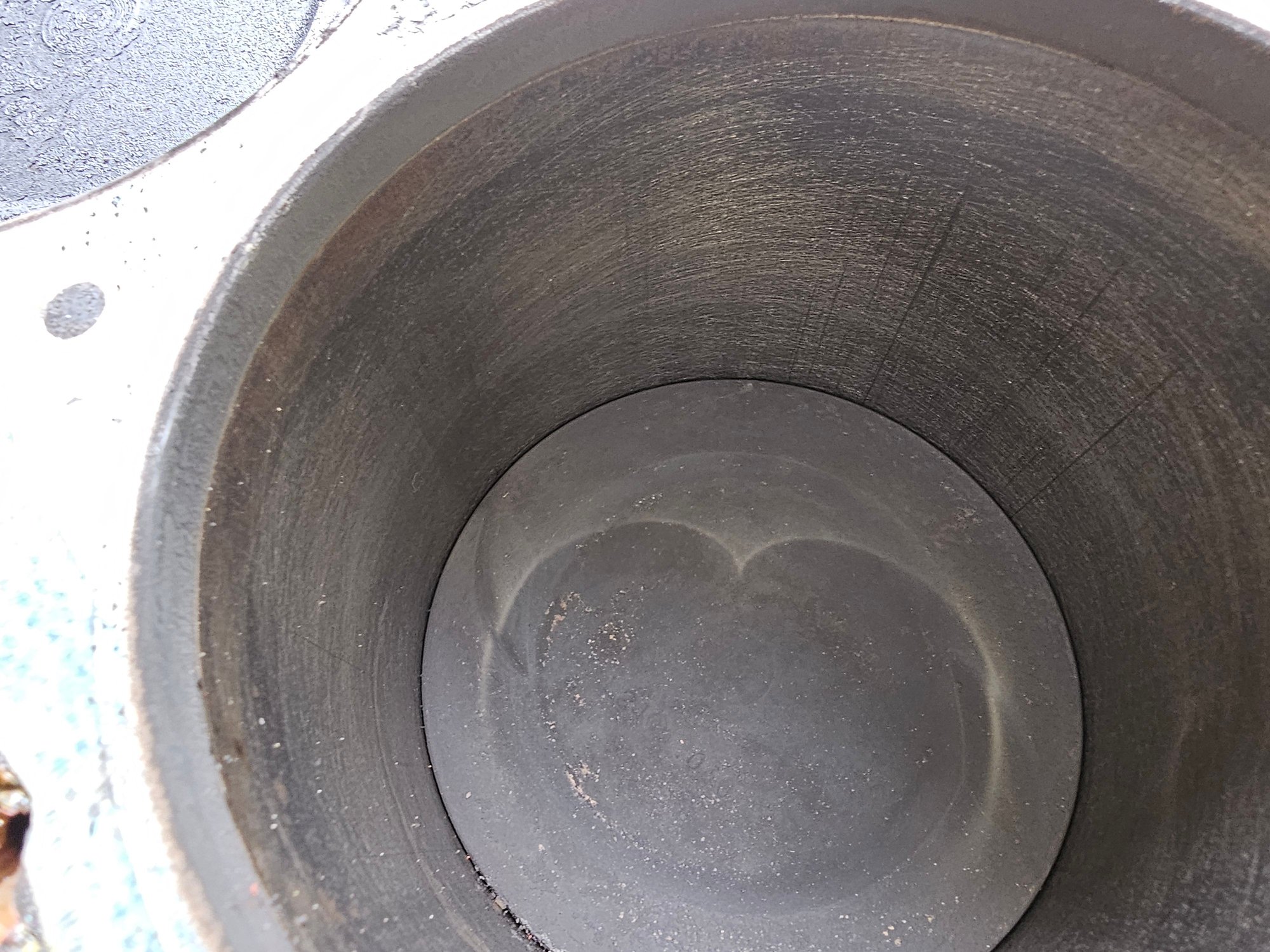

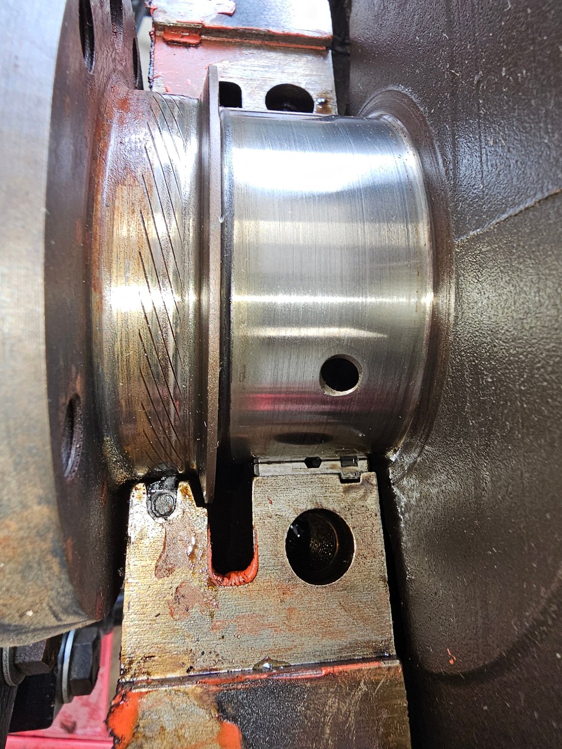

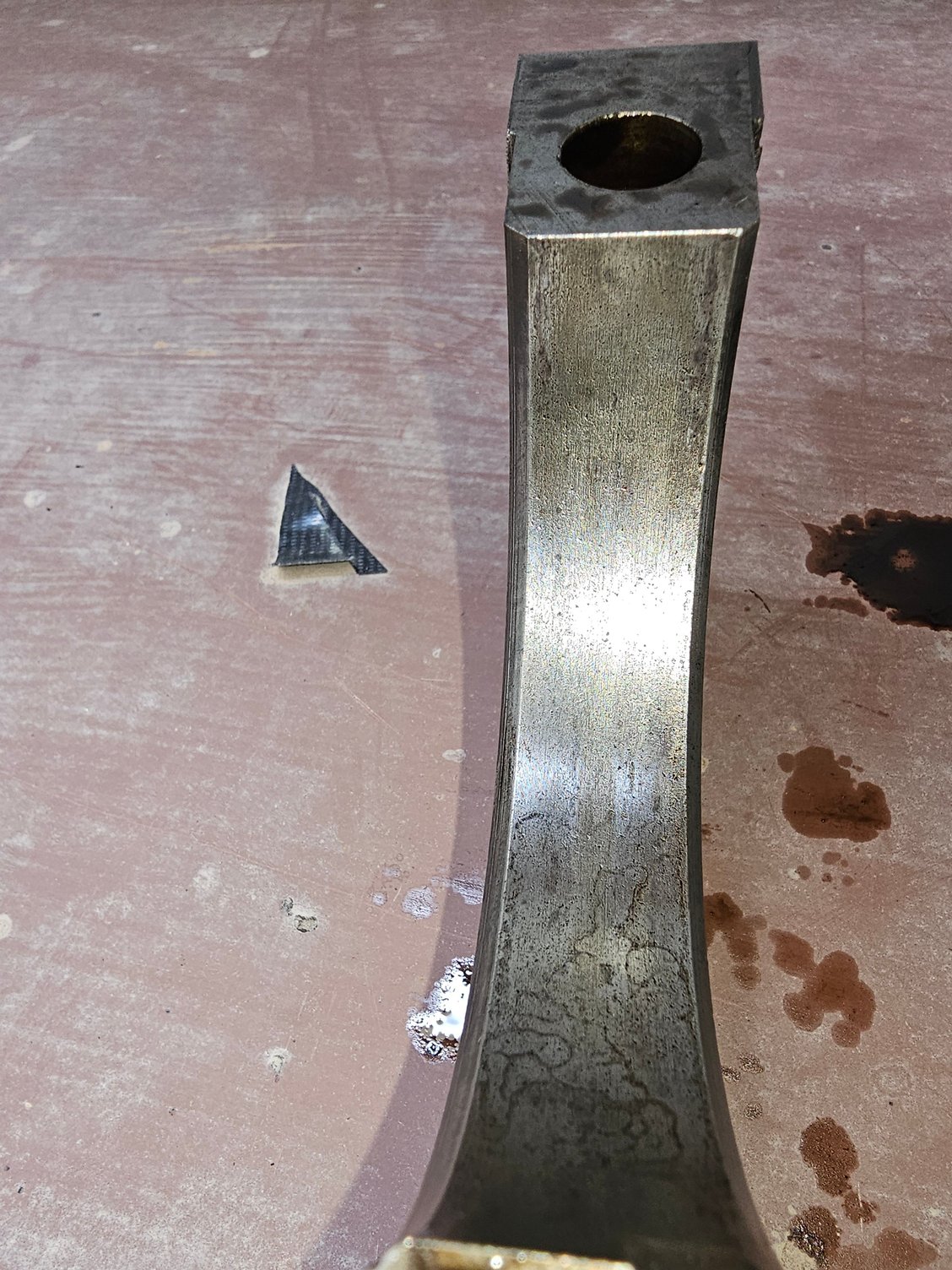

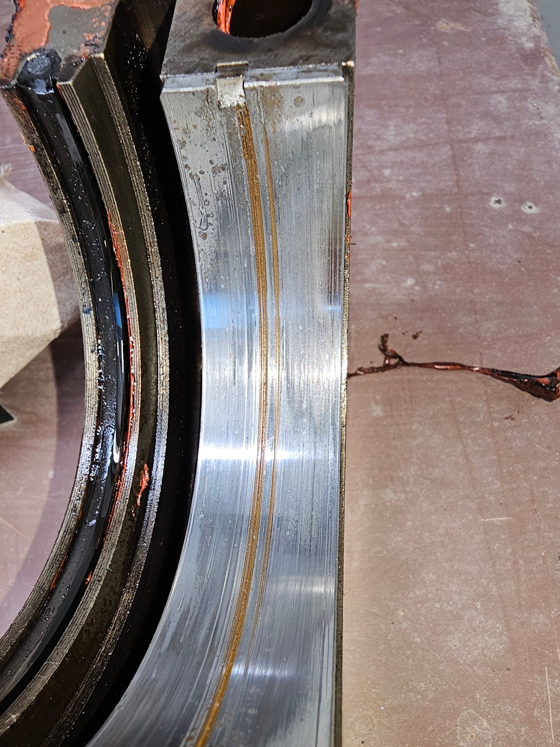

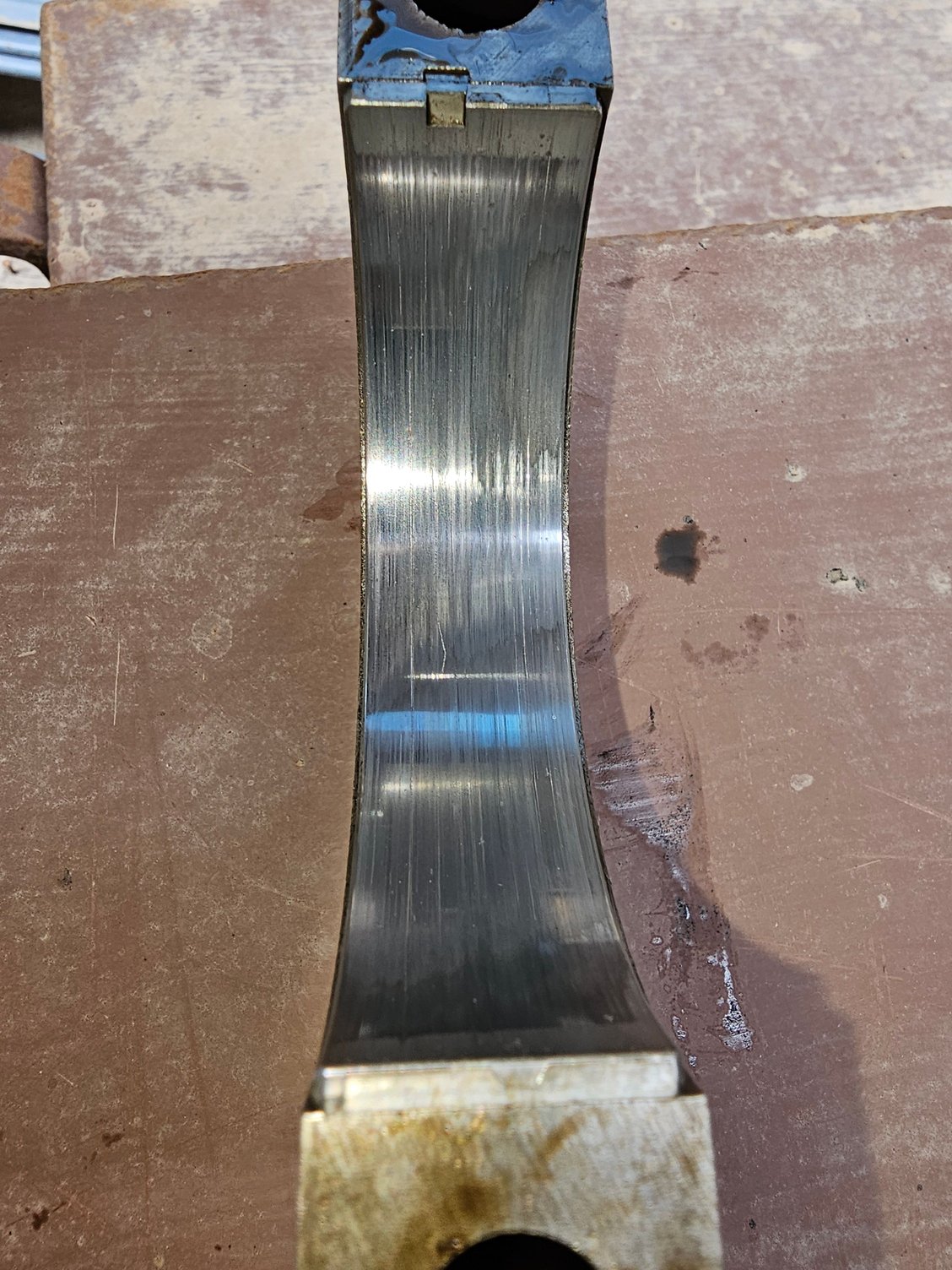

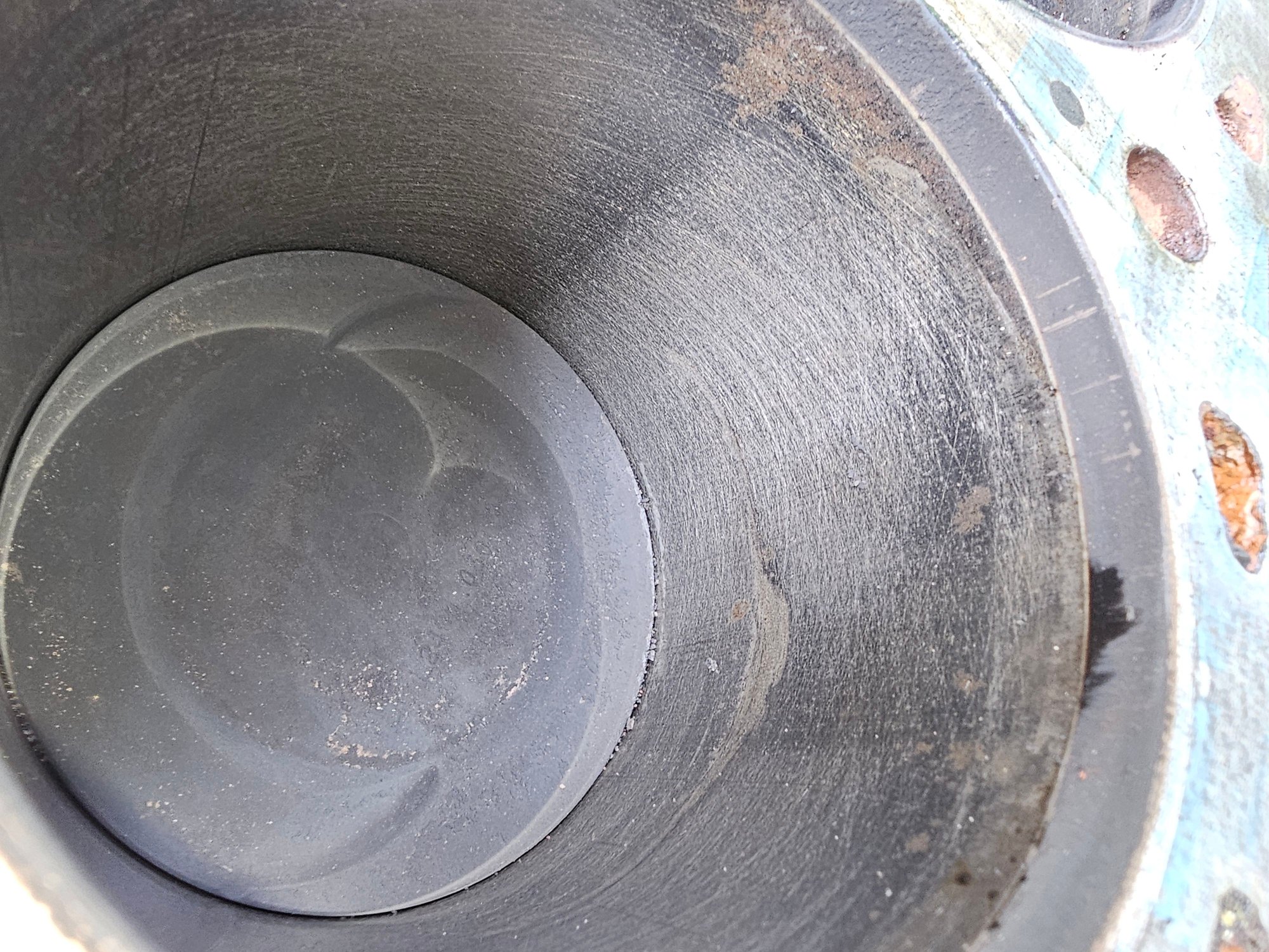

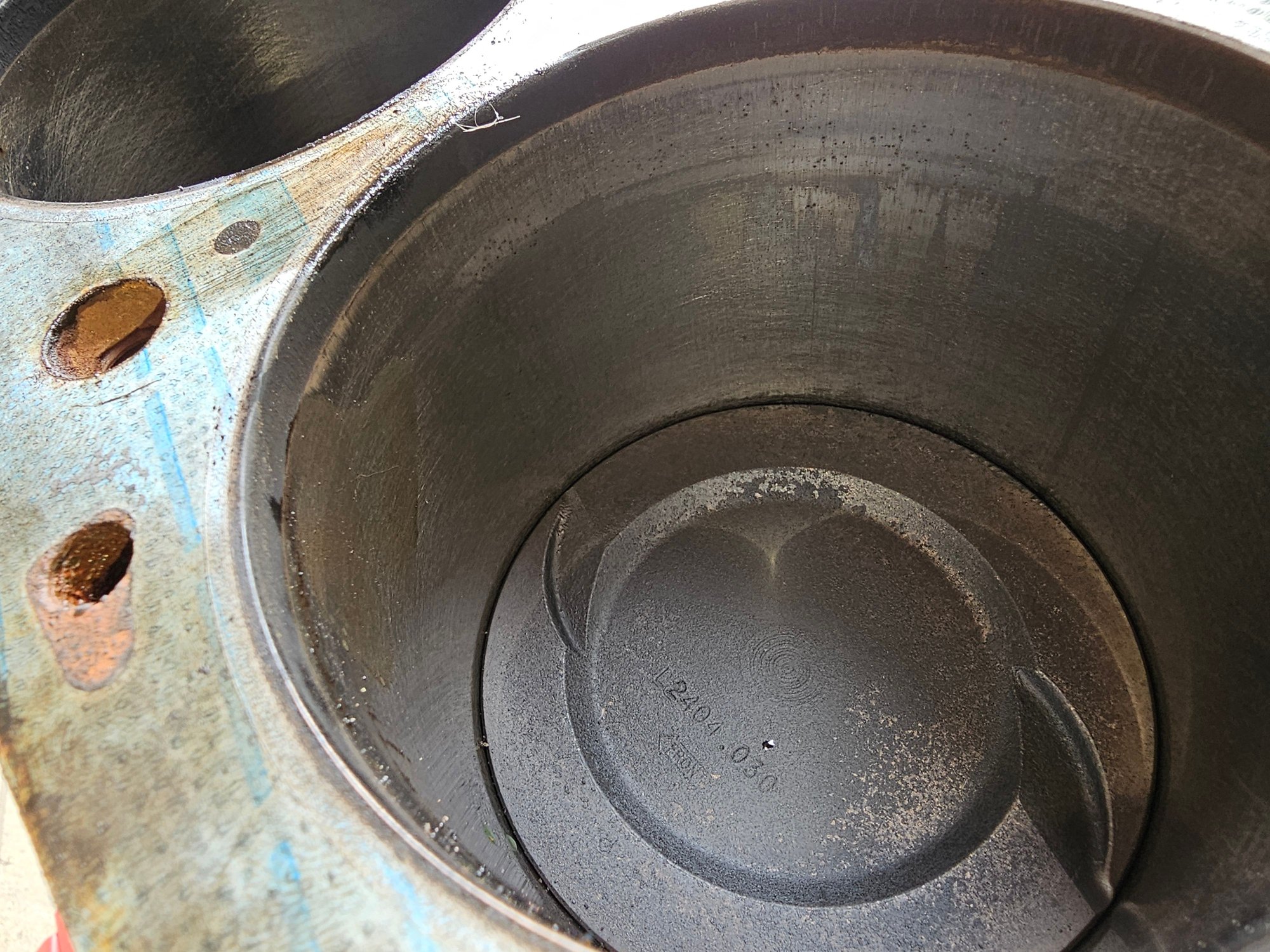

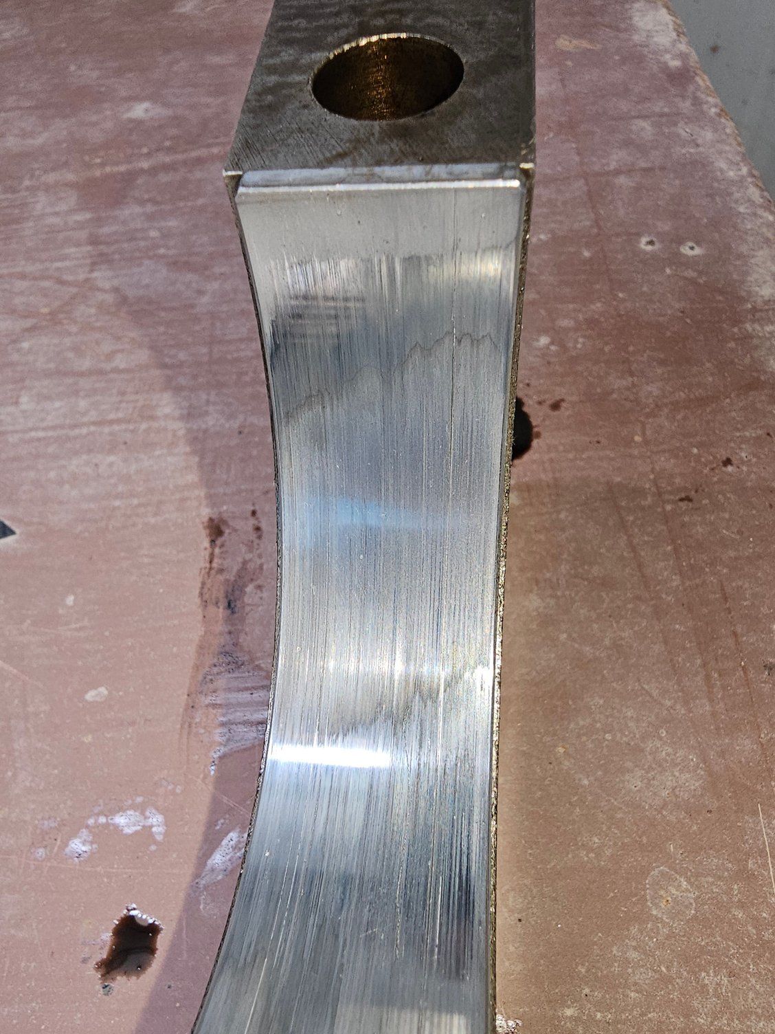

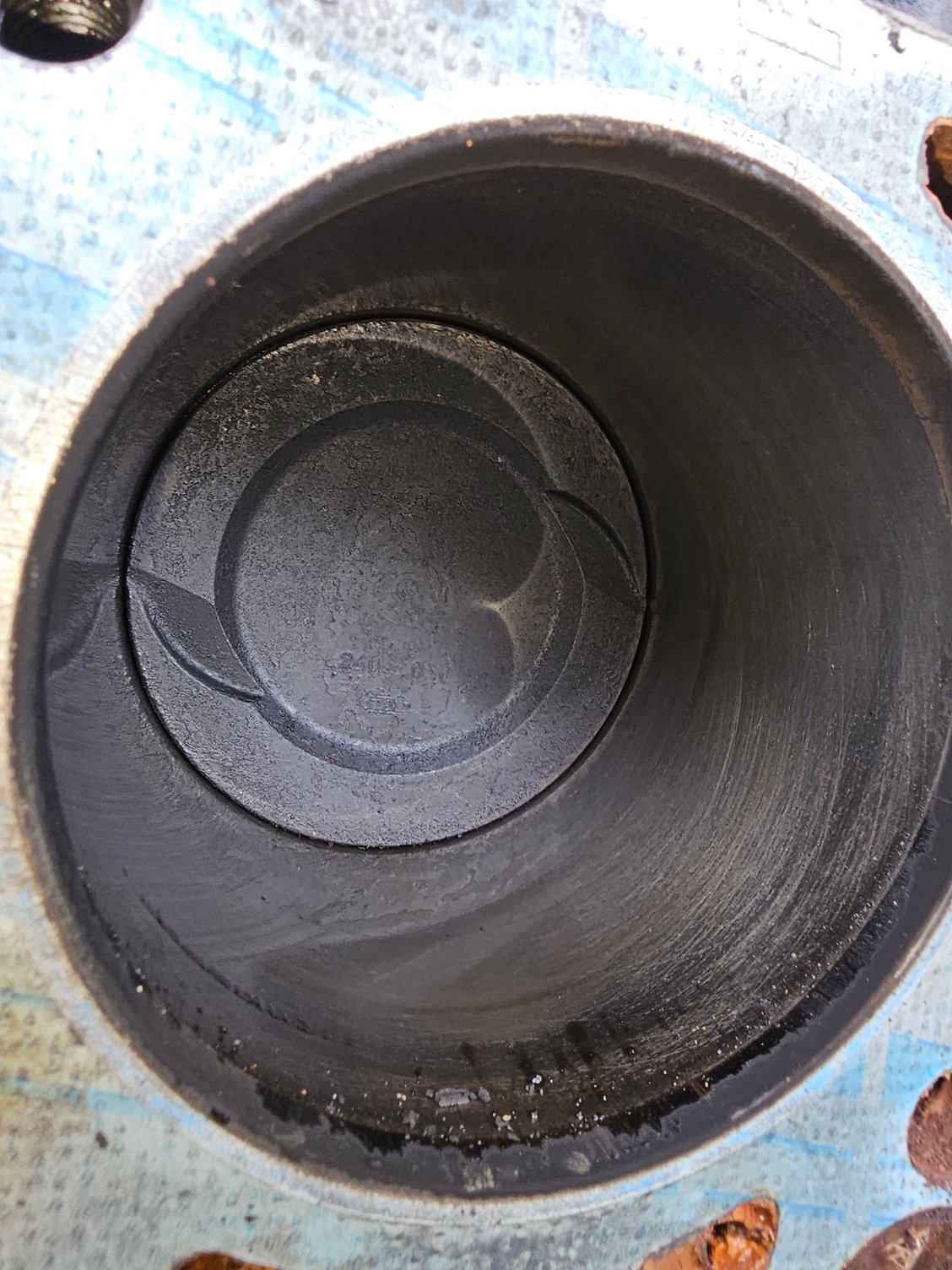

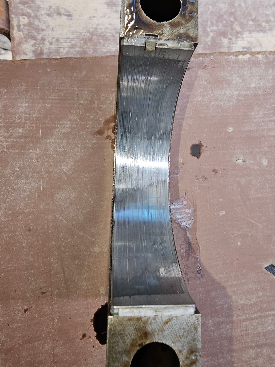

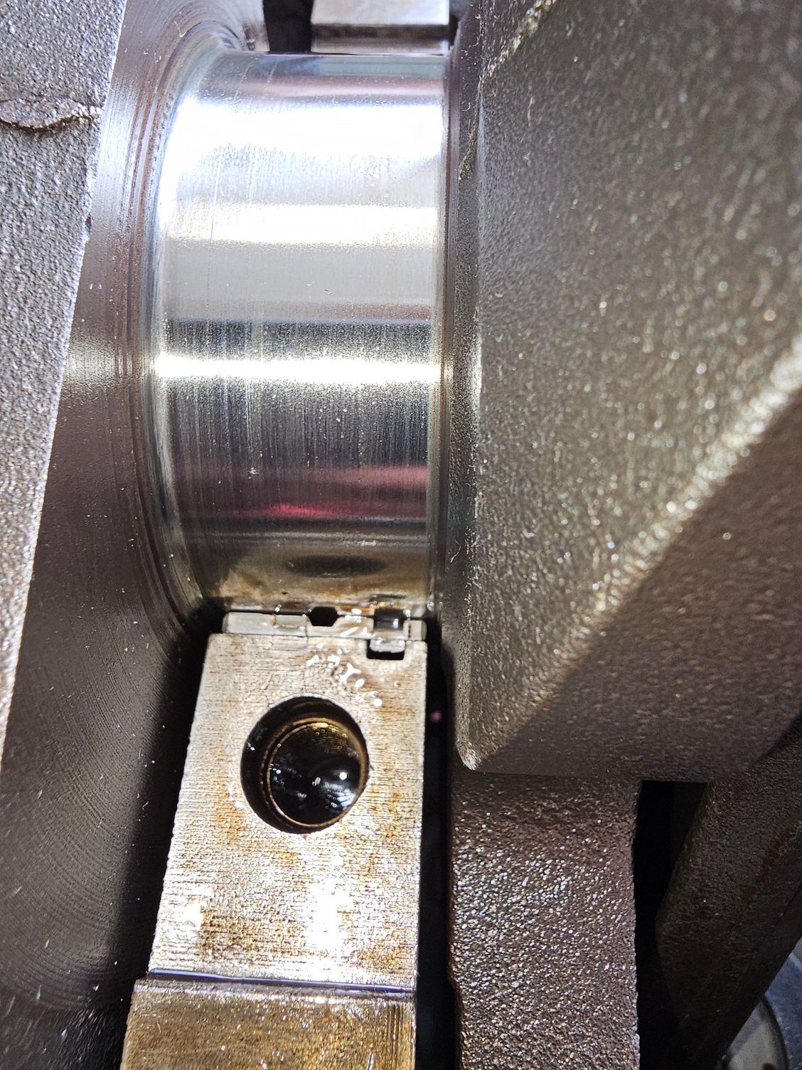

So, there pictures of all but 1 main cap, the front one. I also took at least 2 pictures of each cylinder the best I could. Most of the internal engine was pretty clean, maybe because of all the gas in the oil? The #3 main cap bearing didn't seem to have any numbers on the back, or a brand...that I could see anyways. Hope this helps you see what I am dealing with.
Also, when removing the heads, I sorted each push rod, rocker, and lifters together in seperate bags. When I was rolling the engine over on the stand, I forgot to remove the lifters, and about 4 fell out on the ground, so I have no idea with set they go with.
Thank you again

The motor was rebuilt at least once already and .030 oversize pistons installed. The degree of dirt and grit you've allowed to enter the interior of the motor makes a hot tank mandatory in my eyes. If you haven't kept the push rods, rockers, and lifters matched to the hole they came out of then you'll need to start at square one. I would finish stripping her and take what ever parts you want hot tanked with the block and then have it all measured to see where you're at with the core crank and block and go from there. If you're concerned about the costs then try to find a known good used motor and I bet there are some out there with good motors that would consider a trade for some labor hours of your welding and fabrication skills.

How can you determine it was bored .030"" by the pictures? Oh, nevermind, it's on top of the pistons Lol

There are some running .060 over in a stock 2 bolt main block, successfully. from what I'm seeing in the pics it will likely clean up at another .020 max, so .040 over pistons, which will make a good motor if you go that route.

For what you want it actually looks pretty good. the bores look okay, the bearings aren't real bad . you should find the size on the back of them. it's very clean inside and if there is a ridge it looks very minimal. hard to tell in pictures but I doubt this engine has had much use since the rebuild.
I would pull it all apart, hot tank it because the jackets look pretty loaded. put in new cam bearings and a full set of rods and mains. rings are probably okay but you'll know once you pull the pistons. if you kept the pushrods and rockers in order great, if you didn't don't worry about it just put them back in anyway they'll last as long as the rest of the engine no problem. done it many times. lifters should be replaced anyway, if the cam looks good run with it. look the crank over good and maybe polish it.
Your heads are important, pictures would give something to guess on, but I'd have a competent machinist take a look.
Don't get caught up in the " you must " garbage, you're not building a high dollar street rod you just want an engine that runs good and will last a while if I understand you correctly. unless your heads need major work, or you find something unseen in the rest of your teardown it looks to me like for under $500 you are going to have a decent engine. Overall if I were you, I'd be feeling pretty good about it.
