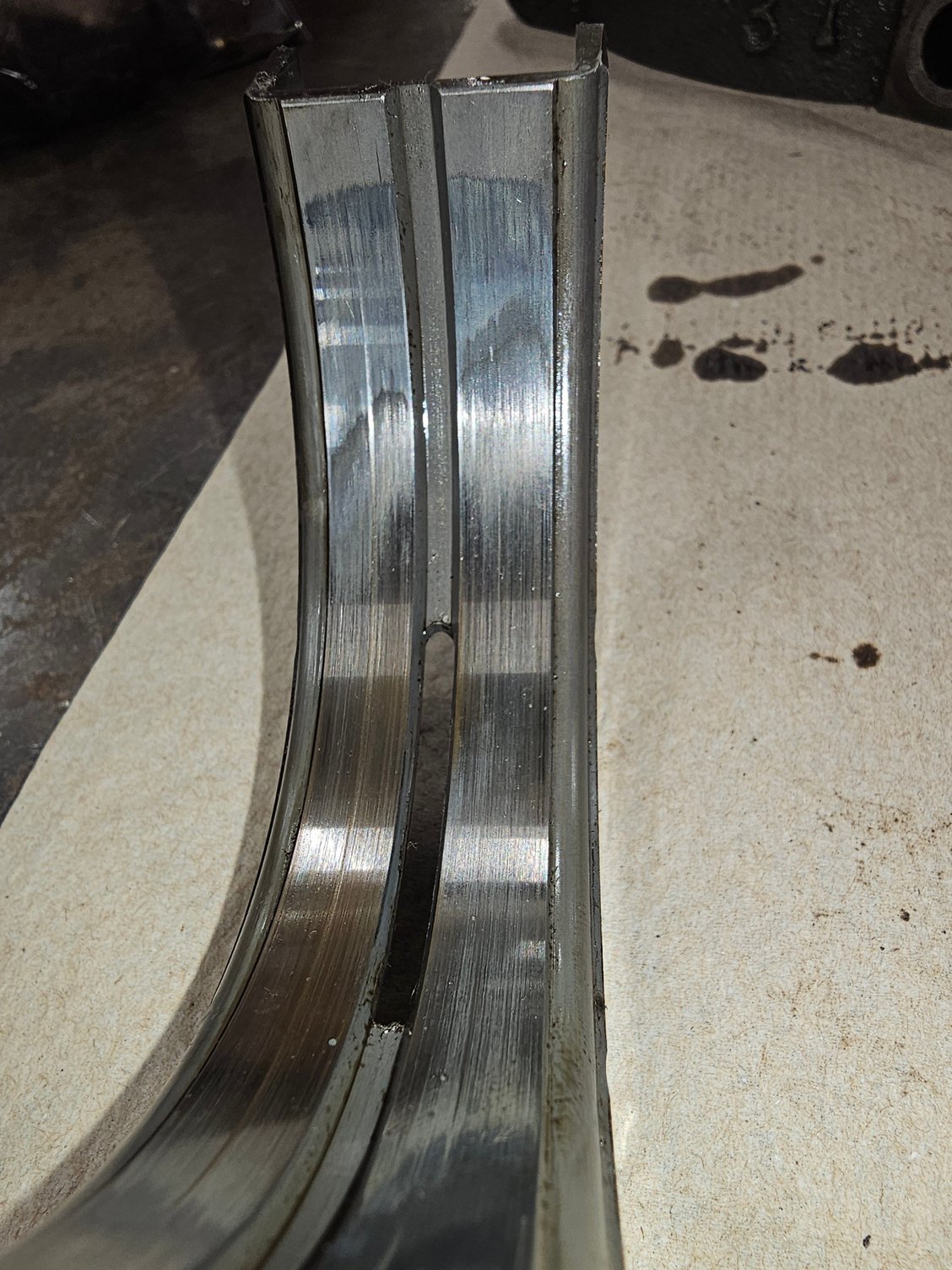

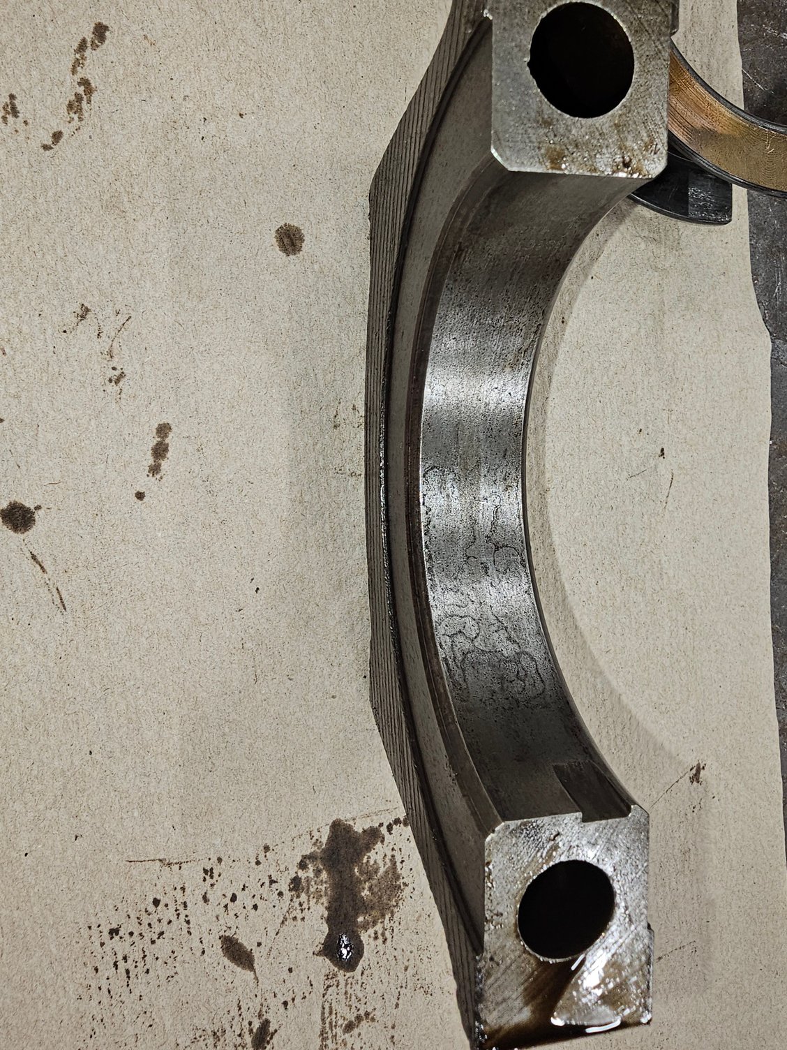

I don't care what anyone says, these bearings are toast. You're down into the copper on many of them, and right next to it on the others. The scoring and grooves tell me there's been junk floating around in the oil and infrequent oil/filter changes. At a minimum the crank needs polished and new bearings installed, but it would take a machinist to look at it and measure to know if it needs turned and undersized bearings used. There should be numbers on the back side of the bearings that will tell you what was done at the last rebuild, similar to the numbers on your piston tops.
Same with the block, you'd need to measure the bores to know if your pistons can be reused with a fresh power hone and new rings. Ford's thinwall block castings were never intended to go much beyond .030/.040max on a rebuild. IMHO, if you've got that much debris in your bearings, you've got that same debris still in your oil passages, and this engine needs to be hot tanked and a full rebuild done. It won't last long at all if you slap it back together, as is.

Yes the bearings need replaced. no they're not terrible. the scoring is minimal. the crank is probably okay but it would be a good idea to get it checked, maybe something is worse than it looks in the pictures. UNLESS you really don't want to, and in that case toss in new bearings and forget it.
bores look good. from the hone marks and the lack of any significant ridge you can tell they have little wear.
The other factor is the goal in mind. it's not a high dollar build, he wants to keep it cheap. it's not a high-performance build. and it's not the intent to get 100,000 miles out of it.
I've done plenty of " just make it run " rebuilds on spud trucks and farm pickups and I can assure you I've slapped much worse cases than this together with nothing more than minimal expense and they did their job just fine for years. some are still going. it's easy to get caught up in the quest for perfection, I do it too. but that isn't for everyone. if the OP wants to spend 4-5 k on this I have lots of suggestions.

Personally I would definitely have the crankshaft measured with a micrometer, preferably by someone used to doing this. If it needs ground, I would guess a couple hundred dollars. The bearing cost would be about the same for undersize bearings if the crank needs turned.
